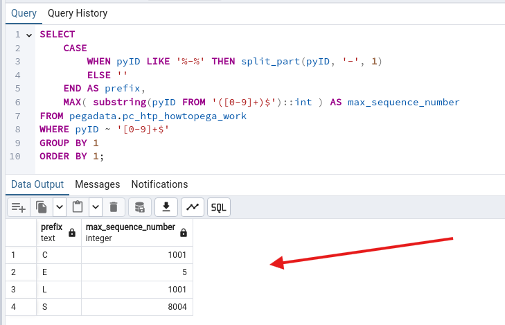

Option 1: Run a database query
You must first query the database to find the maximum numeric part of the Case IDs for the affected work pool. This is not in Pega documentation. The documentation focuses on using Pega activities and methods rather than direct database queries, but it is an easy way to check for all `Sequence Number` at once.
The Case ID format is typically `[Prefix]-[Sequence Number]`. The query must extract the sequence number and find the maximum value.
SELECT
CASE
WHEN pyID LIKE '%-%' THEN split_part(pyID, '-', 1)
ELSE ''
END AS prefix,
MAX( substring(pyID FROM '([0-9]+)$')::int ) AS max_sequence_number
FROM your_schema.pc_your_work_table -- e.g., pegadata.pc_htp_howtopega_work
WHERE pyID ~ '[0-9]+$'
GROUP BY 1
ORDER BY 1;
- your_schema.pc_your_work_table: Replace with the actual schema and the specific work table (e.g., `pegadata.pc_htp_howtopega_work`) for the case type in question.
- Safety Margin: Once you have the max_sequence_number (e.g., `25000`), choose a new reserved number with a significant buffer (e.g., `30000`). This buffer accounts for any in-flight cases and the batch size of the ID generation mechanism.

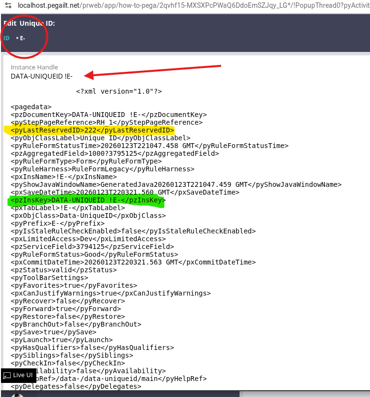

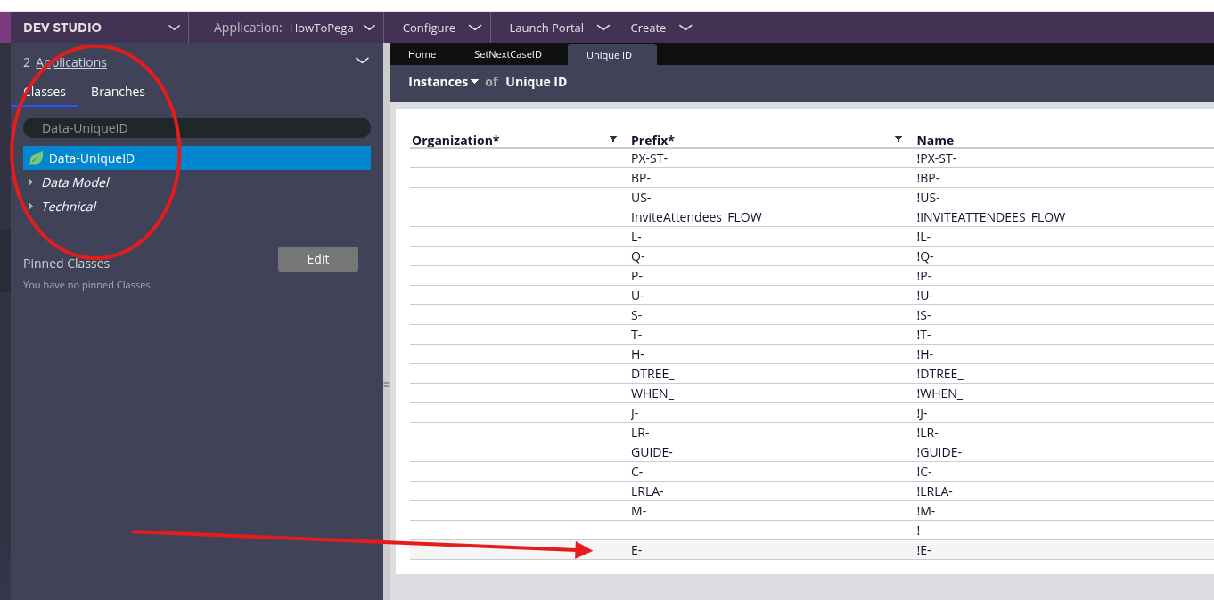

Option 2: Viewing Data-UniqueID Instances in Dev Studio
Another way to check the current pyLastReservedID value is to navigate directly to the Data-UniqueID class instances in Dev Studio:
Access App Explorer: In Dev Studio, navigate to App → Classes → `Data-UniqueID`. Select the Data-UniqueID class to view all instances.
Find Your Case Type Prefix: Locate the instance corresponding to your case type prefix (in this case, 'E-'). Each prefix has its own Data-UniqueID instance.
Open the Instance: Click on the instance to open it and view its properties.
Check the `pyLastReservedID` Value: In the instance details, locate the `pyLastReservedID` property. This displays the current reserved number for that case type prefix.

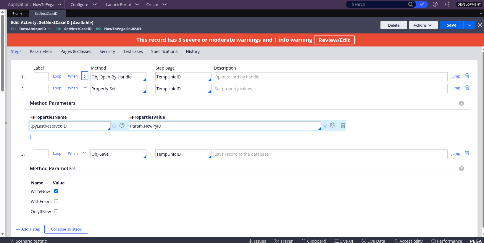

Step 2: Update the `Data-UniqueID` Instance via Pega Activity
Direct database manipulation of the `pr_data_uniqueid` table is strongly discouraged, especially in Pega Cloud environments. The safest and supported method is to use a Pega Activity to update the `pyLastReservedID` property.

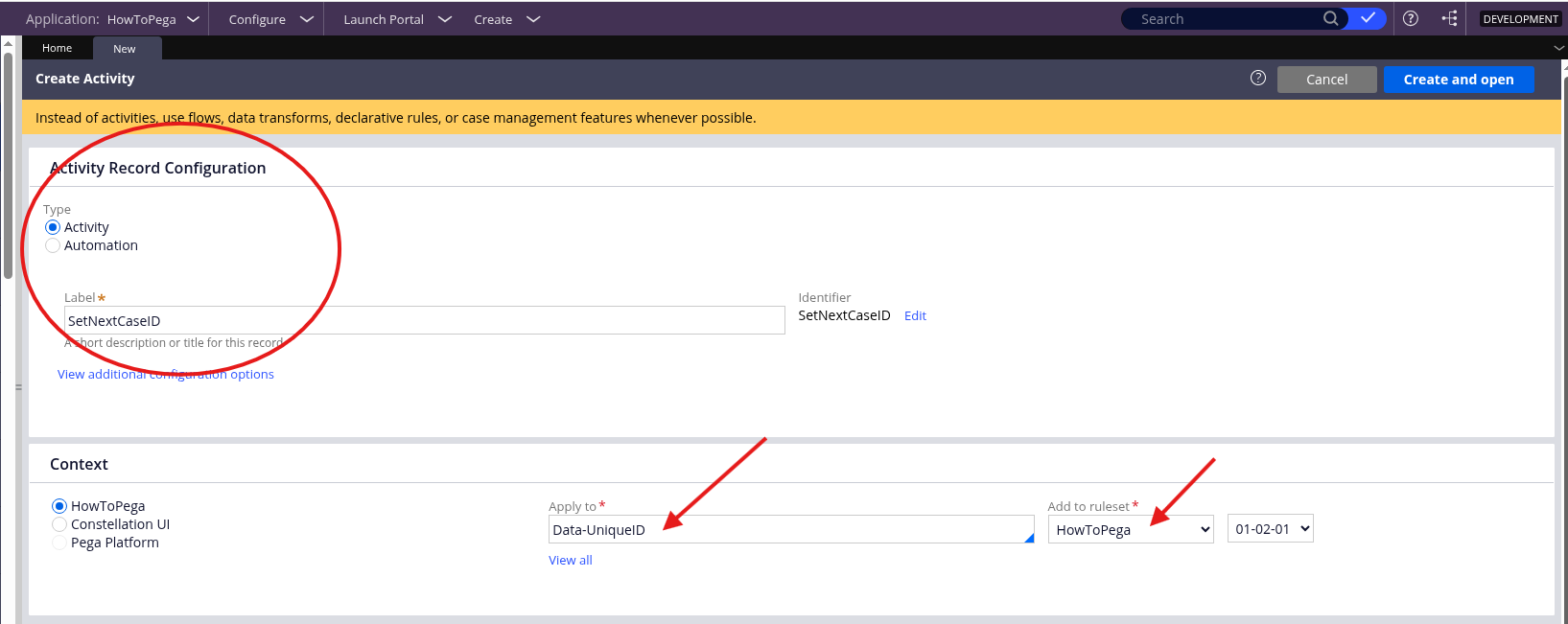

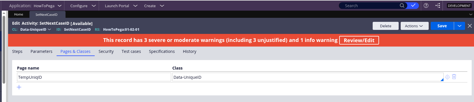

1. Create a Activity: In Dev Studio, Create → Technical → Activity in your application's ruleset, using the `Data-UniqueID` class.
2. Configure the Activity
2.1 Add a Parameters:
2.2 Add Pages and classes:
2.3 Add Steps:

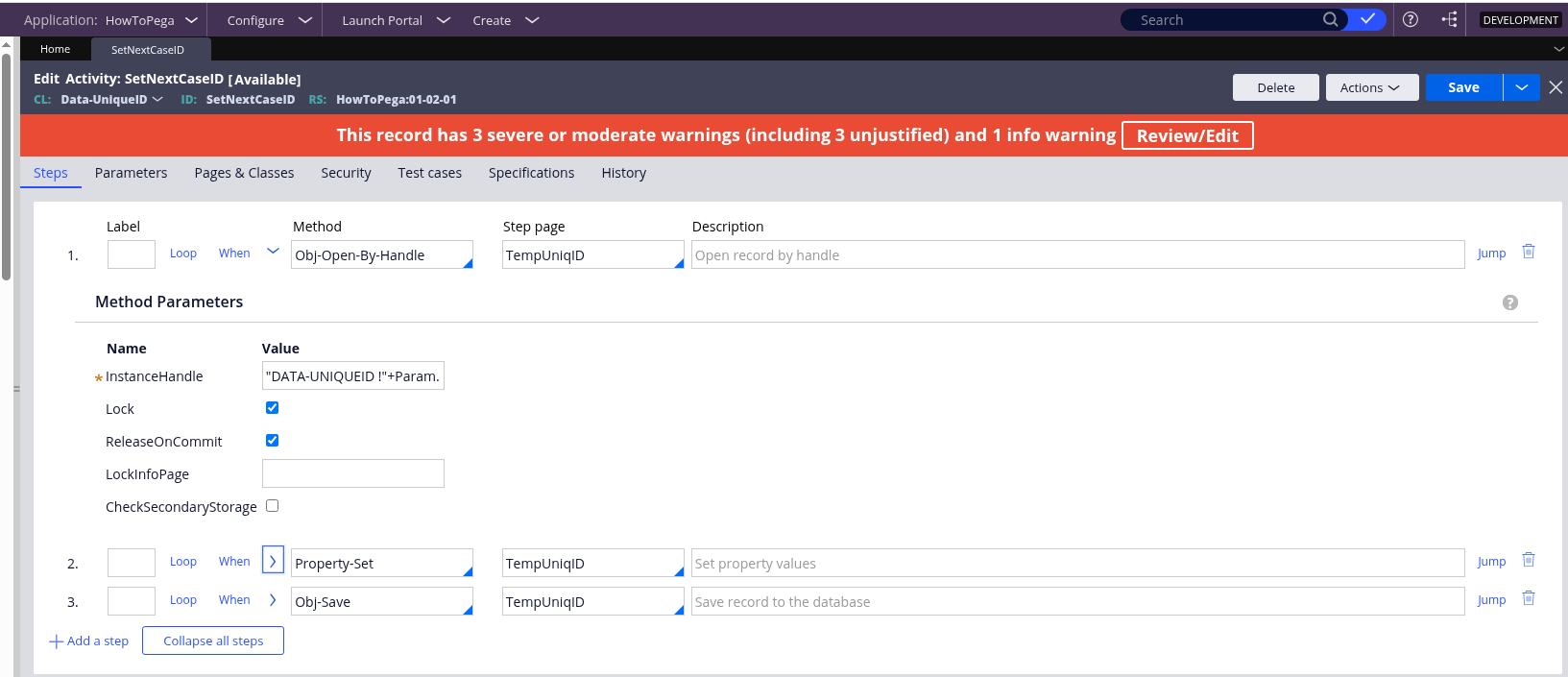

Step 1:
- Method: Obj-Open-By-Handle
- Step page: TempUniqID
- InstanceHandle: "DATA-UNIQUEID !"+Param.InsKeyPrefix
Step 2:
- Method: Property-Set
- PropertiesName: .pyLastReservedID
- PropertiesValue: Param.NewPyID
Step 3:
- Method: Obj-Save
- WriteNow: true

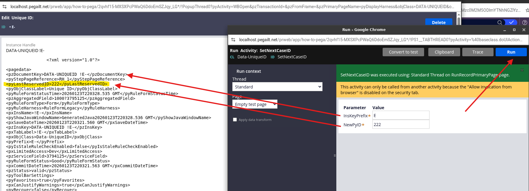

3. Run the Activity: Run the activity once in your target environment after the data migration
Step 3: Post-Update System Actions
After the `Data-UniqueID` instance is updated, the change must be propagated across all nodes in the cluster.
1. Restart Application Servers: It is a best practice to restart all Pega application servers in the cluster. This ensures that all nodes clear their in-memory cache of the reserved ID and pick up the new, higher `pyLastReservedID` from the database upon startup.
2. Verify Case Creation: Create a new case of the affected type. The latest Case ID should start from the number you set (e.g., `MYAPP-30001`) or higher, depending on the batch size.
