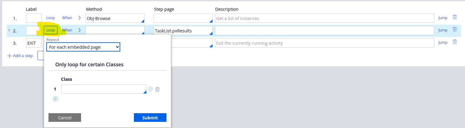

Step 2: Configure the Loop
- Set the loop option to 'For each embedded page'
