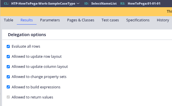

Step 2: Configure the Results Tab
On the results tab within the rule, select the 'Evaluate all rows' checkbox.

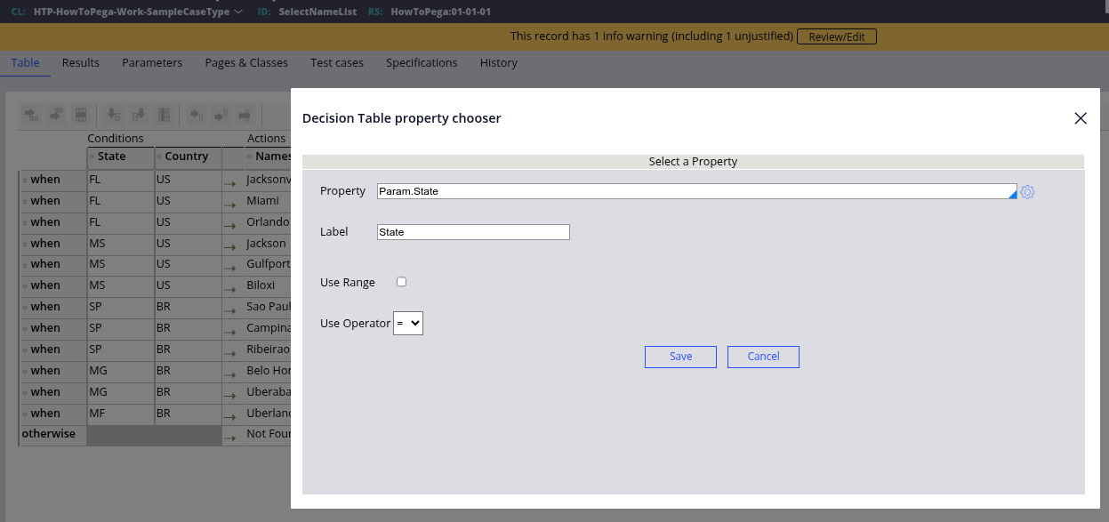

Step 3: Set Up Comparison Columns
Populate your table with the columns that will be used for comparison. In this example, we're using State and Country.
Step 4: Configure the Actions Column
In the 'Actions' column, set the property with '.NamesList()' and use the operator '='.

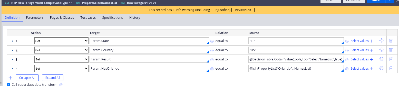

Step 5: Test the Rule
To test this rule, create a Data Transform and call the Decision Table:
@DecisionTable.ObtainValue(tools,Top,"SelectNameList",true)

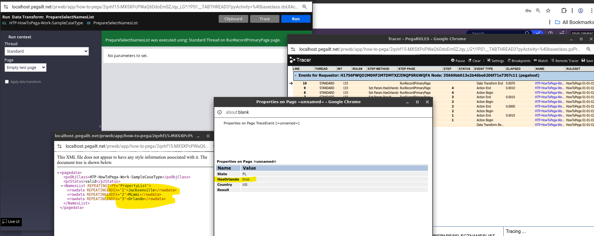

Step 6: Verify the Results
You can verify the results by checking the tracer or by using the 'IsInPropertyList' function:
@IsInPropertyList("Orlando", .NamesList)
