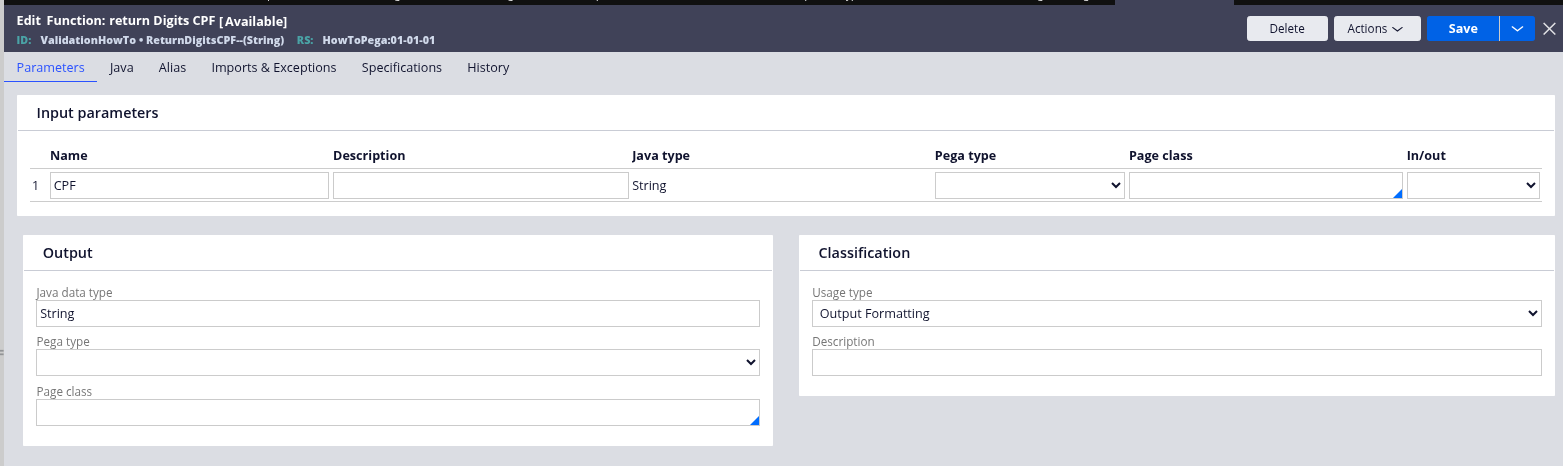

Create a function in the library you just created and select it for use.
2.1 - In the Input Parameters
Add the following parameter:
- Name: CPF
- Java type: String

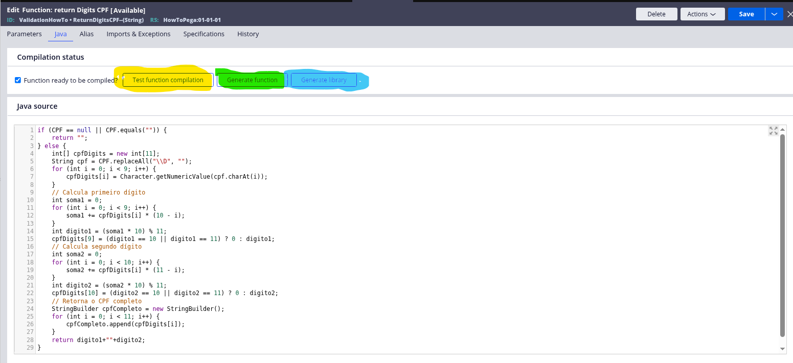

2.2 - Add the Following Java Code in the 'Java' Tab

2.3 - Press the Buttons Above the Code in the Order They Are Presented
The buttons perform operations like syntax checking, compilation, and saving in a specific sequence that ensures your code is properly validated and integrated into the system.

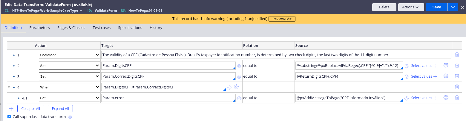

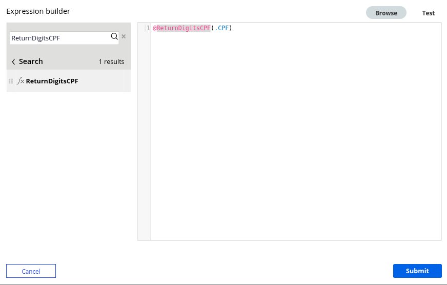

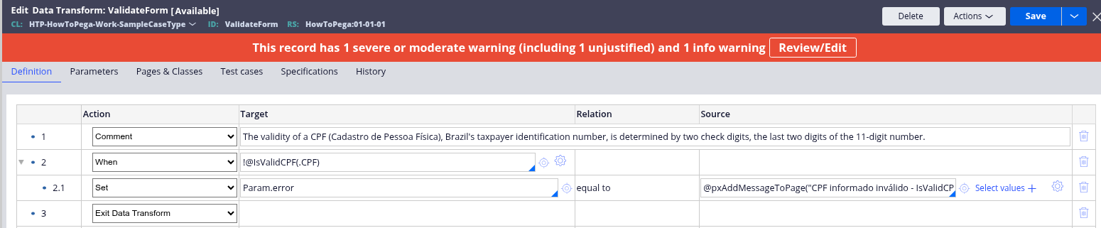

Step 3: Create a Data Transform to Validate the Information
Note: Use the function you just created by clicking on the gear icon and searching in the Expression builder.

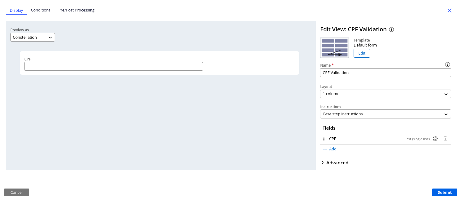

Step 4: Add the Field You Are Going to Validate in the View
The view is where users will input the CPF number, so adding a dedicated field ensures proper data collection and provides a clear interface element for users to enter their information.

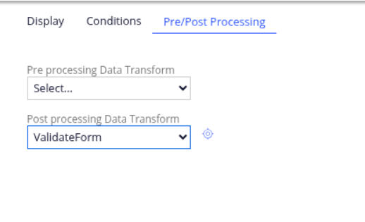

Step 5: Go to Pre/Post Processing Tab and Select the Data Transform
Select the Data Transform you created in the select option for the Post processing.
Note: Post processing allows you to automatically validate the CPF immediately after the user enters it, providing real-time feedback without requiring additional user actions like clicking a validation button.

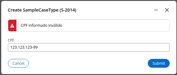

Step 6: Validate Your Work
Why test your implementation? Testing ensures that your CPF validation works correctly for both valid and invalid CPF numbers, confirming that your implementation meets the requirements and provides the expected user experience.

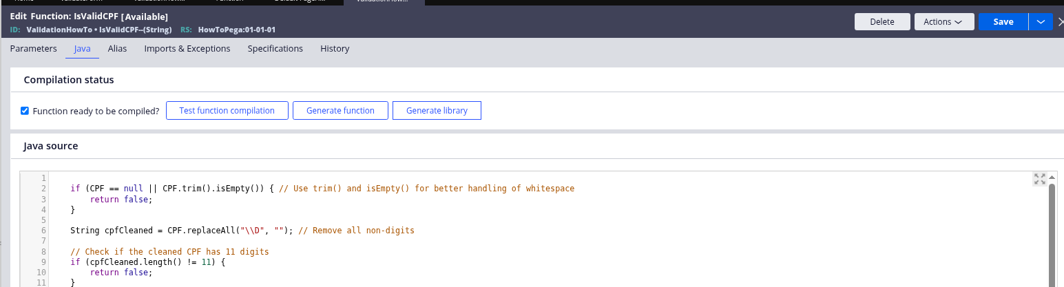

After my post, I made some changes to the function.

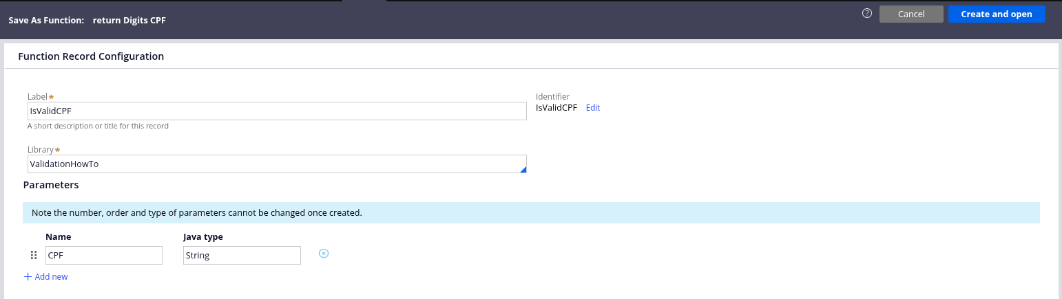

1 – I created a new function based on the first one, but this time it is called IsValidCPF and returns a Boolean value.
2 – I added the Java code below:
''' if (CPF == null || CPF.trim().isEmpty()) { // Use trim() and isEmpty() for better handling of whitespace return false; } String cpfCleaned = CPF.replaceAll("\\D", ""); // Remove all non-digits // Check if the cleaned CPF has 11 digits if (cpfCleaned.length() != 11) { return false; } // Check for common patterns of invalid CPFs (all digits are the same) // This is a common shortcut for invalid CPFs, but not strictly part of the algorithm itself. if (cpfCleaned.matches("(\\d)\\1{10}")) { return false; } int[] cpfDigits = new int[11]; for (int i = 0; i < 11; i++) { cpfDigits[i] = Character.getNumericValue(cpfCleaned.charAt(i)); } // Calculate first verification digit int soma1 = 0; for (int i = 0; i < 9; i++) { soma1 += cpfDigits[i] * (10 - i); } int digito1Calculated = (soma1 * 10) % 11; if (digito1Calculated == 10 || digito1Calculated == 11) { digito1Calculated = 0; } // Calculate second verification digit int soma2 = 0; for (int i = 0; i < 10; i++) { soma2 += cpfDigits[i] * (11 - i); } int digito2Calculated = (soma2 * 10) % 11; if (digito2Calculated == 10 || digito2Calculated == 11) { digito2Calculated = 0; } // Compare calculated digits with the actual last two digits of the input CPF return (digito1Calculated == cpfDigits[9] && digito2Calculated == cpfDigits[10]); '''

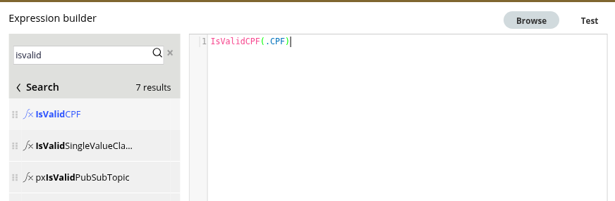

3 – After testing and generating, the function can be found in the Expression builder.
4 – To use it, just call it in the data transform in a when action.

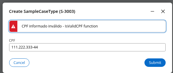

5 – Here is the test of the new function:
NOTE: Remember this is just an improvement of the previous function that returned the digits.
