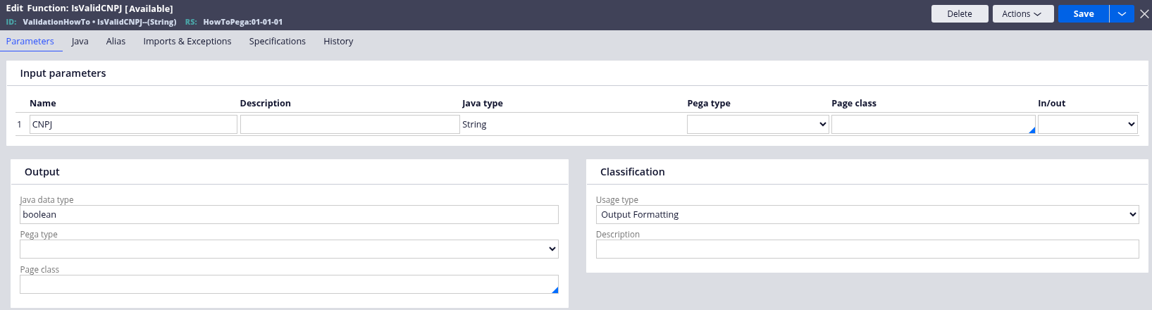

Step 2: Create a function named 'IsValidCNPJ'
Create a function named 'IsValidCNPJ' to return 'true' or 'false' based on the CNPJ provided, and select the library you just created.
WHY use a boolean return type? A simple true/false response provides clear, unambiguous validation results that can be easily integrated into conditional logic, data transforms, and user interface validation feedback mechanisms.
Step 2.1: Configure Input Parameters
In the Input parameters, add
- Name: CNPJ - Java type: String
Although CNPJ contains only digits, using String type accommodates formatted input (with dots, slashes, and hyphens) and prevents issues with leading zeros that could be lost with numeric types.

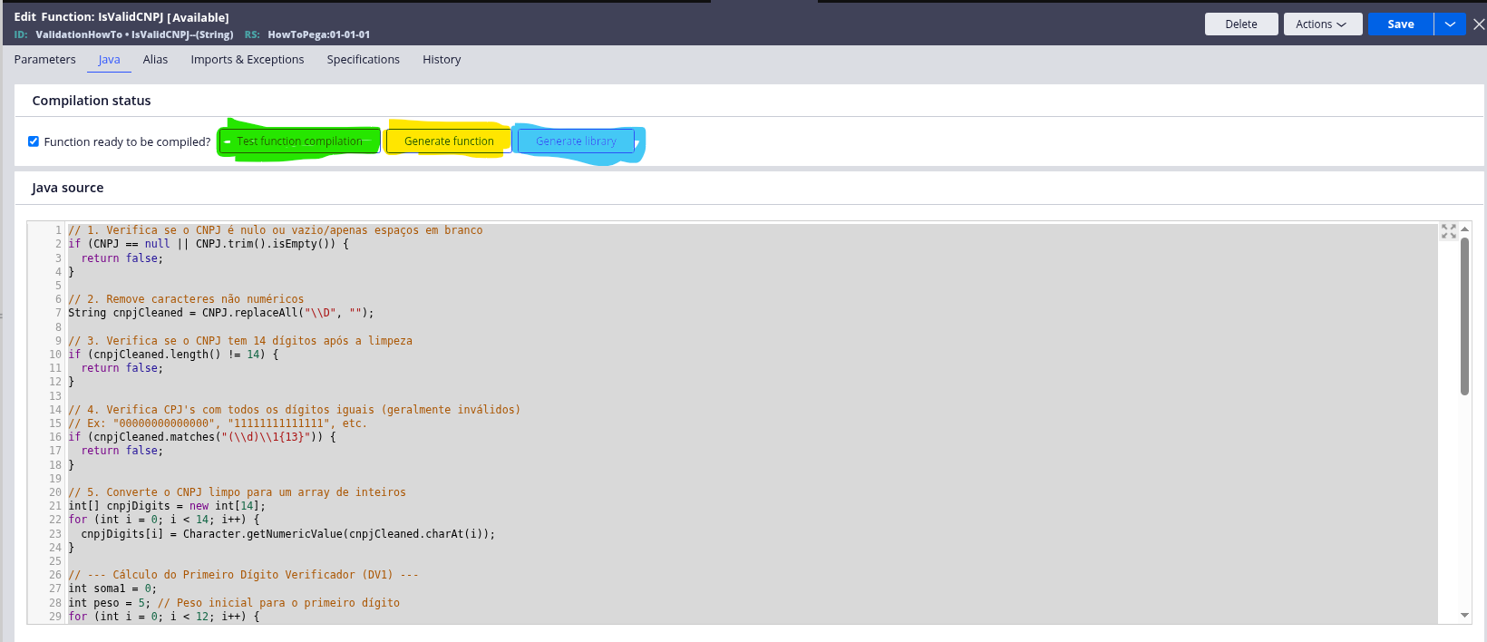

Step 2.2: Add the Java validation code
Add the following Java code in the 'Java' tab:

Step 2.3: Process the code
Press the buttons above the code in the order they are presented to compile and validate the function. Pega's development environment requires specific compilation steps to properly validate syntax, resolve dependencies, and integrate the function into the platform's runtime environment.

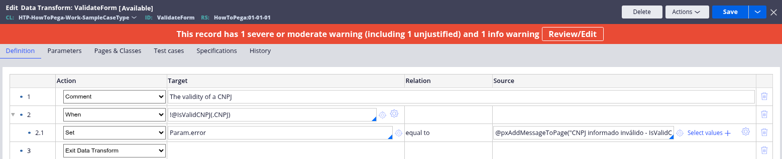

Step 3: Create a Data Transform to validate the information
Create a Data Transform to validate the information using the function you just created by clicking the gear icon and searching in the Expression builder.

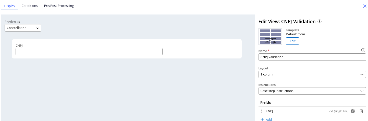

Step 4: Add the field you are going to validate in the view
Add the CNPJ field that requires validation to your user interface view.

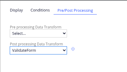

Step 5: Configure Post Processing
Navigate to the Pre/Post Processing tab and select the Data Transform in the Post processing option.
