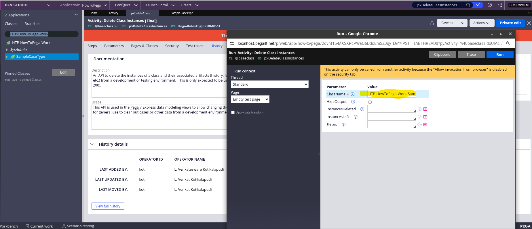

Removing instances
1 - The instances to be removed.
2 - Run the activity
3 - Check the summary
4 - Check is the instances get removed.
