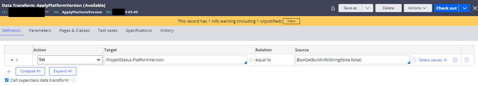

1. Create a Data Transform
First, create a data transform specifically for retrieving the platform version:
1. In Dev Studio, navigate to Create > Technical > Data Transform
2. Name the data transform ApplyPlatformVersion
3. Configure the data transform to set your target property with the platform version
2. Use the pxGetBuildInfoString Function
Within the data transform, use the pxGetBuildInfoString function to retrieve the platform version:
@pxGetBuildInfoString(false,false)
This function returns information about the Pega Platform build. The parameters (both set to false in this example) control the format and detail level of the returned information.
