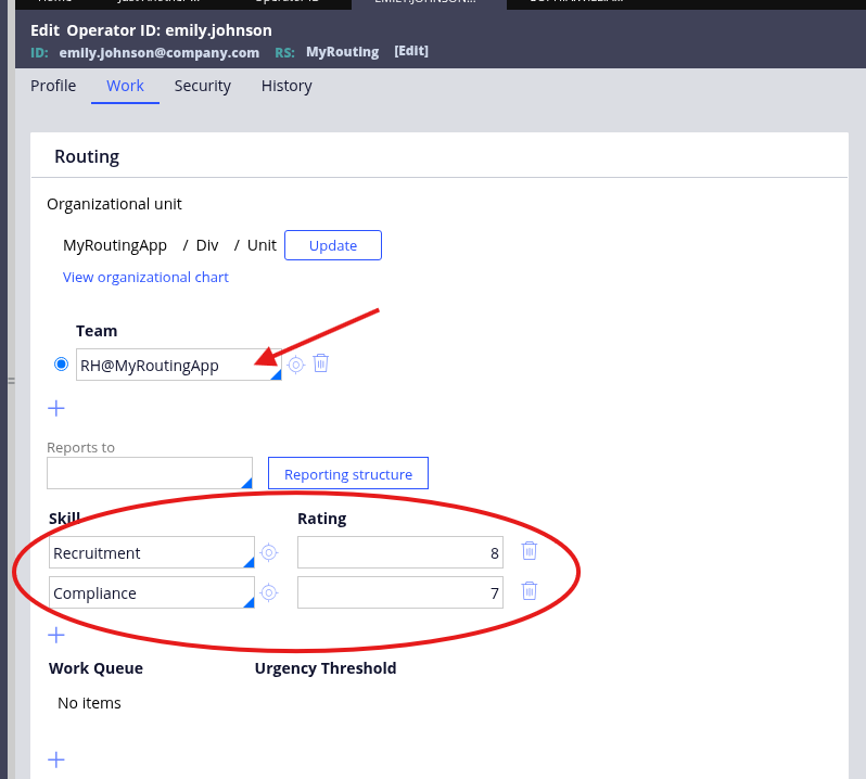

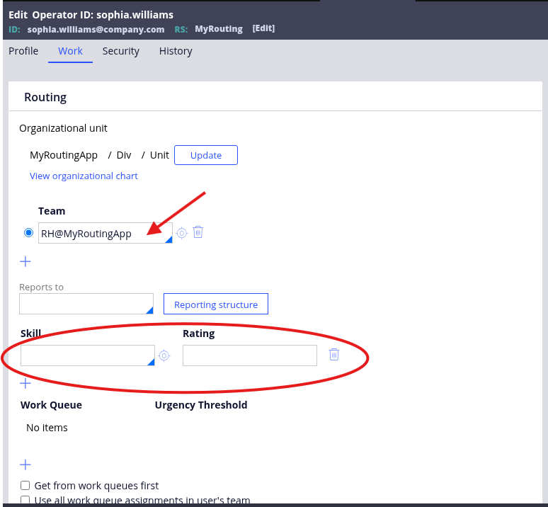

Operator Configurations
Operators are the individuals who perform the work. Their profiles must be configured with their relevant skills, proficiency levels, and team structure. The proficiency level is a crucial integer value (typically 1-10) that quantifies an operator's expertise in a given skill.

Emily Johnson |
emily.johnson |
Proprietary information hidden |
HR Specialist |
MyRouting:RH |
Recruitment (8), Compliance (7) |
RH@MyRoutingApp |
Sophia Williams |
sophia.williams |
HR Specialist |
MyRouting:RH |
No skill listed |
RH@MyRoutingApp |

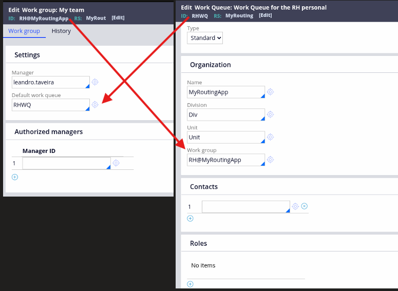

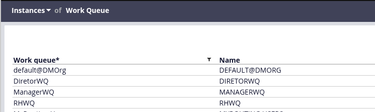

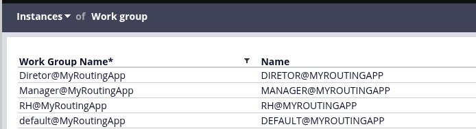

Work Groups and Work Queues
Work Groups represent teams or organizational units, while Work Queues (often referred to as Workbaskets in older Pega versions) are shared backlogs where assignments are pooled for a team to pick up.
- Work Groups:
RH@MyRoutingApp,Manager@MyRoutingApp,Diretor@MyRoutingApp. - Work Queues:
RHWQ,ManagerWQ,DiretorWQ.
In this example implementation, each Work Group is associated with its corresponding Work Queue in a one-to-one relationship: RH@MyRoutingApp routes to RHWQ, Manager@MyRoutingApp routes to ManagerWQ, and Diretor@MyRoutingApp routes to DiretorWQ. This straightforward mapping simplifies the routing configuration and makes it easy to trace assignments through the system. Note that Pega supports more complex configurations where multiple Work Groups can share a single Work Queue, or where a Work Group routes to multiple queues based on business rules, but for clarity and simplicity, this tutorial uses a one-to-one mapping.

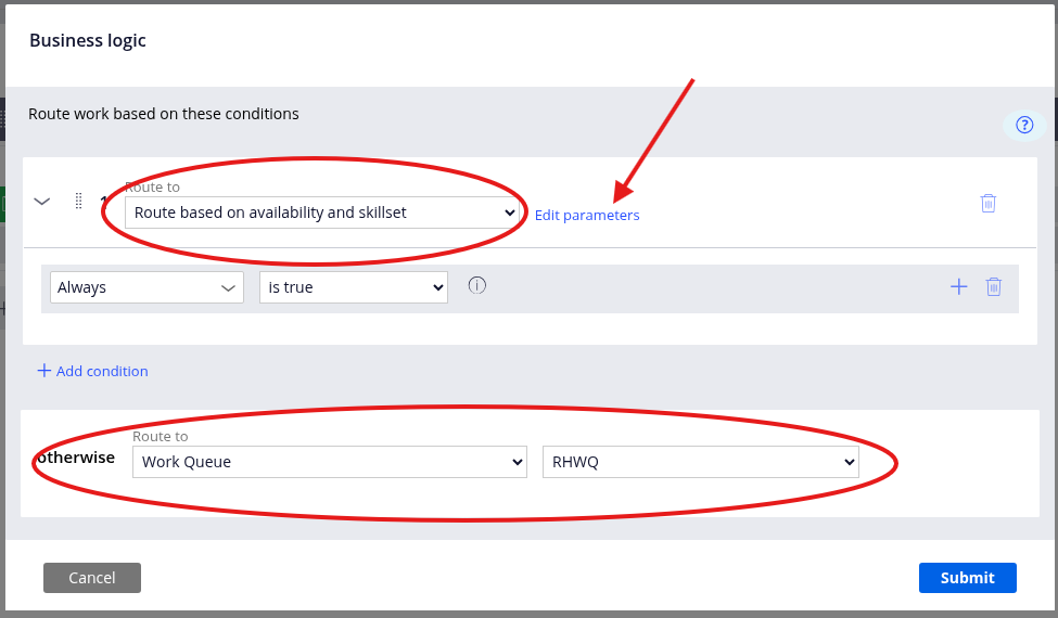

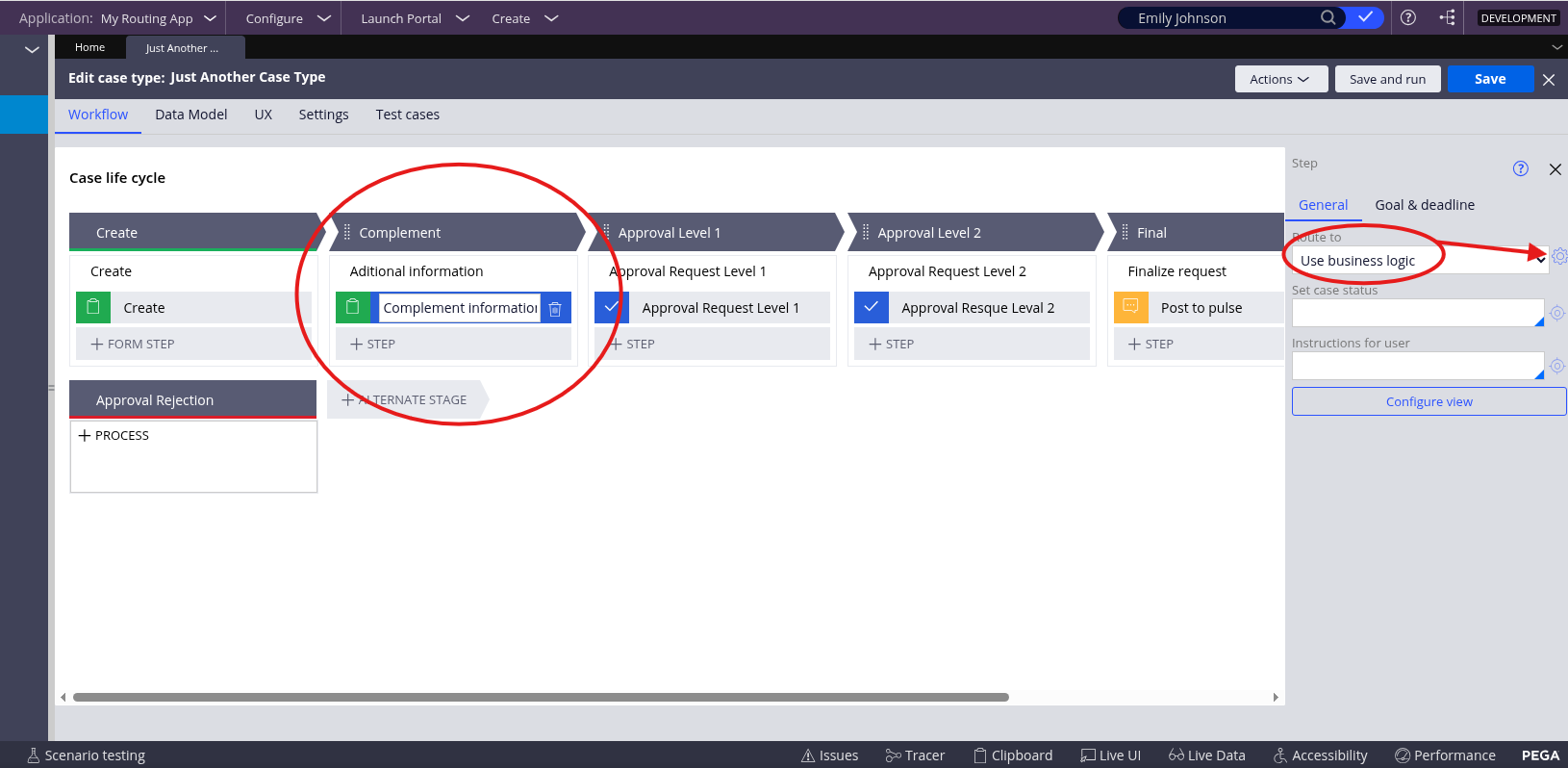

- Select the Step: In the case type, select the assignment step (e.g., "Complement information").
- Choose Business Logic: Set the Route to field to Use business logic.

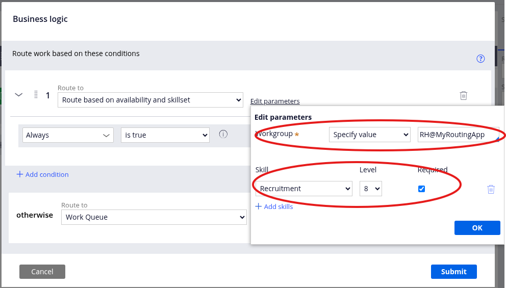

- Define the Logic: Click on the Gear icon and set the logic to Route based on availability and skillset. This leverages the out-of-the-box routing activity, typically a variant of
ToSkilledWorkbasketor a similar modern configuration. - Set Parameters: Specify the target
Work group(RH@MyRoutingApp) and the requiredSkill("Recruitment" with a level of 8). The "Required" checkbox must be selected. - Add a Fallback: Set the
otherwisecondition to route to a designated work queue (e.g.,RHWQ). This is a crucial best practice to prevent tasks from getting stuck if no operator is available or meets the criteria.

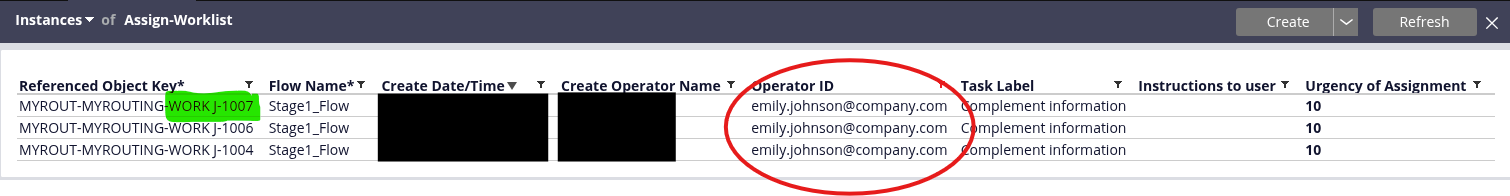

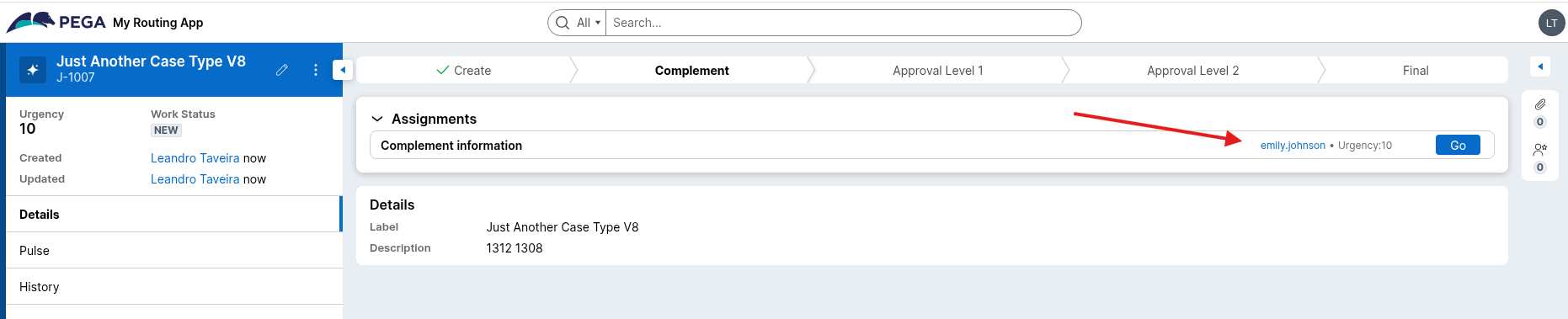

In the example above, the assignment is routed to Emily Johnson, as she is the only available operator in the RH@MyRoutingApp work group with a "Recruitment" skill of 8 or higher.

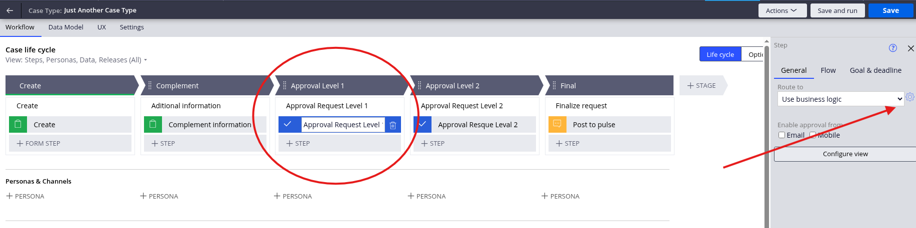

- Select the Step: In the case type, select the assignment step (e.g., "Approval Request Level 1").

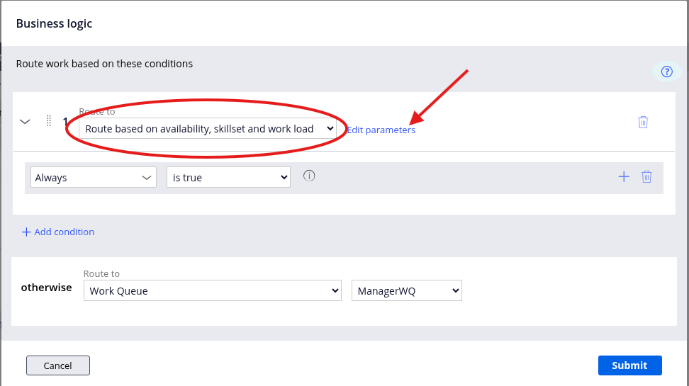

- Define the Logic: Click on the Gear icon and set the routing to Route based on availability, skillset and work load.

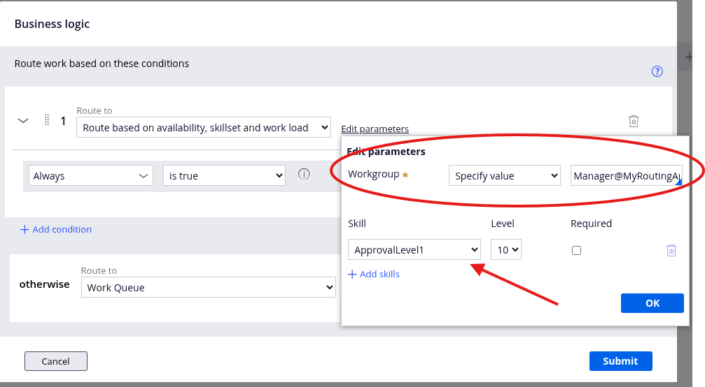

- Set Parameters: Configure the
Work group(Manager@MyRoutingApp) and the desiredSkill("ApprovalLevel1" with a level of 10). Theotherwiseroute is set to theManagerWQ.

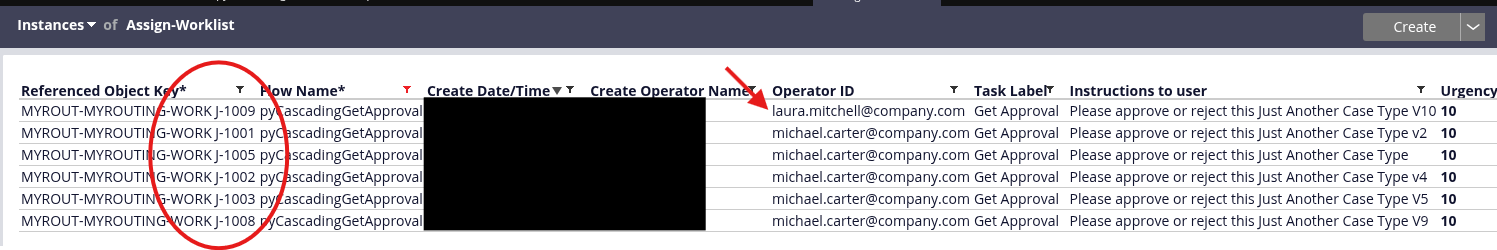

This configuration evaluates both Laura and Michael, finds they are both highly skilled, and then assigns the task to the one with fewer open assignments in their worklist, ensuring an equitable distribution of work. First I added some cases directly to Michael Carter. Then I added the skill to Laura Mitchell; once I create a new assignment, it was routed to her.

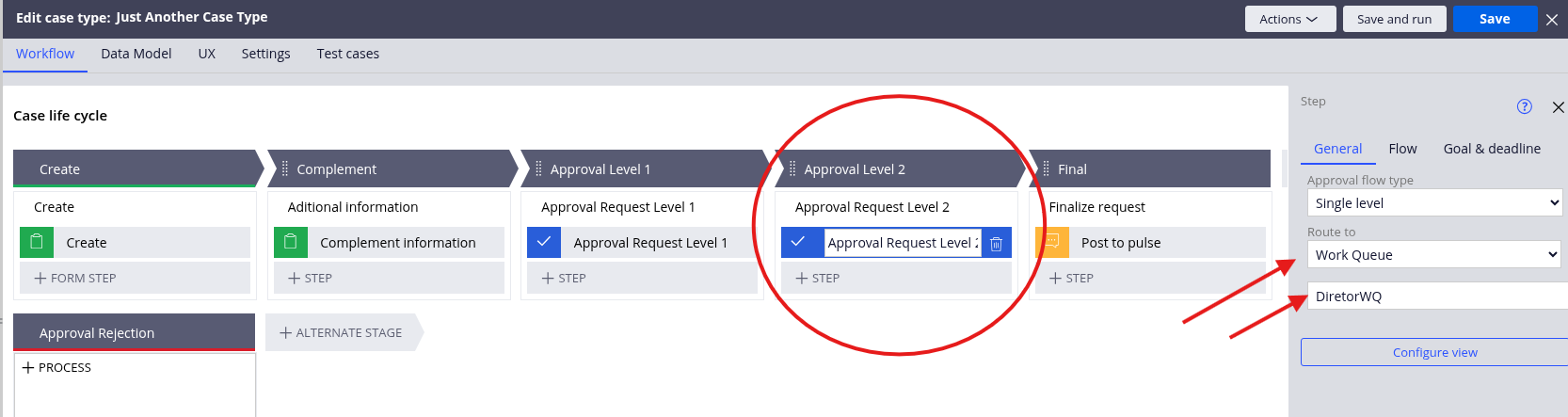

- Select the Step: Navigate to the assignment step (e.g., "Approval Request Level 2").
- Choose Work Queue Routing: In the step's configuration panel, set the `Route to` field directly to Work Queue.
- Select the Queue: Select 'Work Queue', then select the target queue (e.g., DiretorWQ) from the dropdown.
When the case reaches this step, the assignment is placed in the DiretorWQ. Any operator with access to this queue can then take ownership of the task using the Get Next Work feature.
