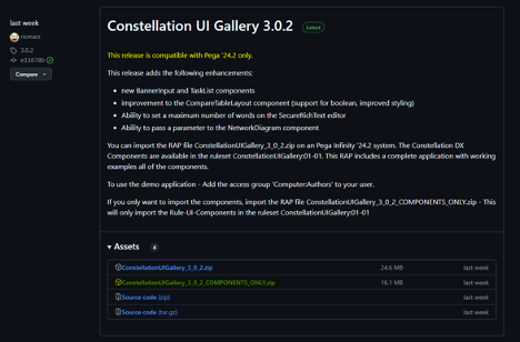

Go to the github repository for ContellationUIGallery:
Click Releases link on the right side of the page.
Search for a Release that lists your Pega Version as its supported release in the description.
Download the ConstellationUIGallery_COMPONENTS_ONLY
The other .zip folder contains a demo application called Computer Land that contains examples of use cases for all components.

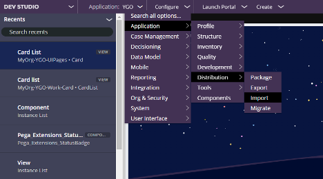

Open Dev Studio in your Pega instance.
Ensure that your selected application is what you want to import into.
Click the Configure Dropdown and follow the below steps:
Application
Distribution
Import

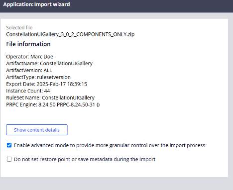

4. Check the radio button for Import from a “Local File”
5. Choose the ConstellationUIGallery_ComponentsOnly file.
6. Click “Next”
7. On this Page you can Click “Show Content Details” to see what exactly is being imported.
For this example it is importing:
RuleSet: ConstellationUIGallery 01-01-01
42 instances of Rule-UI-Component class.
8. Click “Enable advanced mode to provide more granular control over the import process”
9. Click “Next”

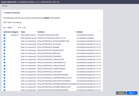

10. If you Enabled Advanced mode you will be able to select the exact rules you want to import into your Pega System.
11. When you click “Next” the import process will begin.

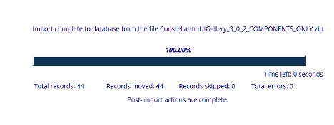

12. If there are any errors you can click the Total Error count to investigate what failed.
