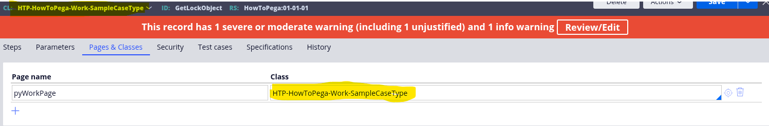

2 - Configure Your Pages and Classes
    - Add your 'pyWorkPage' in pages and classes referencing your work class ('HTP-HowToPega-Work-SampleCaseType')

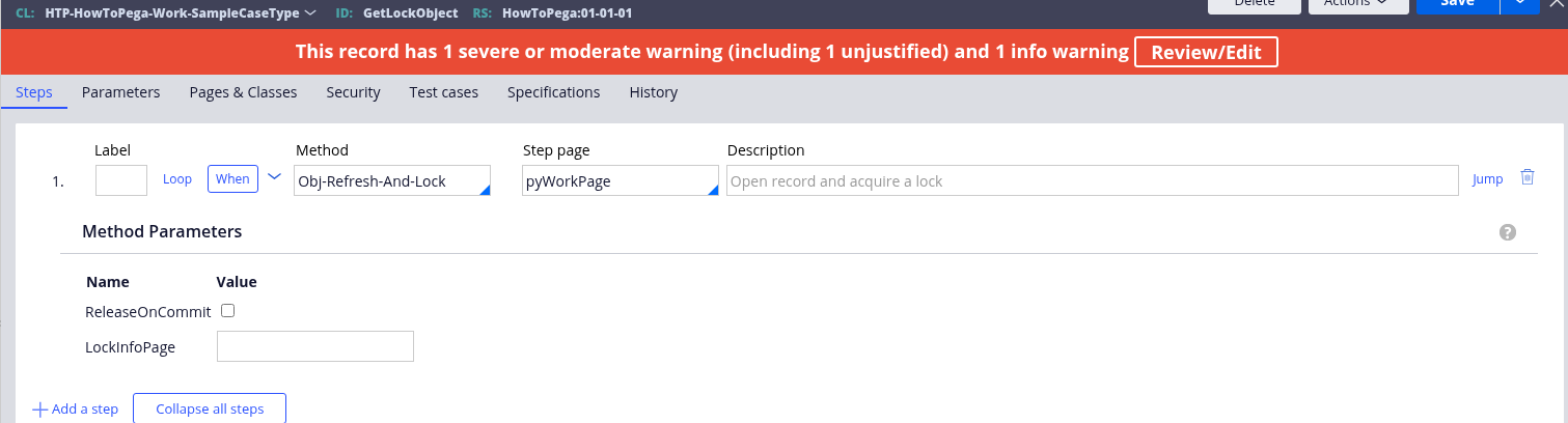

3 - Configure your activity
There is only one main step in the implementation process:
  - Use the method 'Obj-Refresh-And-Lock' to ensure that a step page's contents are current and that an object is locked
  - Set the 'pyWorkPage' page to the 'Step Page'
  - Set the When condition to check if the page is locked:
  - When: @isPageLocked(tools,myStepPage)
    - if true: Exit Activity
    - if false: Continue Whens
