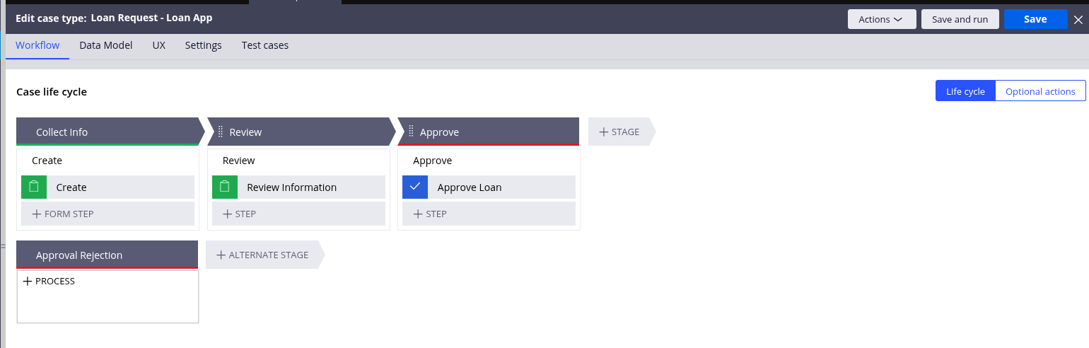

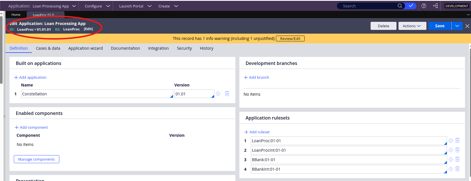

1. In Dev Studio, create a new application named `Loan Processing App`.
2. Add a Case Type named `Loan Request`. Configure its case life cycle with stages like Collect Info, Review, and Approve.
3. The underlying class for this case type will be `[Org]-[App]-Work-LoanRequest`, which in this example is `BBank-LoanProcessing-Work-LoanRequest`.

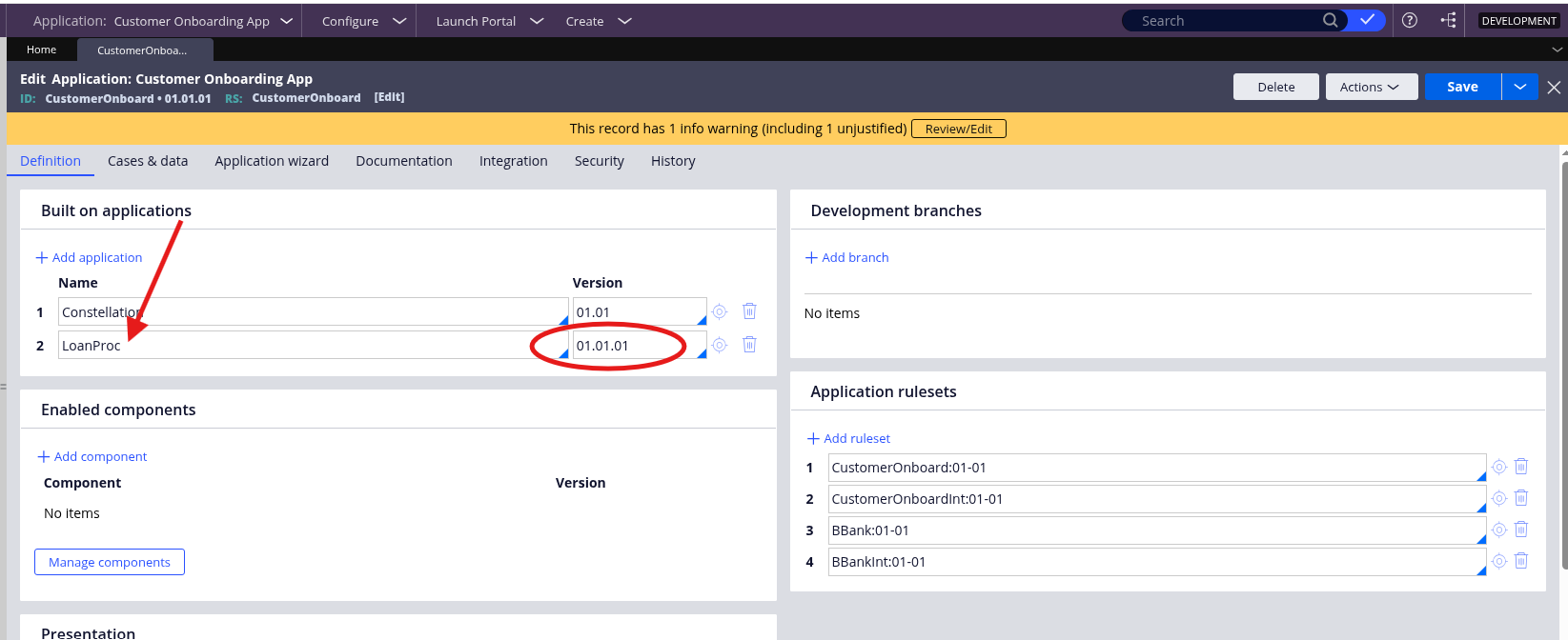

Next, create the main application that will contain the parent case. This application must be built-on the base application to access its rules.
1. Create a new application named `Customer Onboarding App`.
2. In the application definition, add the `Loan Processing App` (`LoanProc`) to the Built-on applications list.

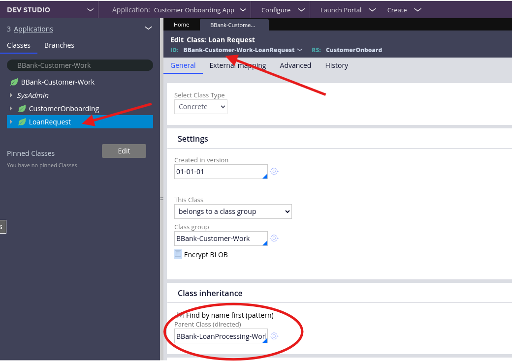

1. In the `Customer Onboarding App`, create a new case type and name it `LoanRequest`.

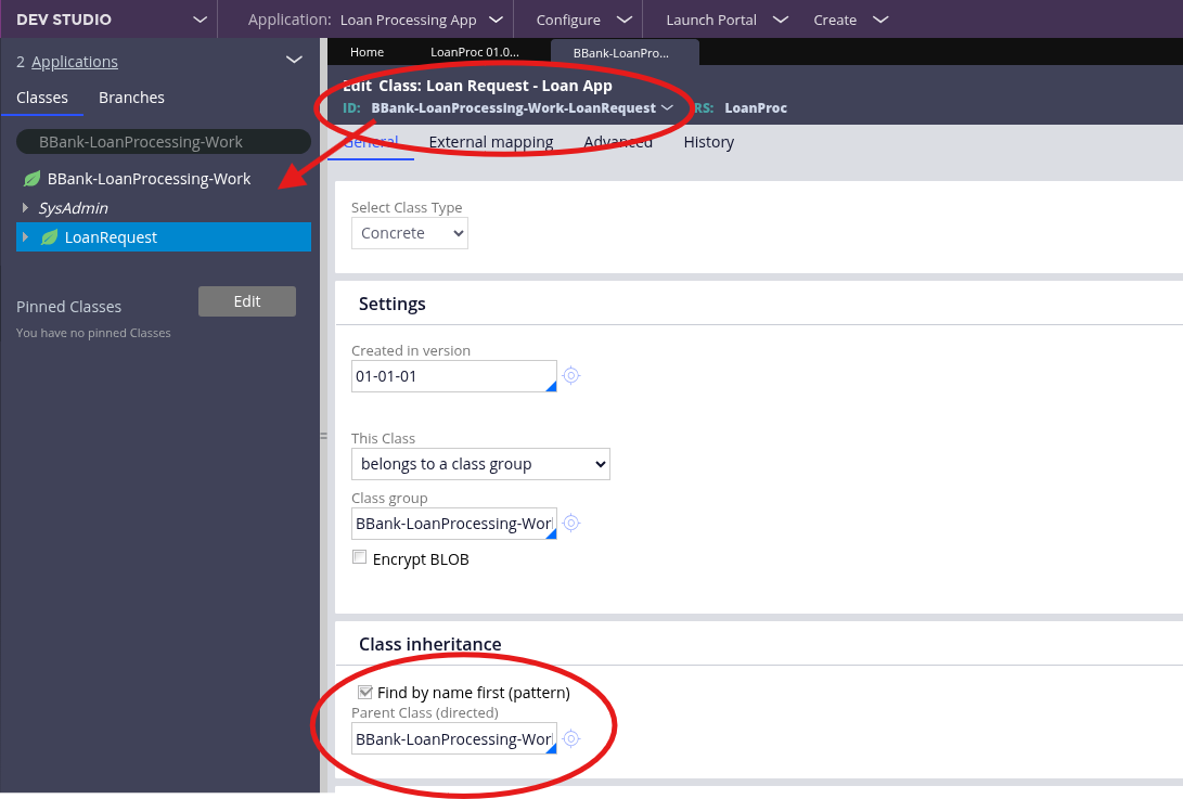

2. Navigate to Dev Studio and open the class rule for this new case type (e.g., `BBank-Customer-Work-LoanRequest`).
3. In the Class inheritance section, set the Parent class field to the class of the base case type. This configures directed inheritance, allowing rules to be reused across different applications: `BBank-LoanProcessing-Work-LoanRequest`.
This ensures your new case type inherits from the base one.

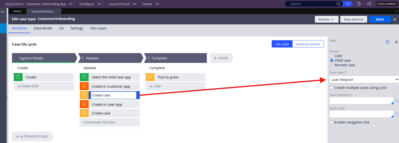

2. In the `CustomerOnboarding` parent case, you can add a Create Case step and directly select the `Loan Request - Loan App` case type.
You can see both the inherited (`BBank-Customer-Work-LoanRequest`) and the base (`BBank-LoanProcessing-Work-LoanRequest`) case types are available to be added as child cases to the parent `CustomerOnboarding` case.

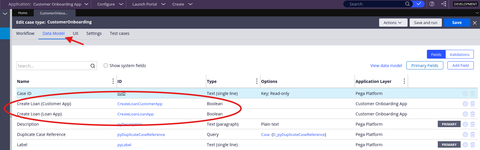

1. In the `CustomerOnboarding` data model, create two Boolean properties to control the logic, for example:
- `CreateLoanCustomerApp`
- `CreateLoanLoanApp`

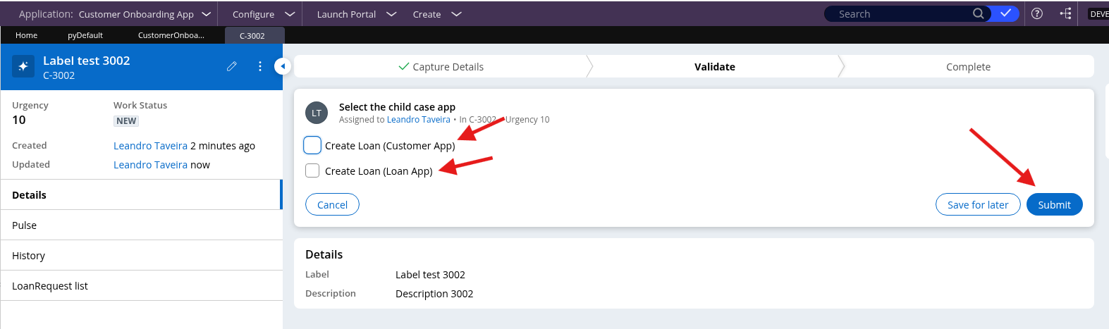

2. In the `CustomerOnboarding` case life cycle, add a step with a form where the user can select which child case to create. This form sets the Boolean properties from the previous step.
3. Use conditional logic (like a fork in the process) based on the Boolean properties to trigger the correct Create Case step—one for the inherited case and one for the directly reused case.

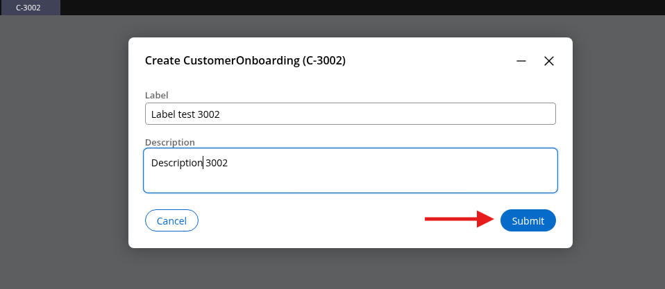

1. Create and submit a new `CustomerOnboarding` case.
2. At the selection step, choose one of the options (e.g., "Create Loan (Customer App)").
3. After the case proceeds, verify that the correct child case is created.

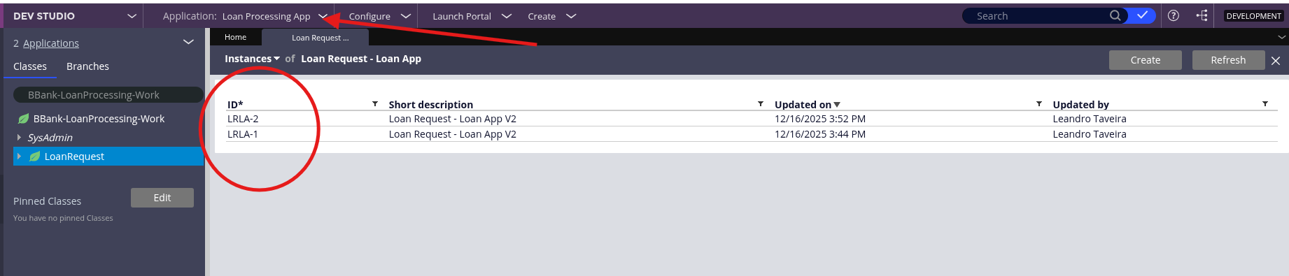

- If you chose the inherited case, a new instance (e.g., `LR-1`, `LR-2`) will appear under the `BBank-Customer-Work` class.
- If you chose the direct reuse case, a new instance (e.g., `LRLA-1`, `LRLA-2`) will appear under the base application's `BBank-LoanProcessing-Work` class.
