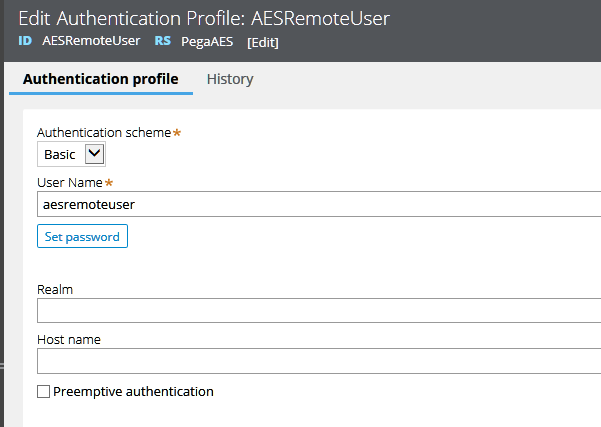

4. Authentication at app server level (authentication profile set to match on AES remote)
You may need to use the AESRemoteUser authentication profile.
