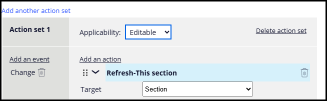

Separate parts of the UI into sections that can be specifically targeted for a refresh. The Refresh action by default targets the current section, but can be modified to only target content in a specific section. By separating parts of the UI into separate sections, you can ensure that only the content in the separate gets its markup re-generated.
This can be useful for when a refresh is required to update or display new content outside of the user's current focus, such as making form fields or text become visible lower in the form. Doing so will retain focus on the control the user is interacting with without having it be re-generated and re-focused due to the entire parent section being refreshed. This approach may require a Post Value action before the Refresh-Other section action to ensure the user-inputted data is sent to the server.

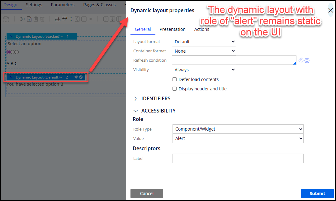

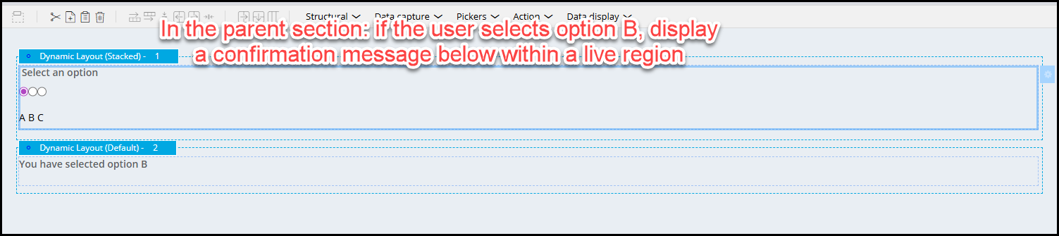

Use targeted section refreshes to ensure live region containers remain static. This approach is similar to the above, where we only target the content that needs to be refreshed rather than the whole UI. For example, let's say an application author wants to display a confirmation message below a radio button control after the user selects option B. This radio button contains a Post Value action and Refresh-other section action.
In this parent section, we create a dynamic layout below the field that has the role of "alert" configured. This will remain static on the UI:

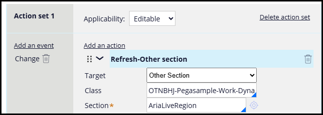

Within it is an embedded section containing the content that will appear when the visibility condition is met, that being if the radio button selection is option "B". This is the other section being targeted by the refresh action on the radio button control.

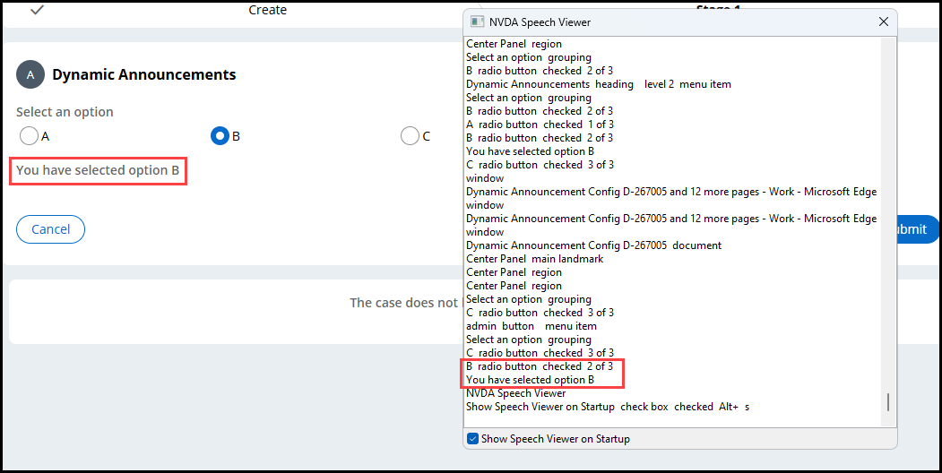

At runtime, we can see that when the user selects option "B", the confirmation message appears on the UI and is immediately announced by screen readers:
