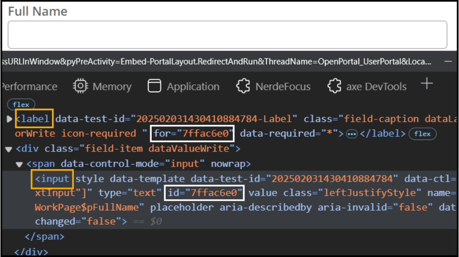

For labels on form controls, Platform will generate a <label for="[form field ID]"> to serve as the visible and programmatic label of the field. The ID value generated for the form field is a random string of characters and digits.
The random ID value is generated on a per-property basis. This means that each form control assigned the same property will generate the same ID value for each instance of the <input> in the DOM. This can introduce issues with how assistive technologies perceive the relationship between label and form field as the ID will no longer be unique.
As a best practice, avoid configuring the same property multiple times on the same page. This is also applicable if using visibility conditions to hide a second field with the same property on a given page. Should this configuration be necessary for business requirements, make sure to disable the "run visibility condition on client" configuration to ensure that the second instance of the ID is not loaded into the DOM until absolutely necessary.
