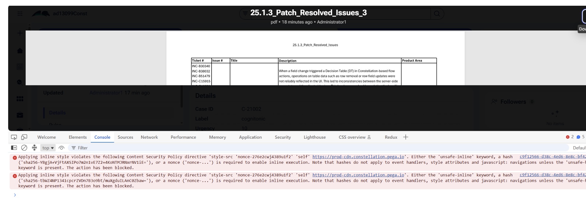

9. Click the uploaded attachment to preview the file. Result: A half preview of the PDF will be displayed. CSP errors are displayed in the console.
Error
The following error is observed in the console:
Applying inline style violates the following Content Security Policy directive: 'style-src 'nonce-lcp5ms165gw4k1pz' 'self' https://release.constellation.pega.com'. Either the 'unsafe-inline' keyword, a hash ('sha256-YBgjA+VjFtAXSIPo7m2n1vE7Z2+4KoNTMJRNxrNV1iE='), or a nonce ('nonce-...') is required to enable inline execution.
