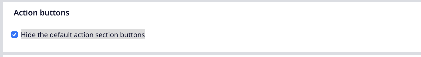

In Dev Studio the visibility of default buttons in a Flow Action can be controlled using the checkbox Hide the default action section buttons but in Pega Constellation this option does not work, and the and buttons remain visible.

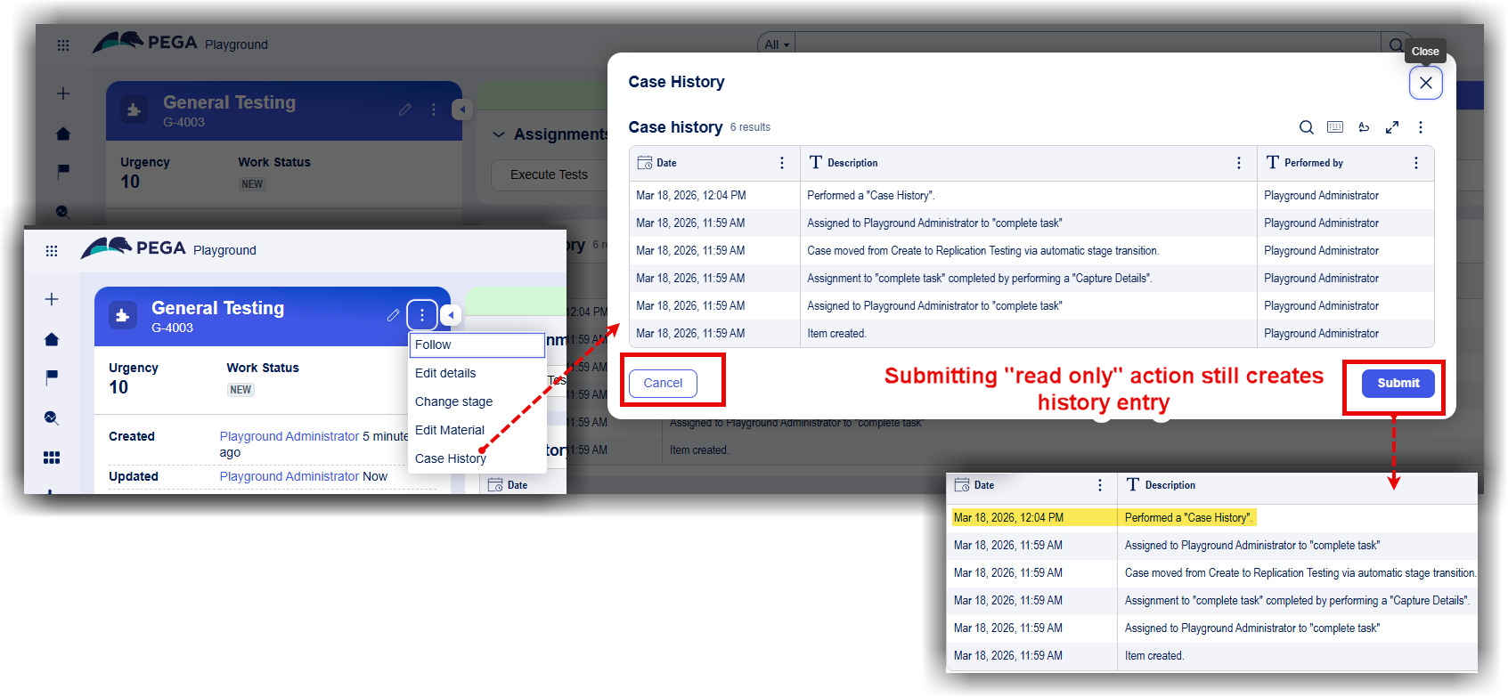

Users on a case-wide Flow Action are unable to configure it to behave as a read-only modal, so that the default action buttons (e.g. Submit, Cancel) are not displayed.
This can be illustrated for scenarios such as , where users need to view case information without performing an update. When a flow action is used this way, submitting the read only data still creates a history entry.
Viewing in a modal will create a history entry if submitted (see highlight in yellow).

On the tab, select the buttons section,
Select the option Hide the default action section buttons.
- Run the Case - The and buttons are still visible in the Constellation portal.

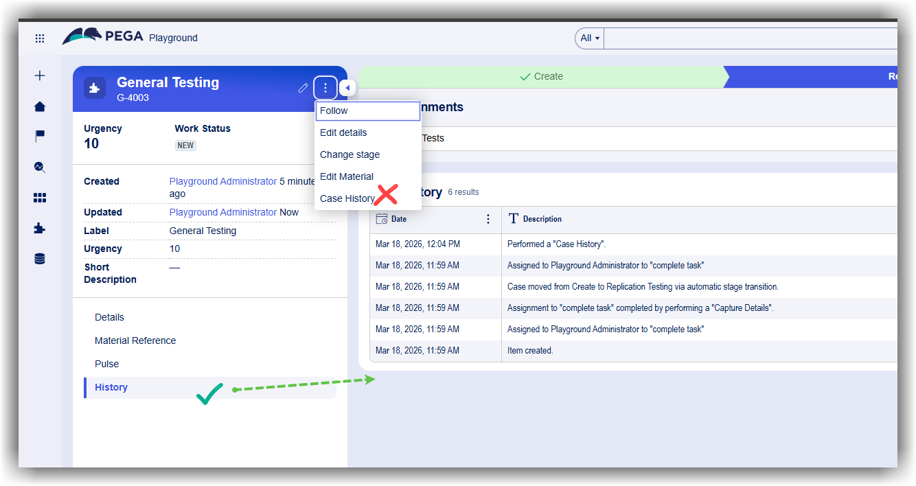

There is no supported workaround to hide, remove, or replace the default action buttons in a Flow Action using the Hide the default action buttons setting in Constellation.
If the user’s requirement is to provide a read-only, case-wide local action (for example, a action that should not result in a case update), an alternative design pattern is recommended. The preferred Constellation approach is to expose this information via a read-only case tab or similar non-submittable UI construct that does not require a Flow Action or submission. This avoids unintended case edits and aligns with supported Constellation patterns.
