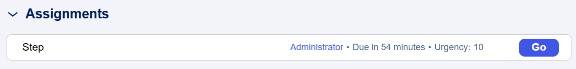

- The Assignment ToDo Widget in Constellation UI shows the SLA deadline as a single unit only (Days, OR Hours, OR Minutes, OR Seconds).
- When a case is moved to an assignment with an SLA configured in Business Hours (for example, 2 Business Hours), the SLA timer initially displays the correct value but then switches to a simplified single-unit representation (for example, "1 hour” ) within a few seconds of page load.

- View the Assignment ToDo Widget in the Constellation UI.
- Result: The widget initially displays the correct Business Hours value, then after a few seconds switches to a single-unit display such as "1 hour” losing the Minutes and Seconds breakdown.

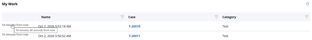

- Compare this with Traditional UI, where users can implement the out-of-the-box (OOTB) pyAssignmentTimeLimitDeadline control which has the hover functionality to display the multi unit format.
