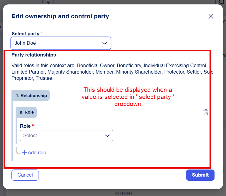

Visibility conditions defined on embedded data or modal views are no longer evaluated correctly, resulting in UI elements not rendering. This primarily affects visibility logic defined on View rules, causing fields or UI sections to remain hidden even when conditions should evaluate to true.
The issue is most prevalent when server‑side When rules are used to control visibility in embedded contexts, however the same behavior can be seen in Views using When rules affecting Disabled /Edit conditions.
Steps to reproduce
Create a View and add two properties: Property1 (Select Party) and Property2 (Party relationships). Property1 has a dropdown control with a list of possible values.
Configure Property2 with Visible When rule to show only if a value of Property1 is selected.
Select a value from Property1 dropdown. This should show Property2 but the Property does not display.
