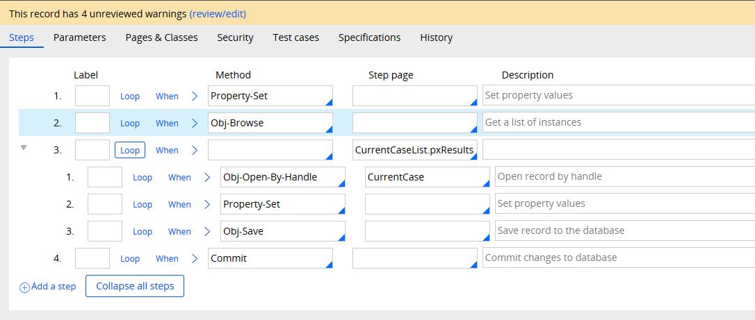

Please check my activity.
At Obj-Browse step, I get the subjected work item (case).
At Obj-Open-By-Handle, I open the subjected work item (case).

I tried this and it is working fine for me. please find the snap of activity.
I have below findings from your activity. ( note sure if that is the problem)
1. Initialize the CurrentCase Page (using Page-New)
2. Use CurrentCase Page as a step Page for the step 3.2 and 3.3
3. Did you try just Opening one case (using direct pzInsKey) and updating it ? without Obj-Browse?
4. Are you sure that the page class is correct? it seems like Work pool, do you have any other class under that? that you want to save?
