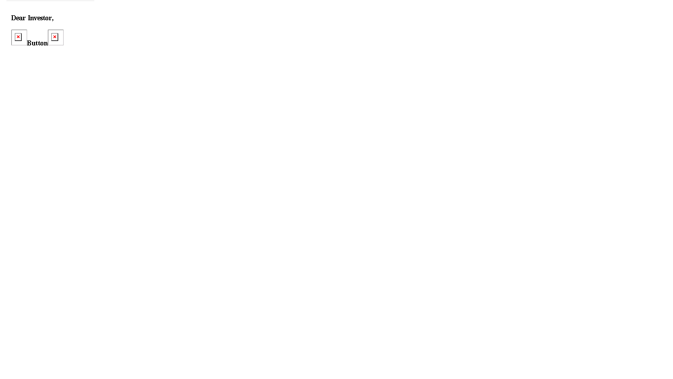

V7.1.7
Created Corr rule for email template.
Buttons referred in section. The section referred in corr rule.
Email triggrred to user. In the email buttons are looking as pointed above.

Please try below steps.
you have created a section rule with embedded image. Hence, by default the image reference would be something like this: img src=webwb/KeyEnergyServices.png We need to provide the absolute path by following the steps below: 1) In your section, uncheck the auto-generated HTML checkbox in HTML tab and write the image tag as follows in the HTML source: IMG src='/webwb/KeyEnergyServices.png' 2) Now include this section in the correspondence Fragment which should then work as expected.

How are you triggering email? If you are using "SendCorrespondence" flow action in a flow you should see the image. If you use "SendEmailNotification" to trigger email you couldn't see the image in email.

it's not an image. I have used pega default buttons.
Did you use any custom CSS/icons or images for buttons? It looks like the path to the image/css is missing. If it is a icon/image you are referring you need to pass the correct path like directoryName/FileName.Extentions
Ex: webwb/unlock.png
Truviq Systems
No CSS/icons or images.
Tried with standard / simple / strong button formats.

hi Chaitanya,
in the email correspondence, only inline styles will work.
custom html may work for you ... replace the pega button with custom button with inline style.
