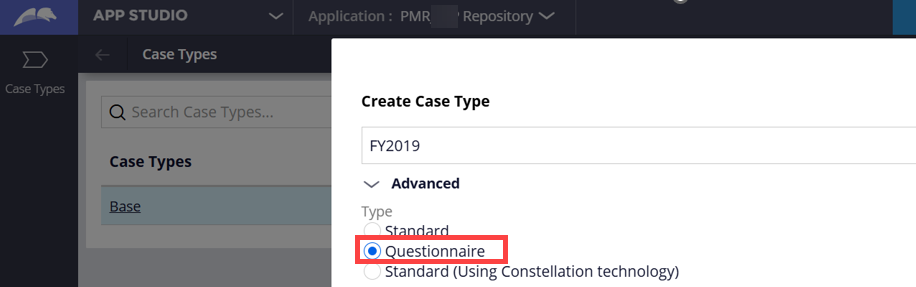

Step 2 - Create a new case type and enter a case name.
- IMPORTANT: be brief with the case name because this will be part of the class name (auto generated), which has a character length limit.
Step 3 - Expand the Advanced section and configure as below.
- Type="Questionnaire"
- Reuse assets from="Base"
- Note: this is the existing Questionnaire case type that we are reusing in this example. This already contains a set of question pages and question rules.
- Select Reuse case life cycle checkbox.
- Click Next.
