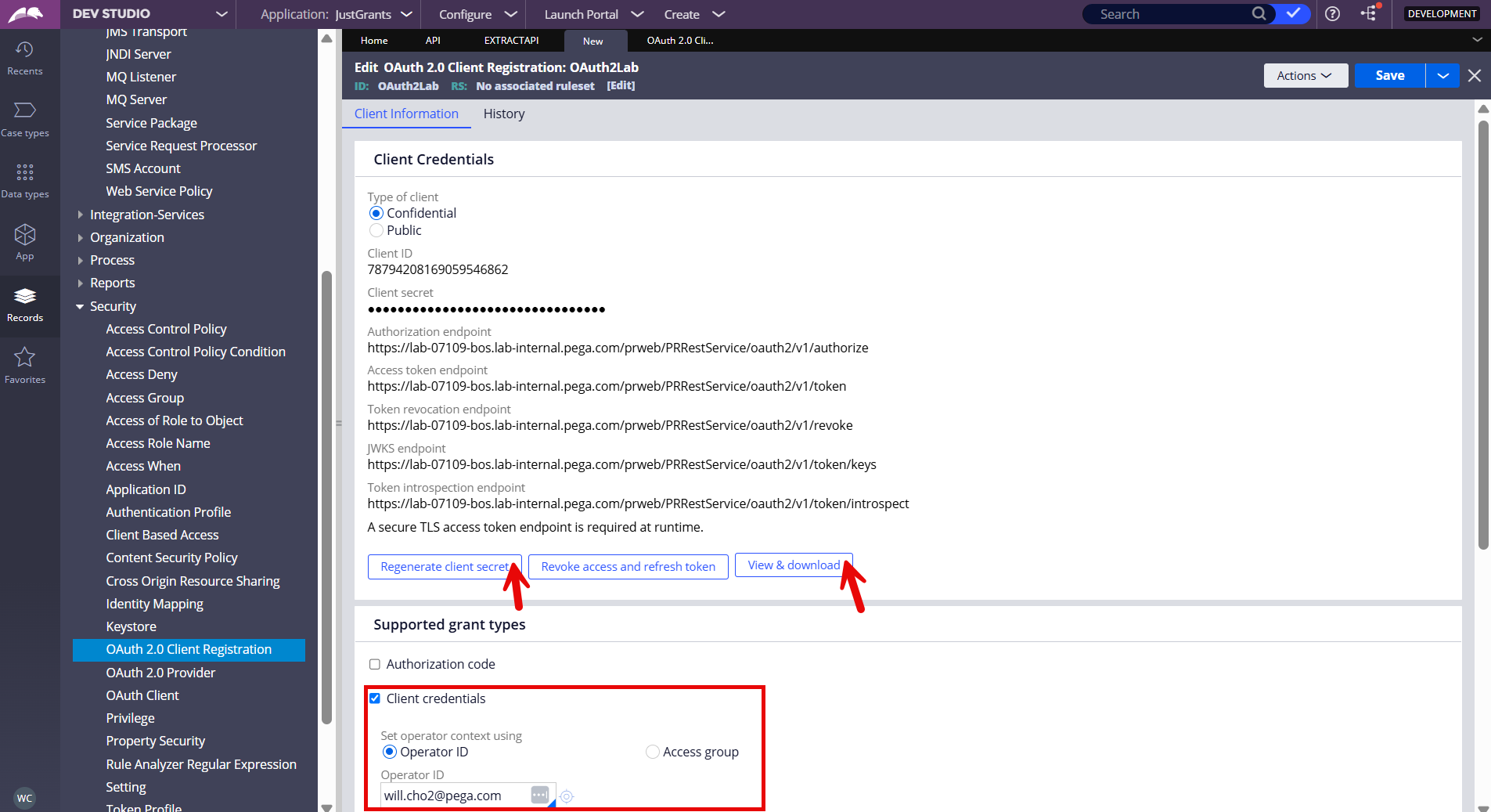

Step 1 - Create a new OAuth 2.0 Client Registration instance in DEV Studio.
In this example, we specified an Operator ID in the client credentials section. This Operator ID is mapped to an access group that has access to the case type.
Click to regenerate the client secret and download the client credentials file.
Step 2 - Save the instance.

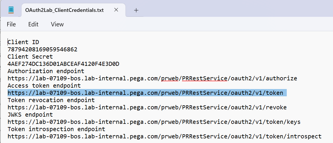

Step 1 - Copy the Access token endpoint value from the client credentials file generated above.

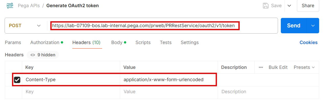

Step 2 - Configure a Postman request to invoke the access token endpoint.
Set the URL and the key-value pair under Headers.

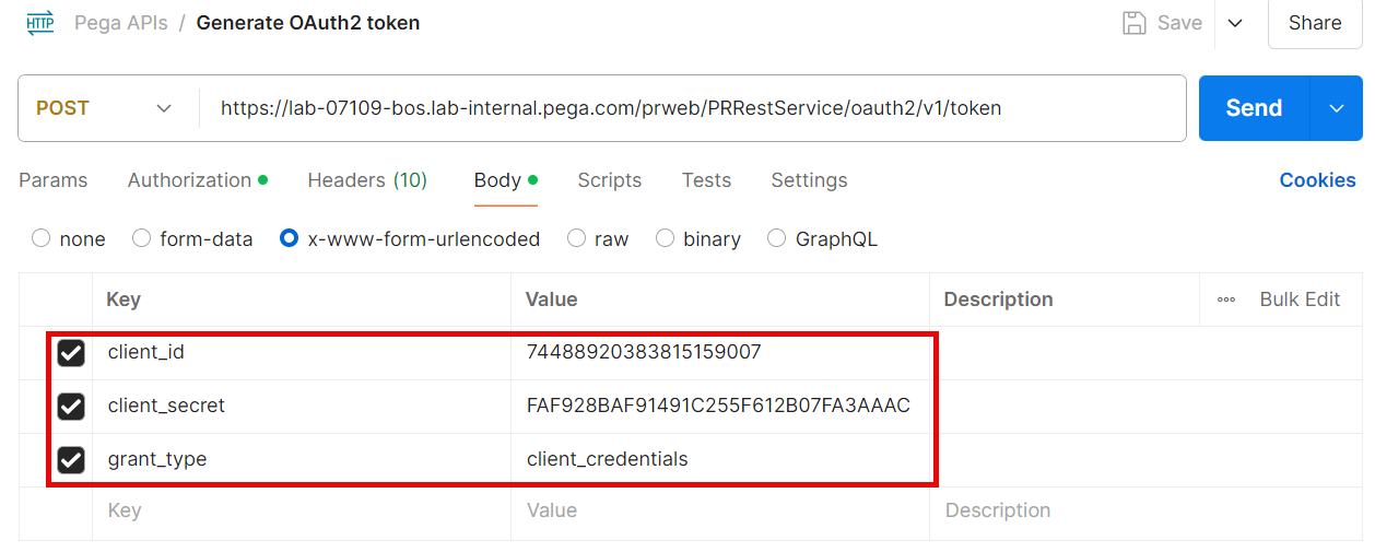

Set the key-value pairs under Body.
- client_id and client_secret can be copied from the client credential file.

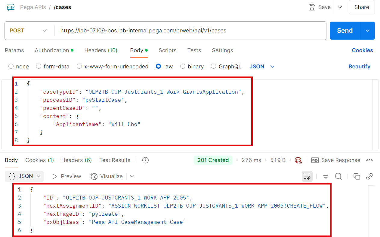

(Part C - Call Pega API - POST/cases (using Postman))

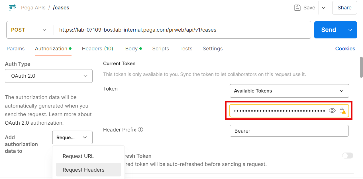

Step 1 - Configure the Authorization settings.
- Select POST and enter the URL for Pega API (cases)
- Click the Authorization tab.
- Select 'OAuth 2.0' in the Auth Type dropdown.
- Copy and paste the access token as shown below.
Step 2 - Specify the Request data and click Send to get a successful response

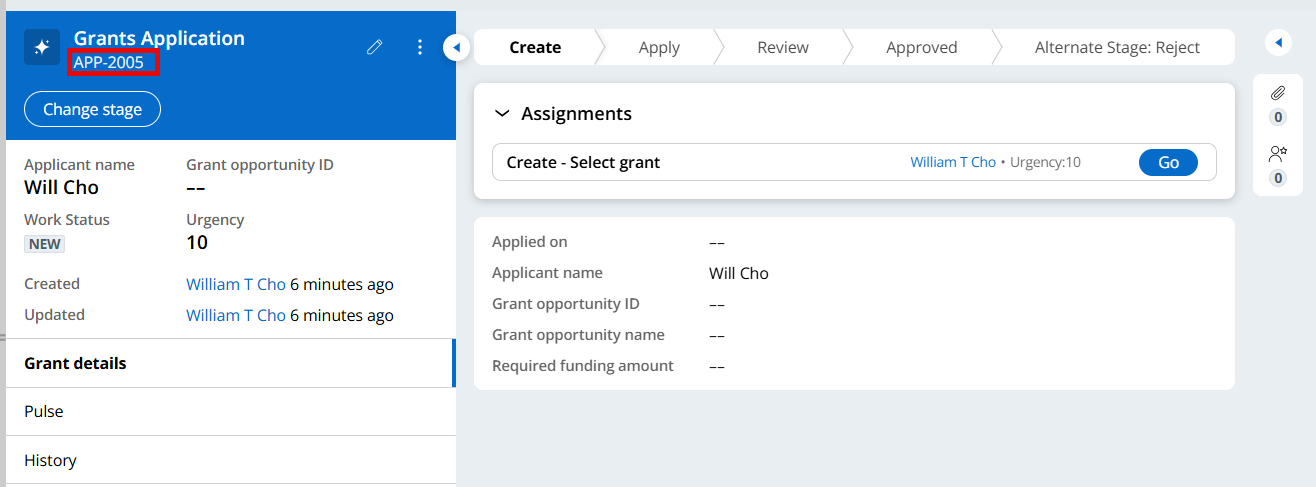

Step 3 - Verify that the APP-2005 case is created successfully in Pega.

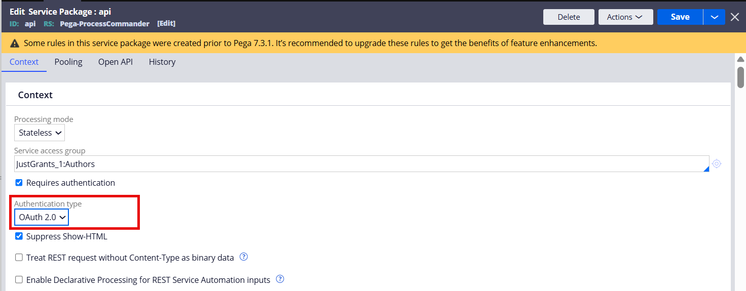

Additional information
- Note that the api service is set to require OAuth 2.0 authentication.
