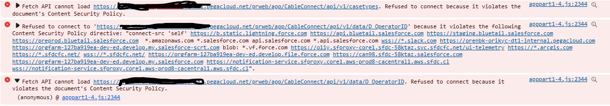

@Naga Malleswara Rao '<pega_server> is not responsing, please contact your system administrator.' is usually due to misconfiguration. What is the status of the first HTTP request? Does the request header contains the Bearer token? Can you share a screen shot of the component HTTP traffic?

Please provide the information I requested in my previous message:
- Does the request header contains the authorization Bearer token?
- Can you share a screen shot of the component HTTP traffic? Please share the screen shot of the first HTTP request with the request header and status. You can find that in the Network tab of the browser inspector.

The request that goes to Pega not to Salesforce, see your previous screenshot. That where your error is coming from.
Cognizant Technologies

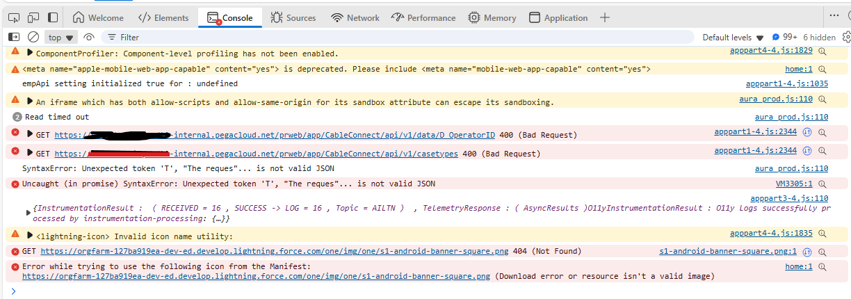

@issas I resolved that issue. I mapped wrong pega url and its working fine. But still I am facing same error but in browser logs, seeing some other error.

I can't help you without seeing the HTTP traffic. Please send the request URL, the request status and header with your questions.You can send screenshots from the network tab in your browser inspector.

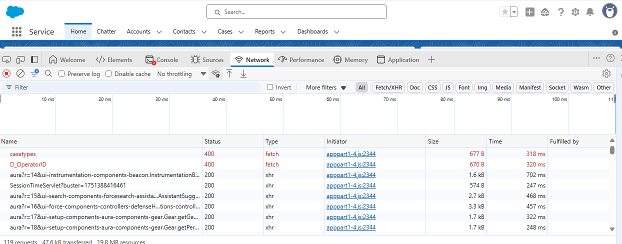

@issas I am not able to see anything in the network tab with http request. Please let me know if any details required.
Click on the casetypes request (the first red request from your previous screenshot), scroll to the Request Hearers section, take a screenshot and send it.
Thanks. I noticed that the request is missing an authorization header—it shows as authorization: undefined. That could be the root cause of the issue. It’s a bit unexpected, though, since typically this would result in an HTTP 401 error.
