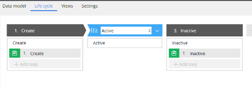

I have chosen to support this by creating a case "Franchisee".
That case has three basic stages:
- Create
- Active
- Inactive
So as a new franchisee comes on board, they would go through the Create stage, and when that is completed they would reside in the Active stage until such time as their franchise license was revoked. At that point they would move to the Inactive stage and ultimately resolve-complete.
What is the best way to have a case sit in a 'wait state' - allowing someone to open & review it and add sub-cases to it, but then at some point choose to initiate the inactivation stage?
- Create
- Active
- Inactive
Should I simply create a very high likelihood (e.g. default) flow action that connects back to it's assignment shape, and then a second, lower likelihood one that will ask some information to initiate the Inactivation process? I can use a Validation rule to ensure we don't enter the final stage without some confirmation info being provided.
Is there a 'more correct' way to do this?
