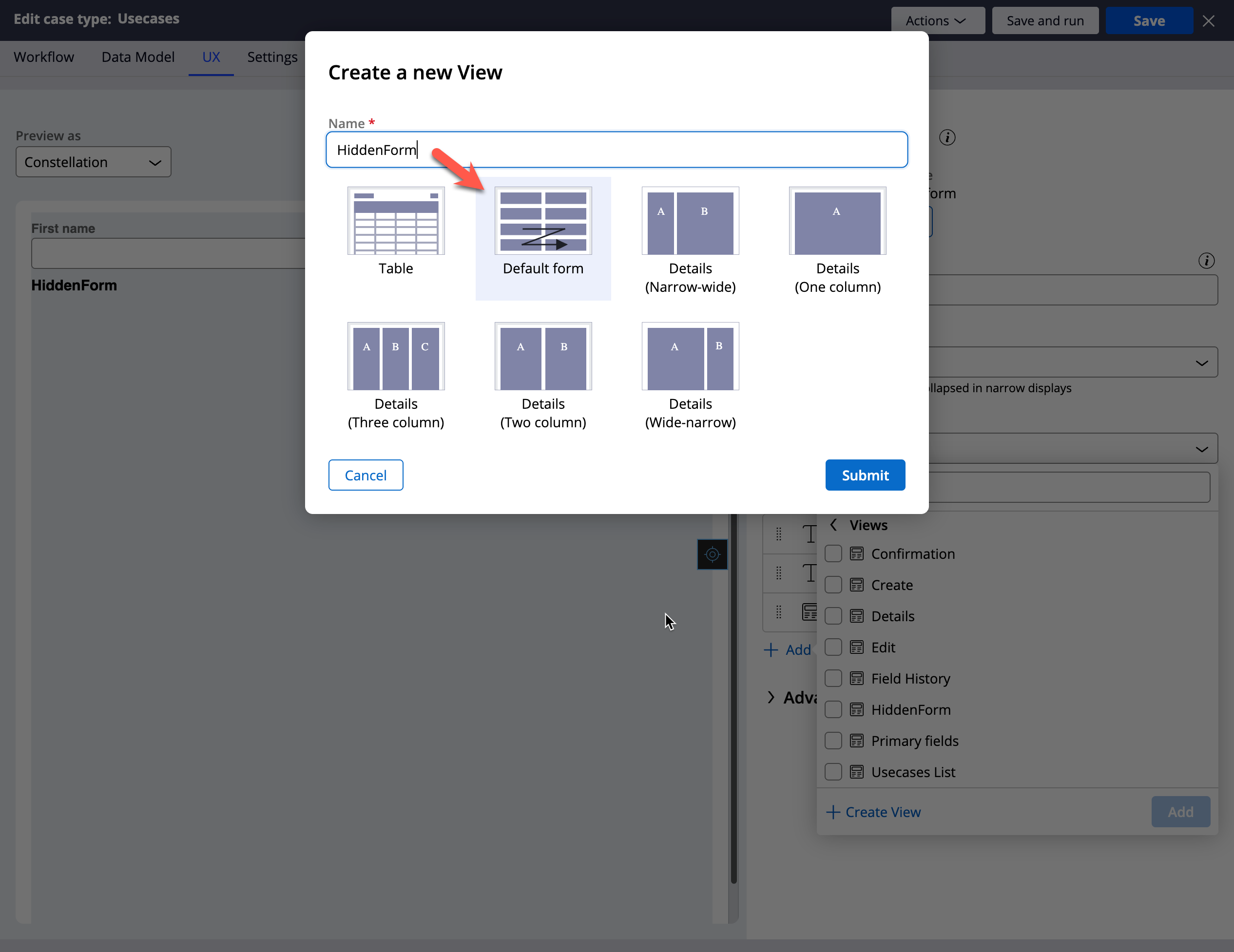

1. Create and configure a view where form submission need to consider hidden fields.
2. Add as a child view to form view.

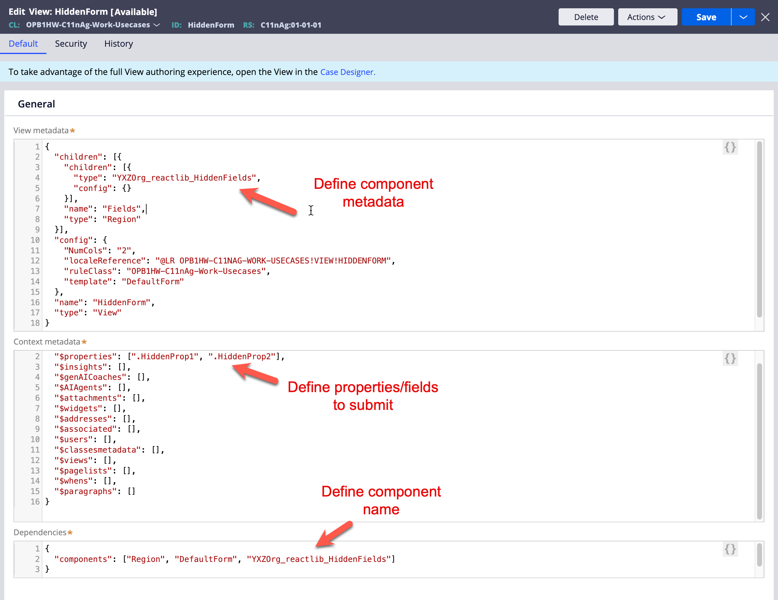

4. Open created view in dev studio and mark as custom.

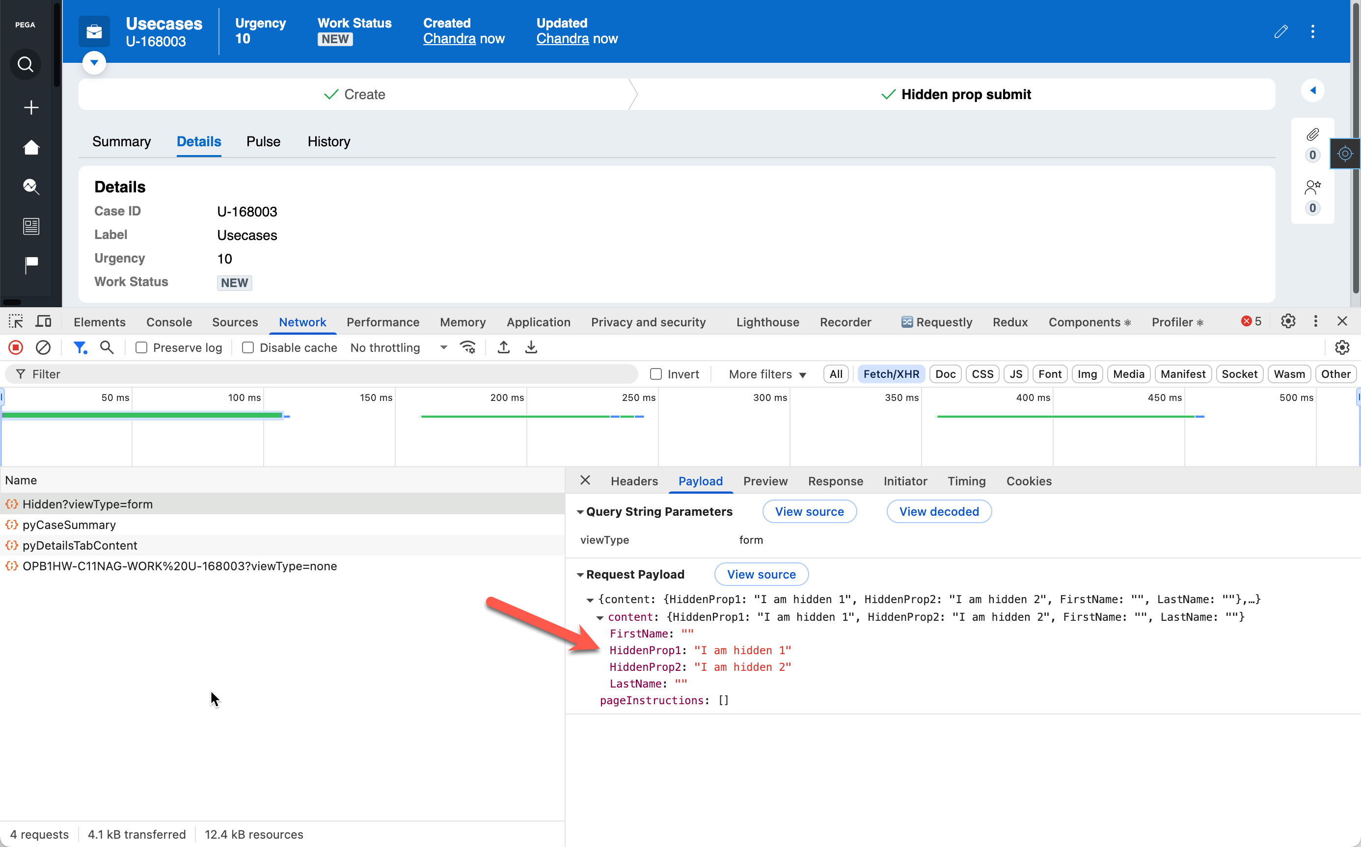

5. Define custom dx component and list of hidden fields so that security can be allowed.
Example runtime trace:
