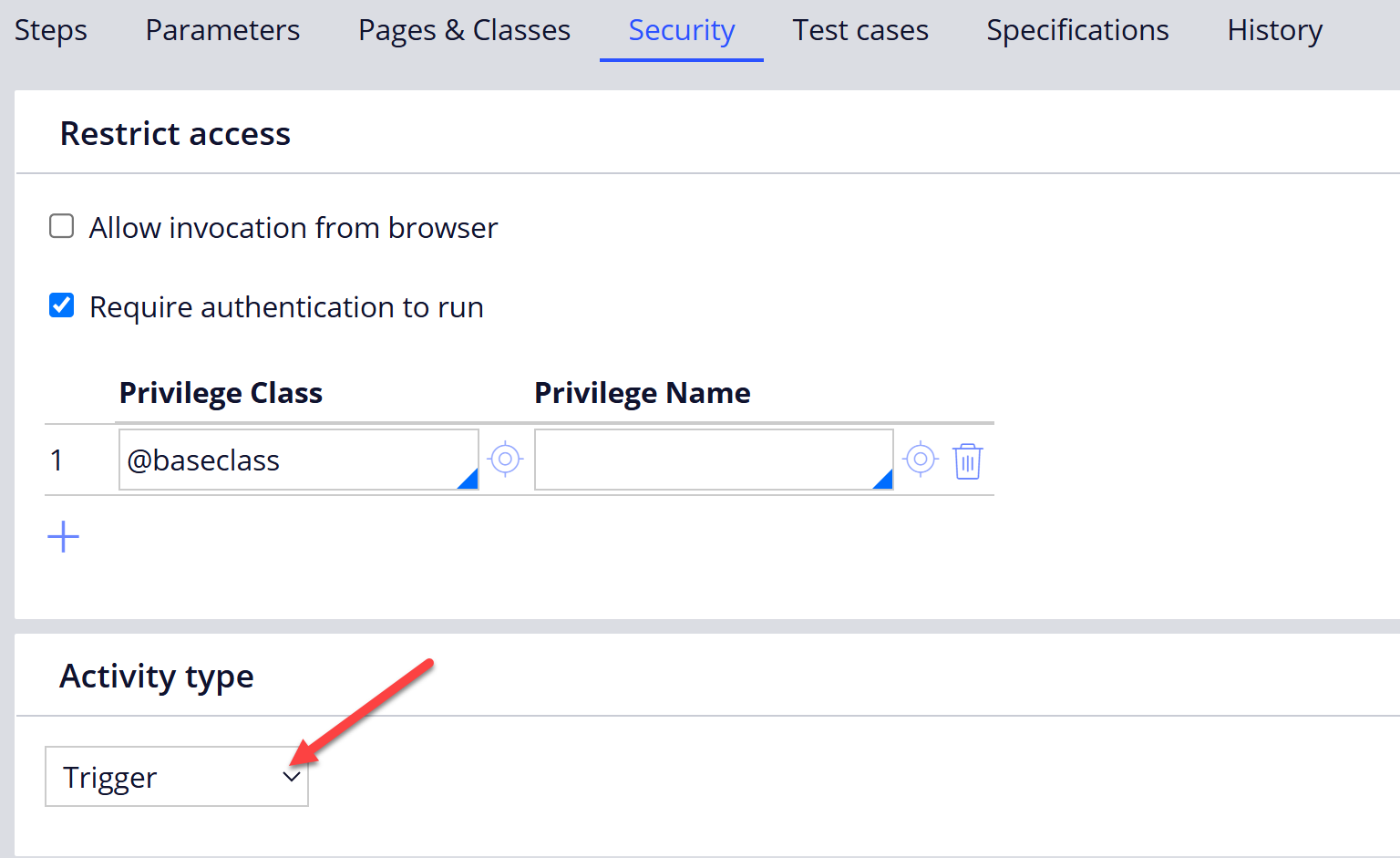

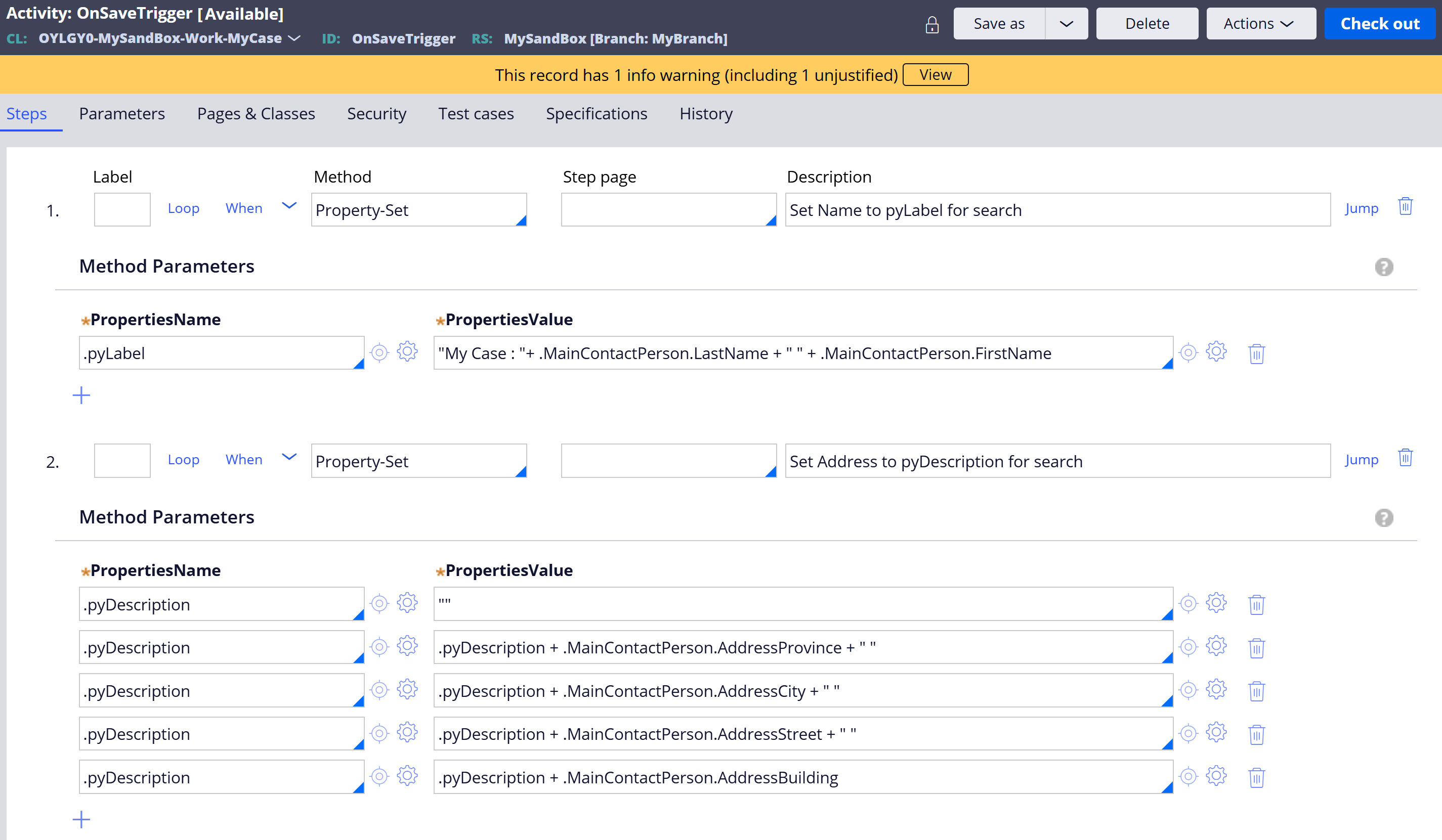

Step1: Create an activity which updates ".pyLabel" and ".pyDescription"

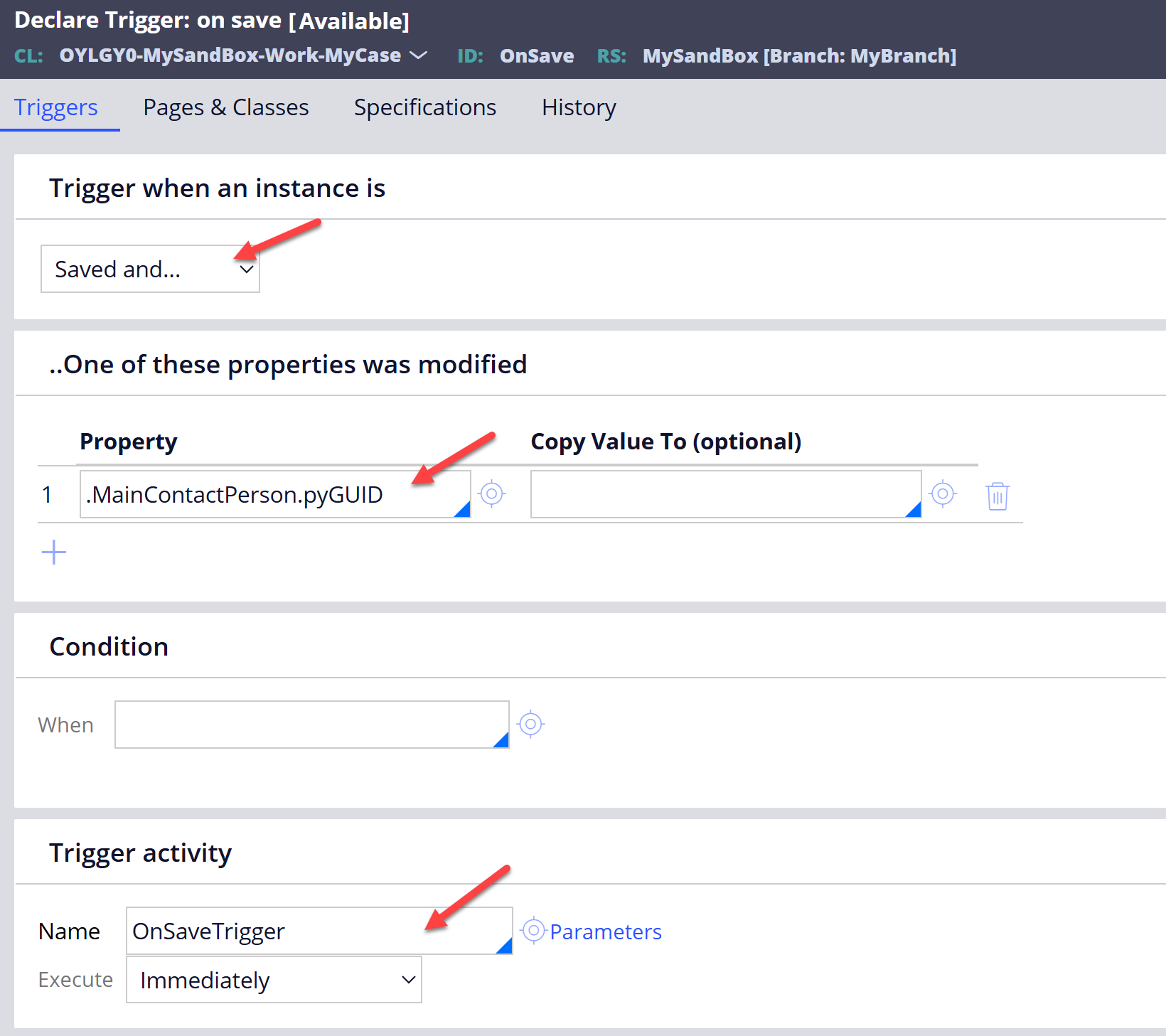

Step2: Create a Declare Trigger
