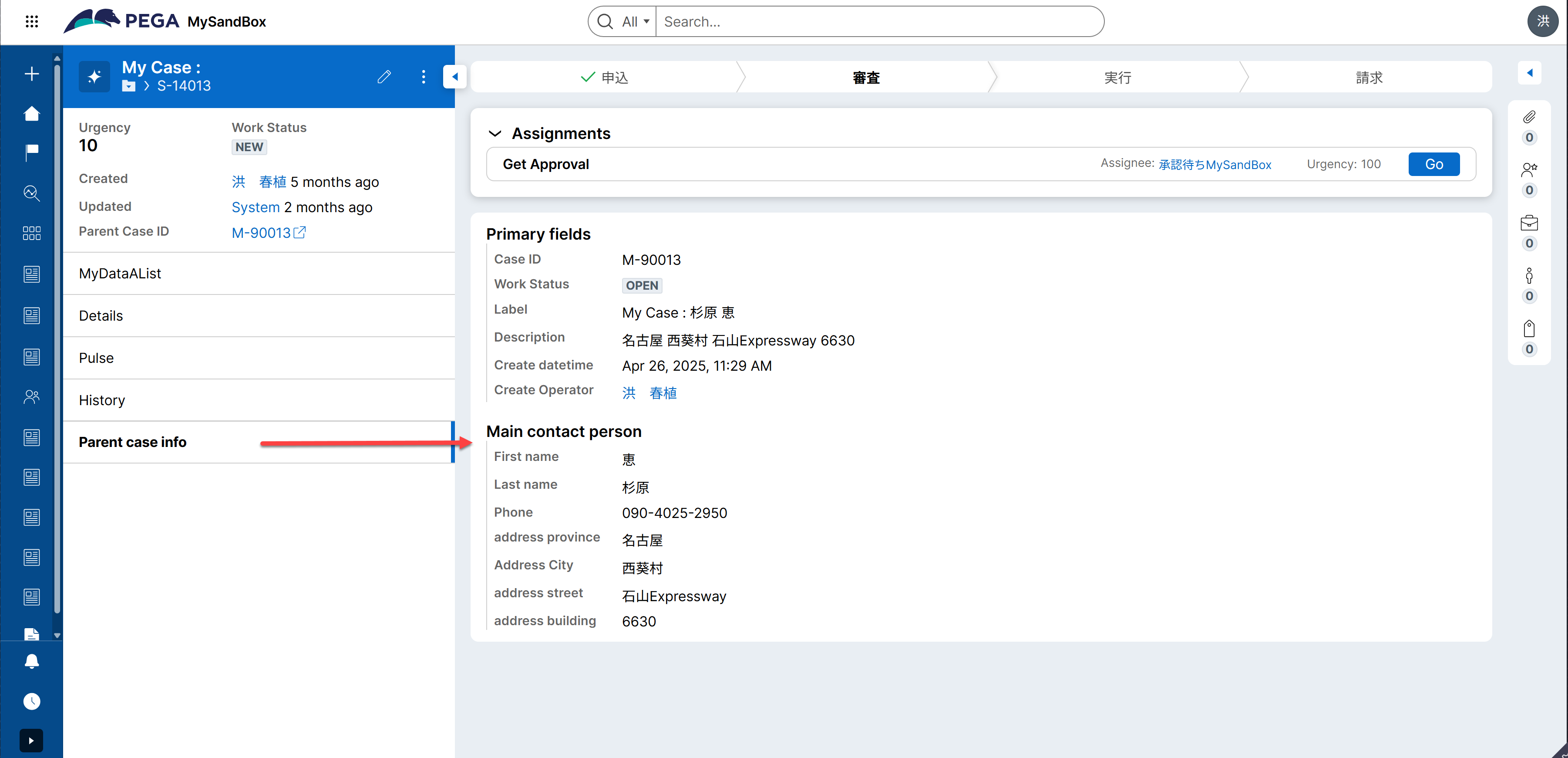

Use case: Users wanted reference parent case info from the child case's tab in summary pannel.

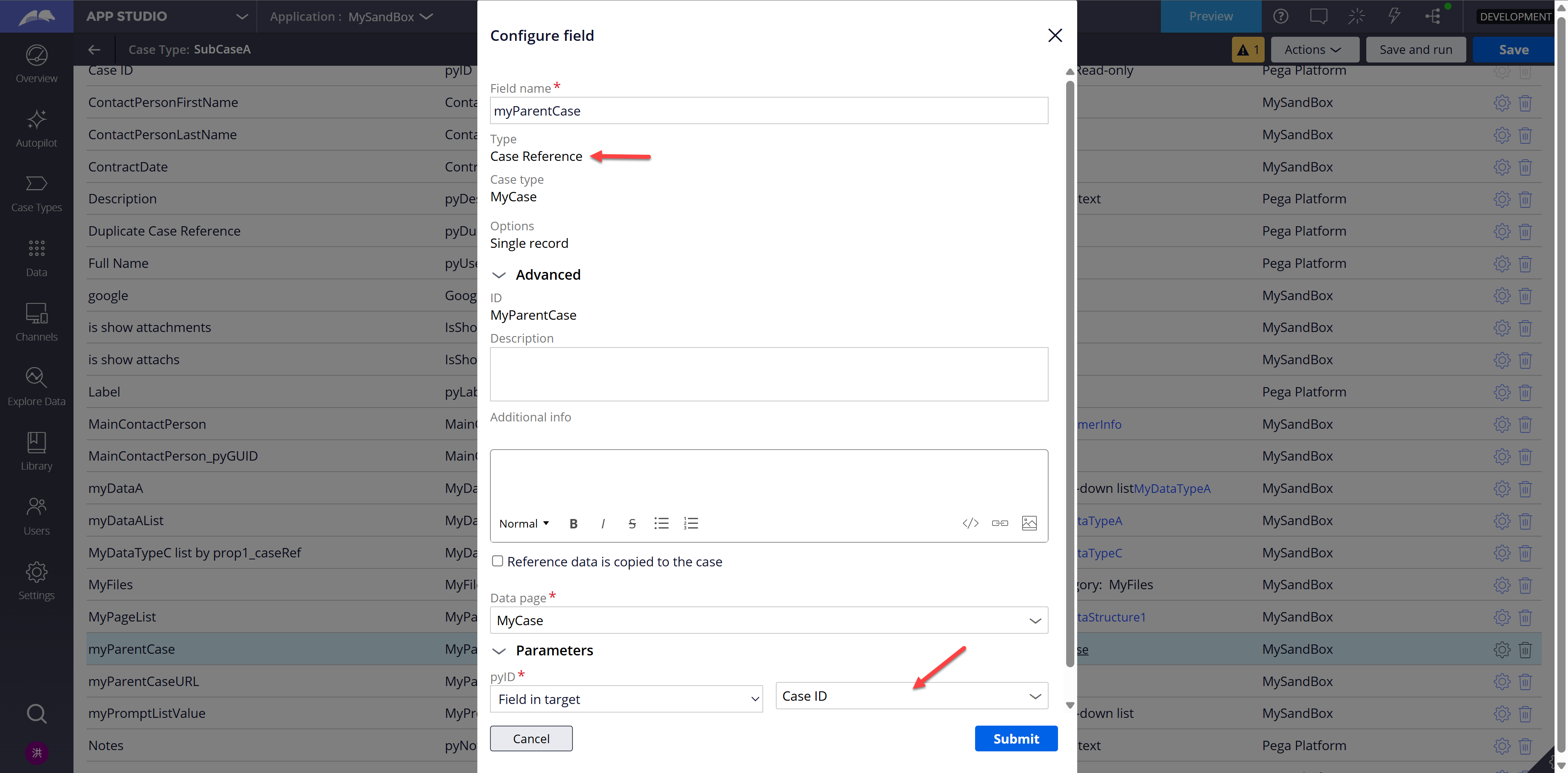

1. Create a "Case Reference" type field (e.x. MyParentCase) which pointing to the parent case.

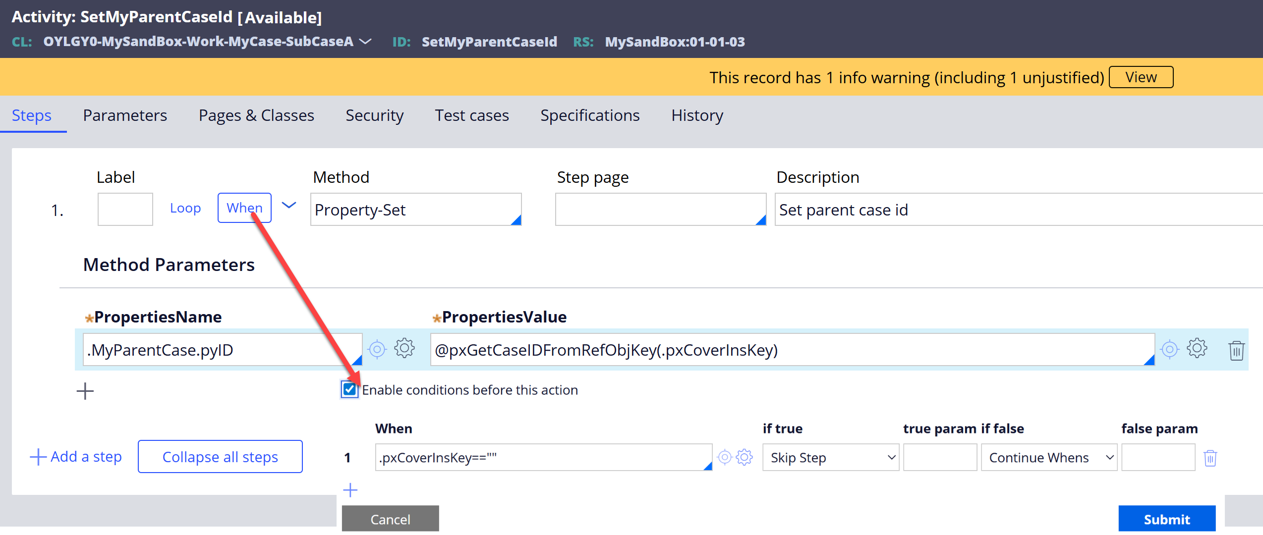

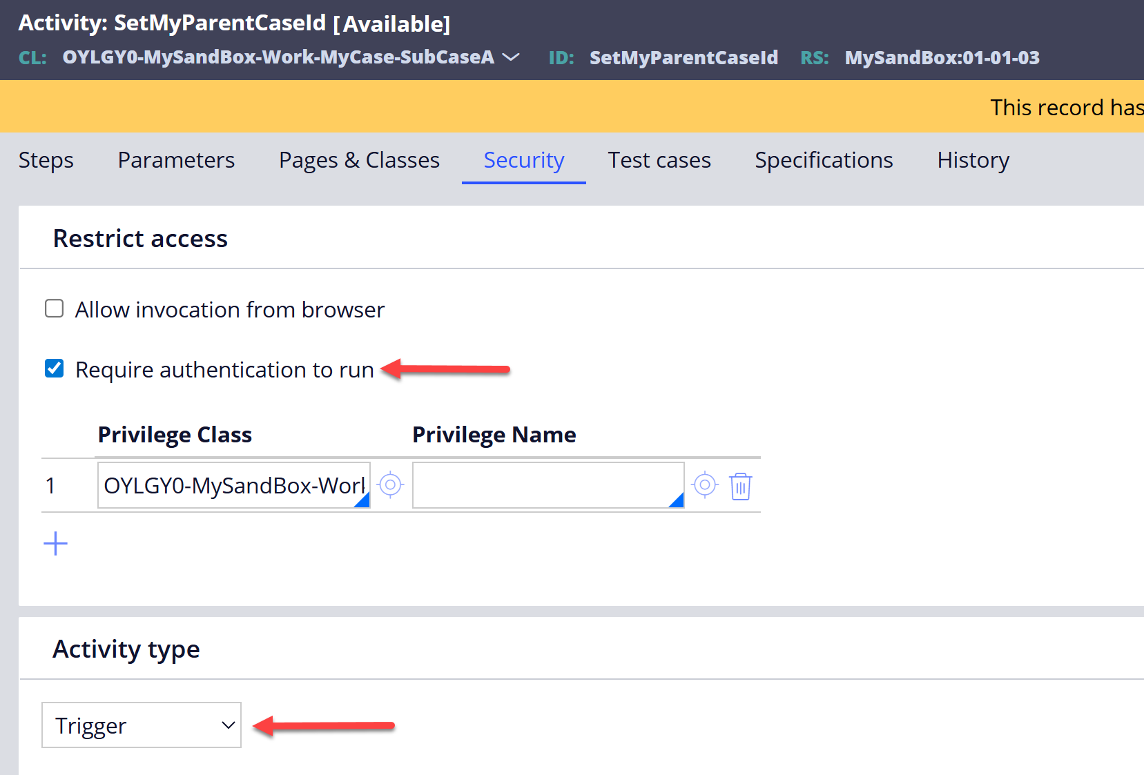

2. Create a Trigger type activity (e.x. SetMyParentCaseId) which sets the case ID of the parent case.

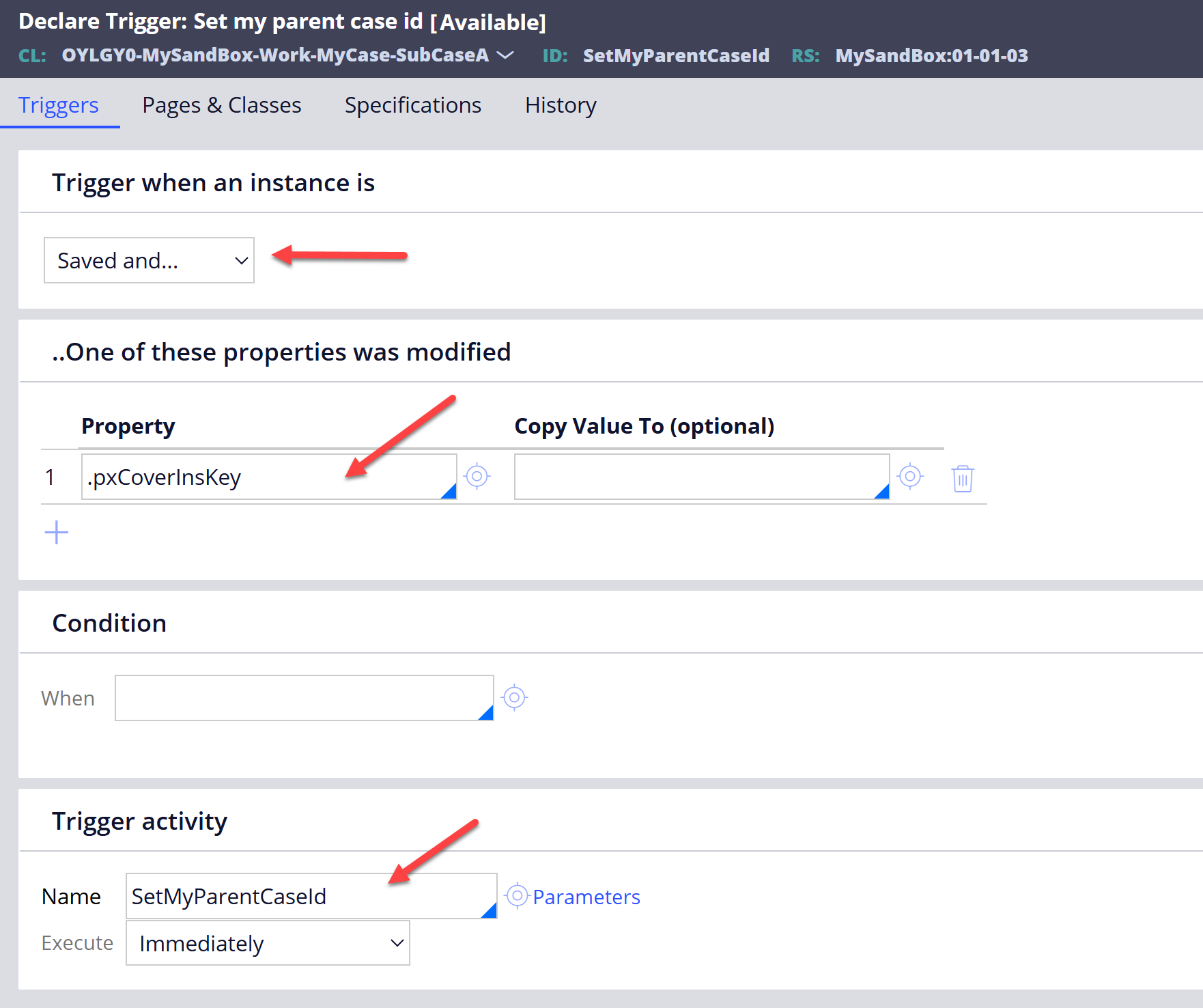

3. Create a Declare Trigger rule which is updating parent case ID whenever .pxCoverInsKey is updated.

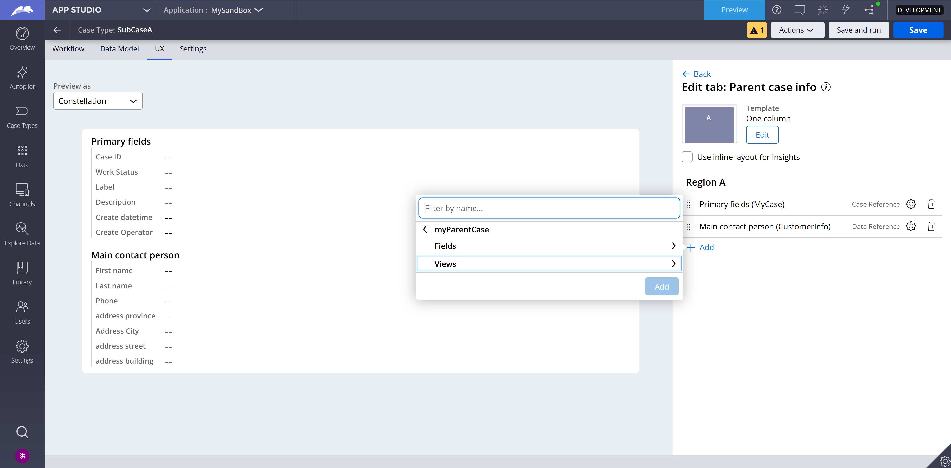

4. Add parent case info via parent case reference field. (you need to drill down to the target view through parent case reference field)
