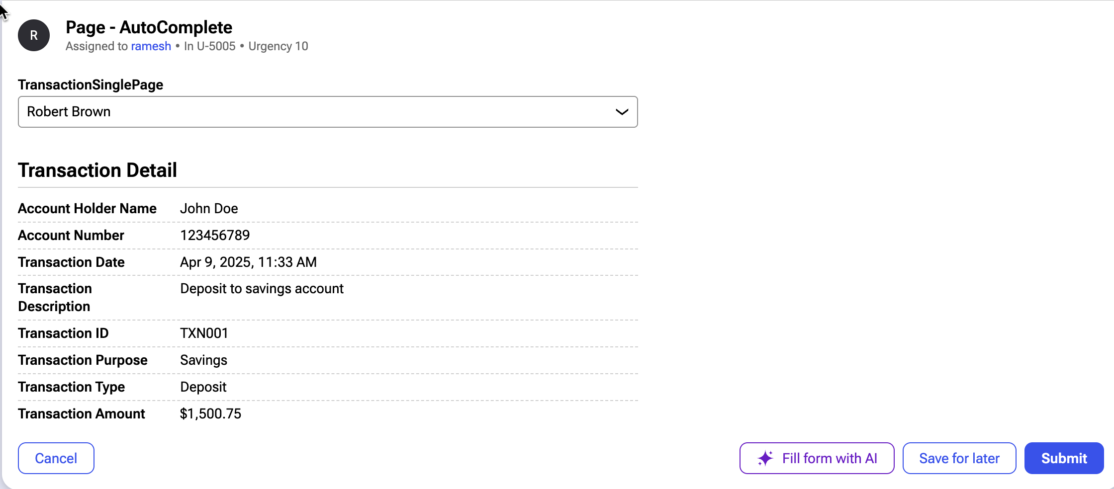

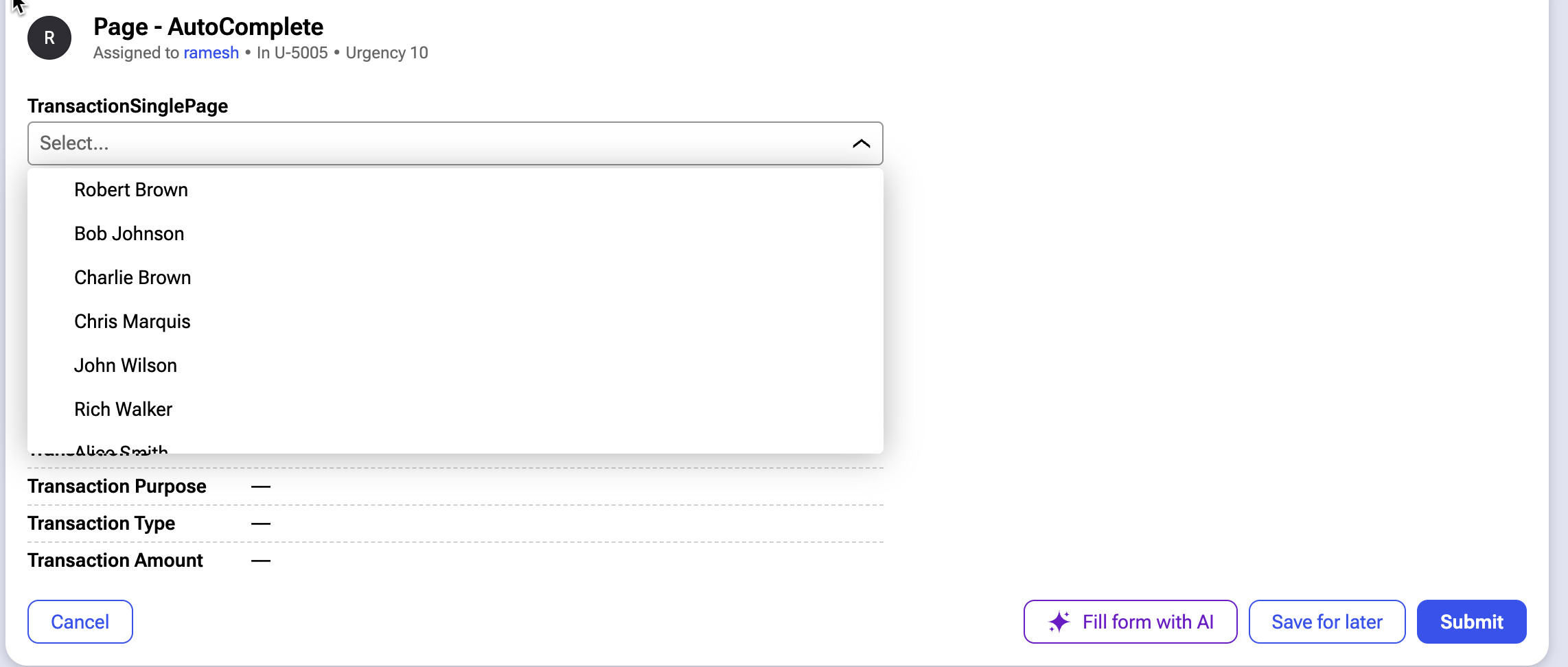

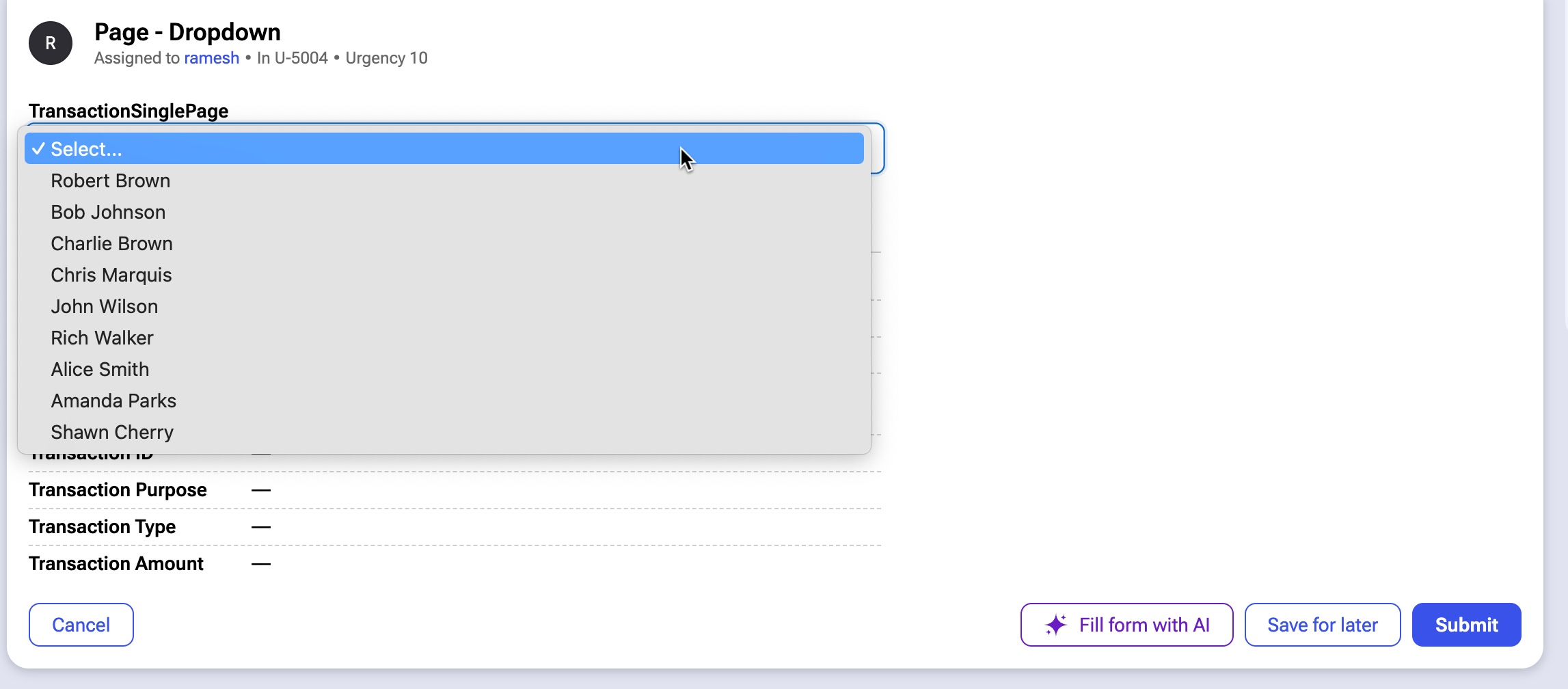

AutoComplete:
Dropdown:

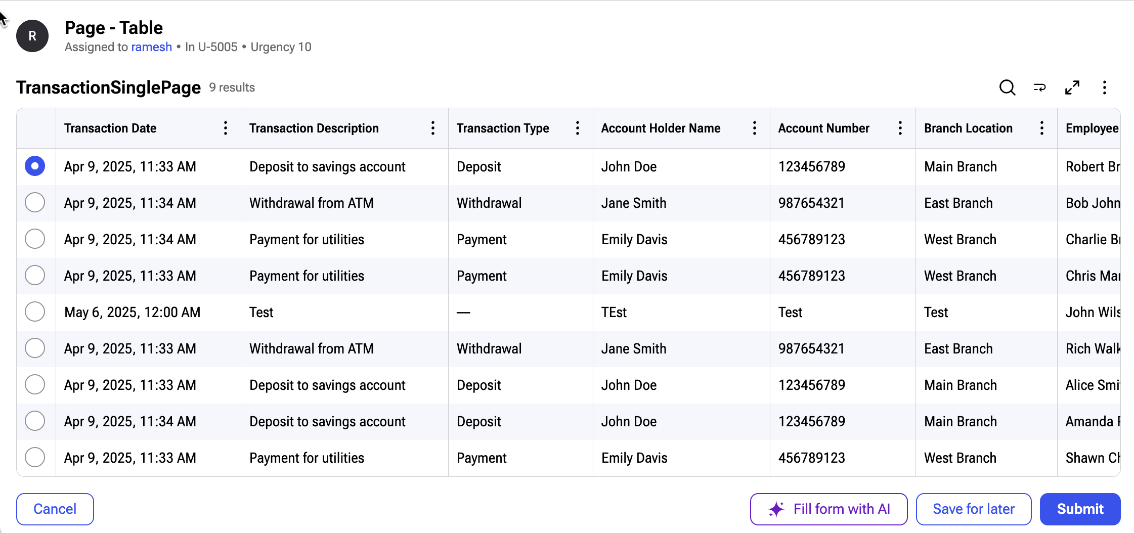

Page - Table:

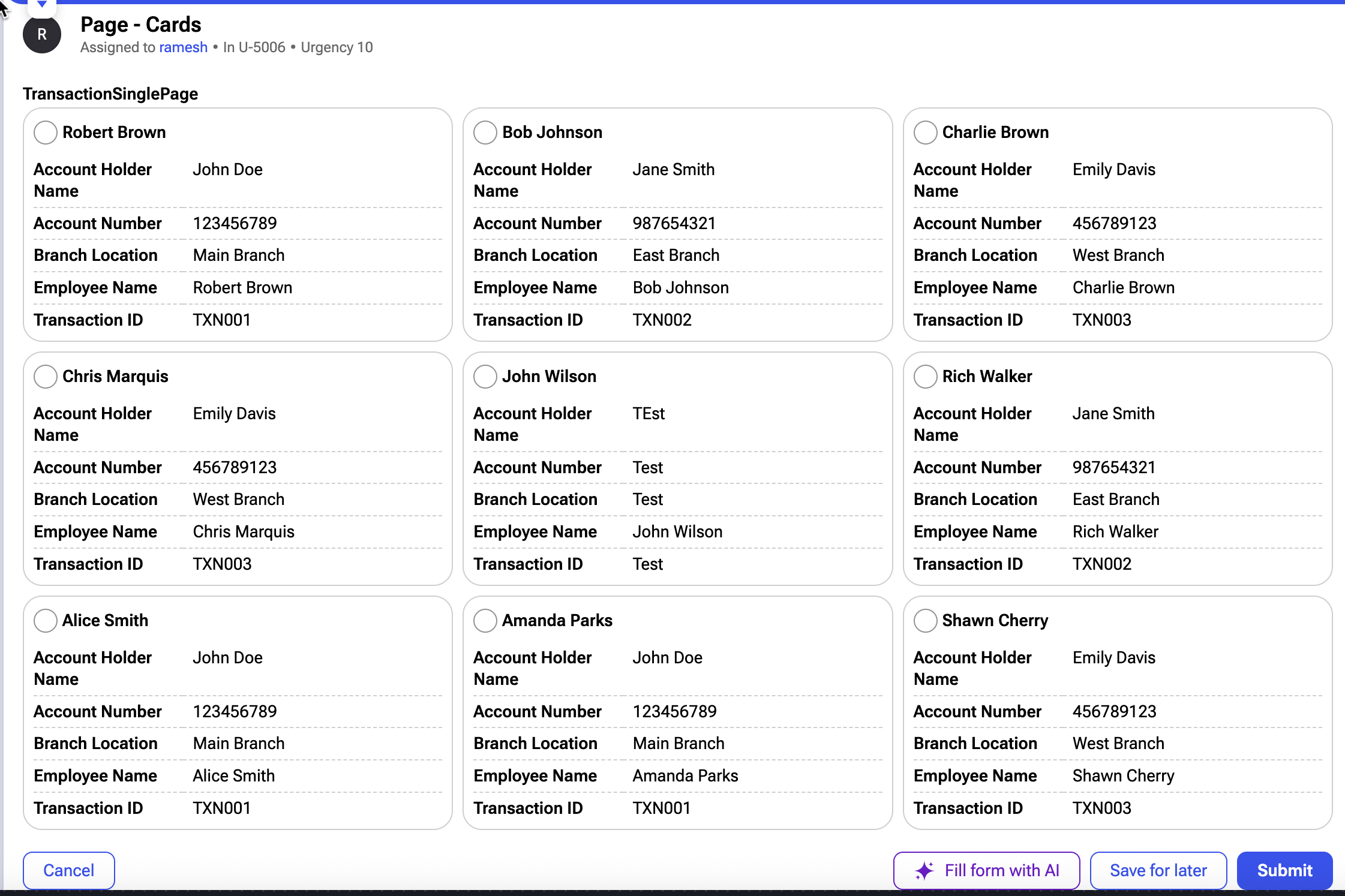

Page - Cards

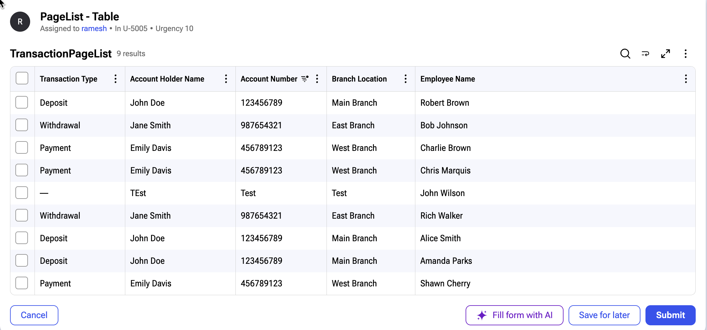

Page List - Table

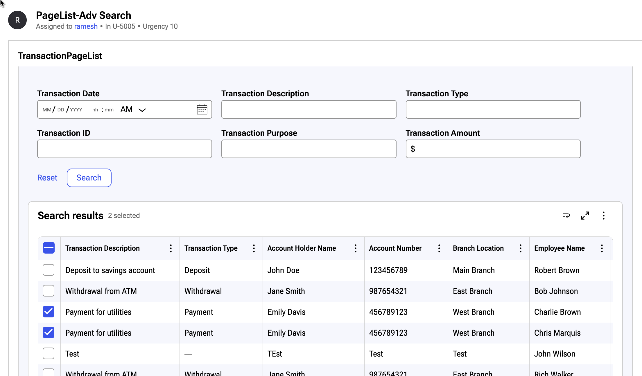

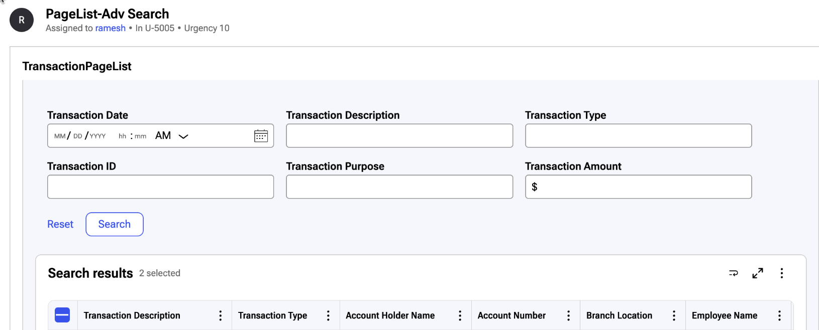

PageList -Advance Search

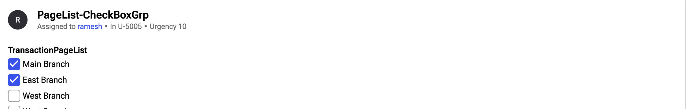

PageList- Checkbox group
