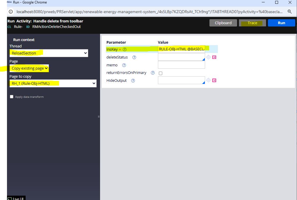

Solution-
1. open the private edit rule from some other operator login and take pzInskey -
a. do the content search for that private edit rule, like below and open the rule which is locked by our operator
b. after opening that rule view XML and copy the pzInsKey
2. check out Rule-.Delete and comment out step 3 as in below activity rule
3. run activity Rule-.RMActionDeleteCheckedOut make sure we are selecting correct thread , pass the pzInsKey that we had retrieved from step 1. and execute this activity.
4. on successful execution can ask that operator to login again
