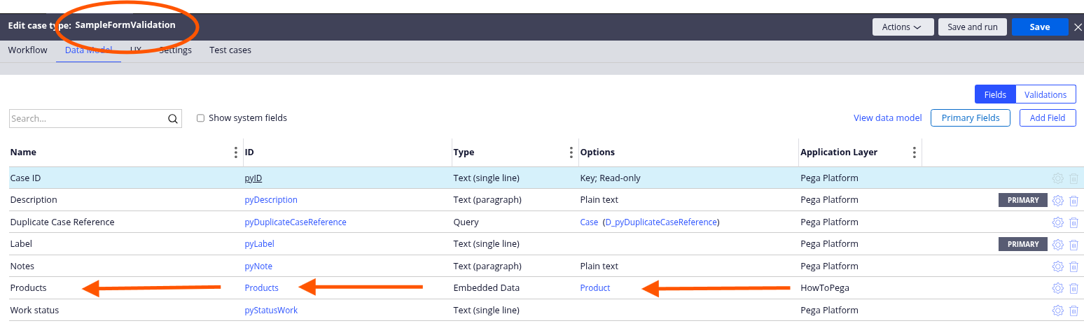

1. Define the Page List Field
First, ensure your case type includes a page list field. This field will hold the collection of data you intend to validate.
As shown in the image above, the Products field is defined as Embedded Data with a Data object of Product and selected as List of records. This configuration allows the field to store multiple instances of the Product data type.

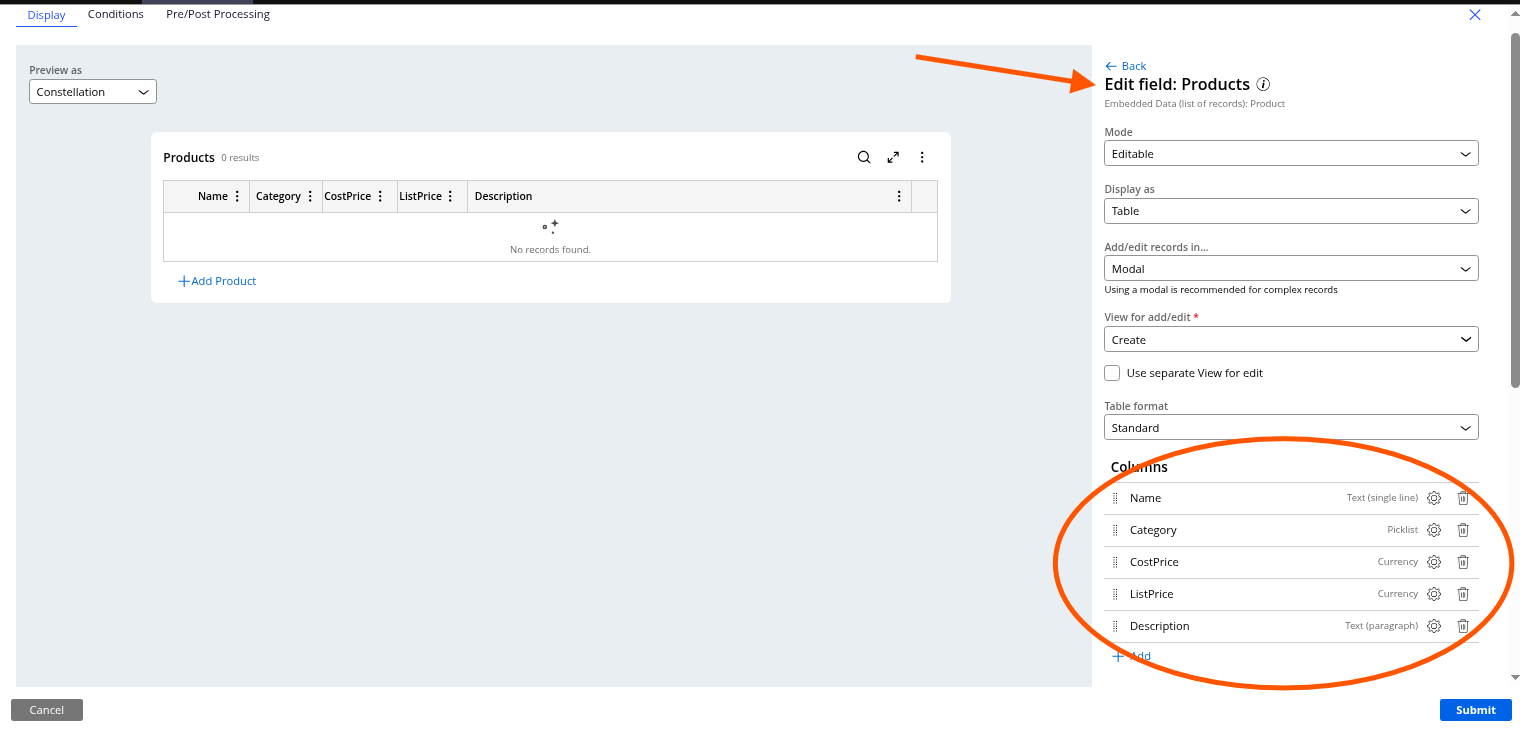

2. Configure the Page List Columns
Next, configure the columns for your page list. These columns represent the individual properties of each item within the list that will be subject to validation.
The Products field, when edited, reveals its constituent columns: Name, Category, CostPrice, ListPrice, and Description. These are the properties that will be validated for each product entry.

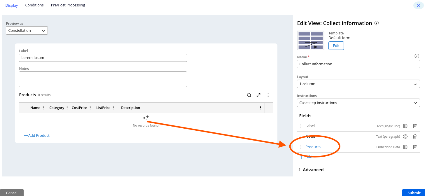

3. Integrate the Page List into the UI
Integrate the page list into your user interface (UI) to allow users to input data. This typically involves adding the page list field to a section or view.
Here, the Products field is added to the Collect information view, making it visible and editable for the end-user.

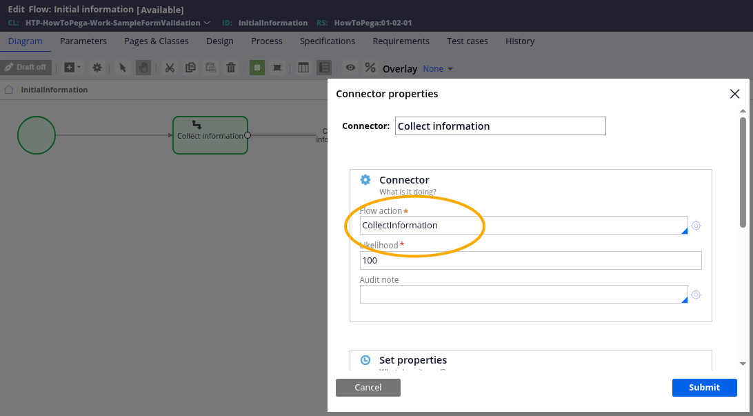

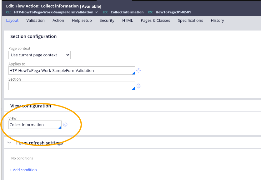

4. Configure the Flow Action
Set up a flow action to handle the submission of the form containing your page list. This action will trigger the validation process.
The CollectInformation flow action is configured to process the data submitted from the form.
5. Link Flow Action to View
Ensure the flow action is correctly linked to the view containing your page list. This establishes the connection between the UI and the backend processing.
The CollectInformation view is associated with the CollectInformation flow action, ensuring that data entered in the UI is passed to the correct processing logic.

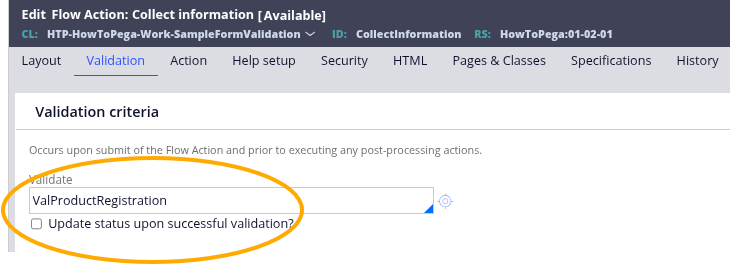

6. Apply Validation to Flow Action
Attach a validation rule to your flow action. This rule will be executed when the form is submitted.
The ValProductRegistration validation rule is applied to the flow action, indicating that this rule will be invoked to validate the submitted data.

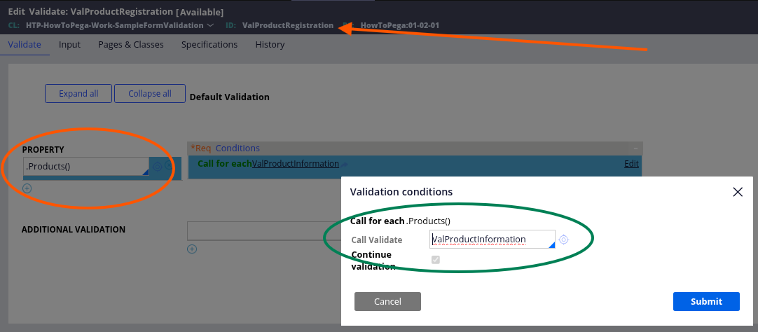

7. Define Page List Validation Rule
Create a validation rule specifically for your page list. This rule will iterate through each item in the list and apply further validations.
Note: this rule is create in the MyAPP-Work-SampleFormValidation class
The ValProductRegistration rule calls ValProductInformation for each item in the Products() page list. This ensures that every product entry is individually validated.

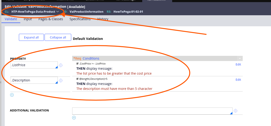

8. Implement Item-Level Validation
Finally, define the specific validation logic for each item within the page list. This is where you set the conditions that each item must meet.
Note: This validation rule is in the MyAPP-Data-Product class, not on the work class.
The ValProductInformation rule includes two conditions: ListPrice must be greater than CostPrice, and Description must have more than 5 characters. If these conditions are not met, appropriate error messages are displayed.

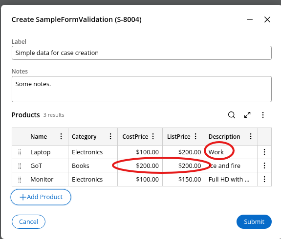

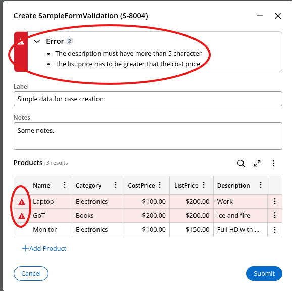

9. Test the Validation
Test the implemented validation by entering data that violates the defined rules.
In this example, the Description for 'Laptop' is 'Work' (less than 5 characters), and the ListPrice for 'GoT' is equal to CostPrice (not greater).
Upon submission, the system displays error messages indicating the validation failures.

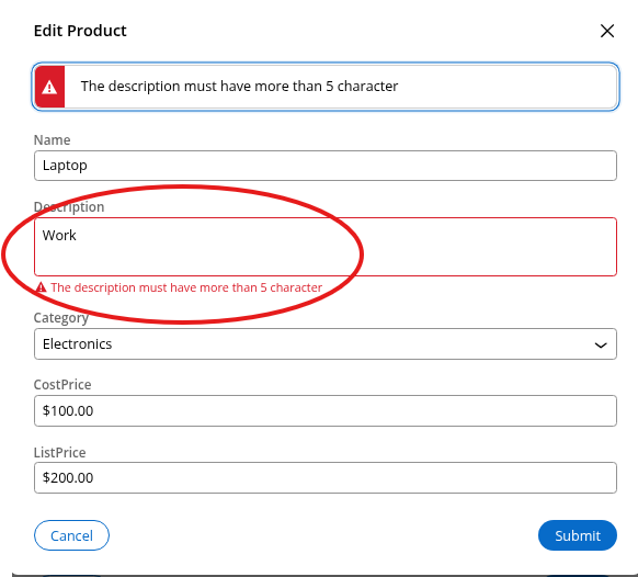

Clicking on the 'Laptop' item reveals the specific error: "The description must have more than 5 character."

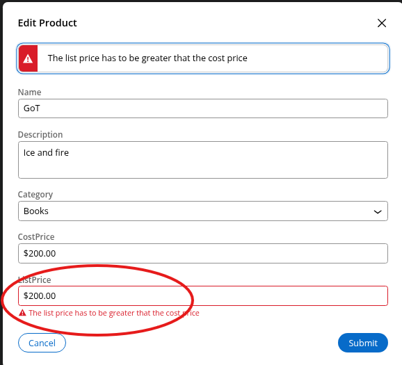

Clicking on the 'GoT' item shows its specific error: "The list price has to be greater than the cost price."

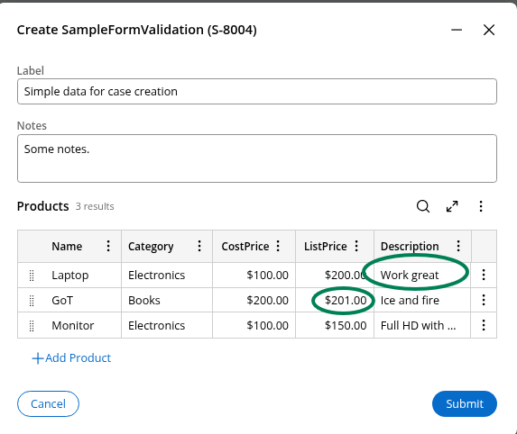

10. Correct and Re-test
Correct the invalid data and re-submit to ensure the validation passes.
After correcting the Description for 'Laptop' to 'Work great' and ListPrice for 'GoT' to '$201.00', the form can be successfully submitted.
The form now submits without validation errors, confirming the successful implementation of the page list validation.
