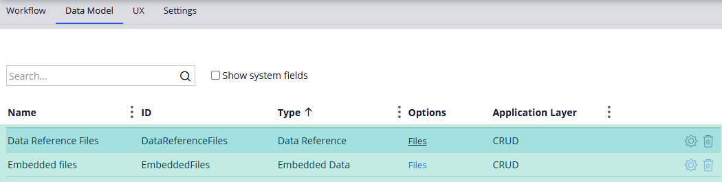

To showcase preselection, the workflow includes two fields based on File data class. This configuration helps to clarify the differences between managing data that is embedded directly in the case and data references that access other sources.

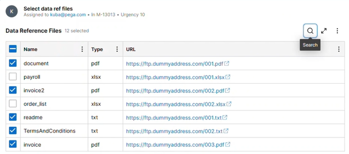

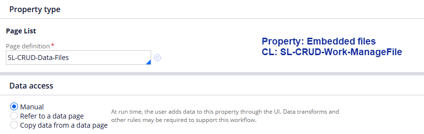

Let's begin with the Embedded Files field. Since this is a property requiring manual data access, it must first be populated with data saved within the case itself. Note that embedded fields do not provide an out-of-the-box multi-select input mode. Therefore, the IsSelected Boolean property defined in the File data class will be used instead.

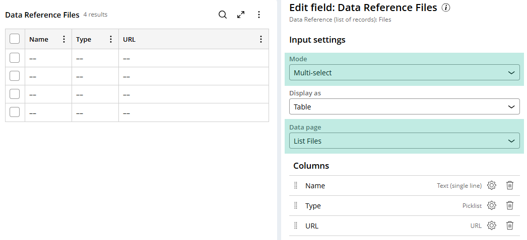

The situation differs for the Data Reference list. This list does not require options stored within the case, as it sources from a list structure Data Page. The Data Reference Files field actually stores a list of references (pyGUIDs) to the D_Files Data Page. Hence, the whole table displayed in the user interface is not stored within the Data Reference Files—only selected items are stored. The IsSelected or pySelected properties are not applicable here; instead, the Data Reference Files list will be populated with pyGUIDs that should be pre-selected.

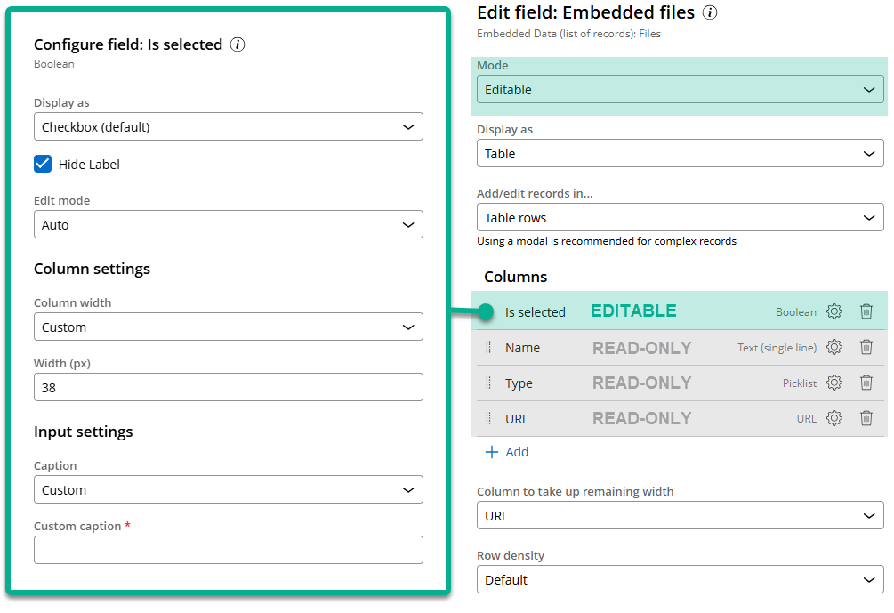

Because the IsSelected column is used to mark selected items, the entire Embedded Files field is set up as an editable table. The other columns are read-only to prevent any alterations to the data (unless your specific solution requires it).

The configuration of the Data Reference view is relatively simple, as it leverages Constellation's multi-select mode. The table is populated from the List Files (D_FilesList) data page, which uses dummy records added during the creation of the File data object.
