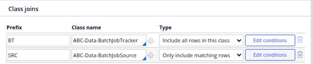

- New Report BatchReportForJobID - this report must have Join to Tracker Table ABC-Data-BatchJobTracker (where JobID is the unique ID of the Batch Job)
- Optional Source table ABC-Data-BatchJobSource- the items to be processed can be either selected based on the Report Definition conditions, or if we want to process only specific Cases/records, then we can list them in the Source table and join the Report Definition to the Source table
Below an example of Joins in the Report Definition, where ‘BT’ is abbreviation for Batch Tracker table and ‘SRC’ is abbreviation for Source table

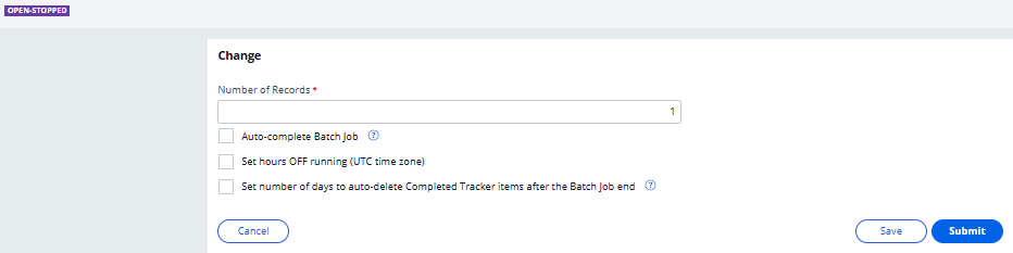

- Change- possible if Batch Job Case status is ‘Open-Stopped’ and User wants to change some parameters e.g. Number of records (Note: the basic parameters like Report Name cannot be changed)

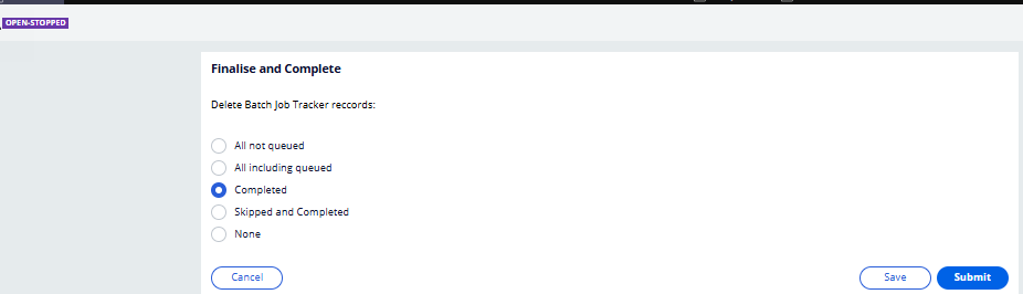

- Finalise And Complete– possible if Batch Job Case status is ‘Open-Stopped’ or ‘Pending-Completion’. Changes Batch Job Case status to ‘Resolved-Completed’. Used if User does not want to wait for auto-finalizing of Batch Job and wants to decide manually which Tracker records should be deleted

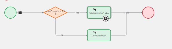

If checkbox ‘AutoComplete’ is selected and option ‘At specific time’ is selected, User needs to provide DateTime when the Batch Job should be completed. This is implemented by Decision Shape and Assignment with SLA.
If checkbox ‘Auto-complete Batch Job’ is selected and option ‘When all items are processed’ is selected, the flow of Batch Job Case is resumed in activity ‘QueueBatchJob’.

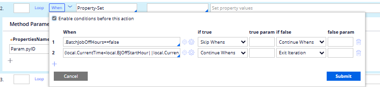

In the main activity of Job Scheduler, when looping through all ‘Open-Active’ Batch Job Cases, if checkbox ‘Set hours OFF running’ was selected, additional condition should be implemented , checking if the current hour is not included between OFF hours. If the current time is within OFF hours, the iteration should be skipped

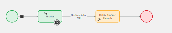

If Batch Jobs deal with thousands of records, the Tracker table will quickly become filled with a lot of data. This is why it is important to make sure that old Tracker records are deleted. This can be achieved by using parameter ‘Set number of days to auto-delete Completed Tracker items after the Batch Job end’ where User can provide the number of days after which, all Tracker items in status ‘Completed’ for the specific Batch Job will be removed. This is done by Assignment with SLA in Case type stage ‘Finalise’. The SLA value can be calculated in the Data Transform. If parameter ‘Set number of days to auto-delete Completed Tracker items after the Batch Job end’ is not provided by User, then SLA is calculated with default value of number of days set in Dynamic System Setting.
There is also alternative way to delete Tracker records by selecting case wide action ‘Finalise And Complete’. It can be selected if User does not want to wait for auto-finalizing of Batch Job and wants to decide manually which Tracker records should be deleted
