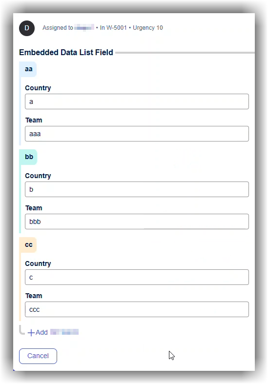

Repeating views in Constellation display a colored left border for each row header.
Symptoms and Imact
Symptoms that manifest include the following:
The colored bar is visible only in editable repeating views.
Read‑only repeating views behave differently.
There are no explicit theme controls to remove or configure this behavior.
Colors vary per row item, giving the impression of semantic meaning.

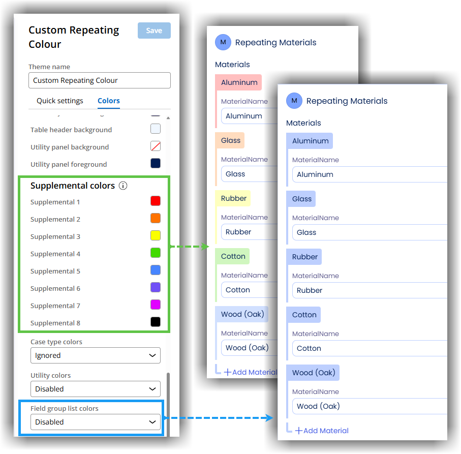

The new design in Pega Infinity™ '26 has a toggle in theme authoring for repeating view colors to disable the colors so that the borders are the same. Supplemental colors control data visualization color series and table grouping indicators.
Additionally, if enabled in this theme, they may also affect Cases and Data Objects, Field group lists, and Utility widgets. Utility colors are relevant for the utilities section in a case view. For example, the Attachments "paper-clip" icon, the Followers icon, the Tags icon, etc. These inherit from supplemental colors.
