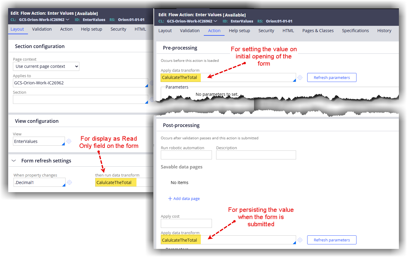

These symptoms can be avoided by implementing the best practice of using pre / post processing in the flow action.
To mitigate any problems, use one of the suggested configurations below:
Solution 1
Consider any form refresh update to a read-only field as "for display only". If the read-only value needs to be submitted, then this should be done in the flow action post processing to perform the same calculation as the form refresh setting on the data submitted with the form.
For further details, see Configuring post-processing for a Flow Action
