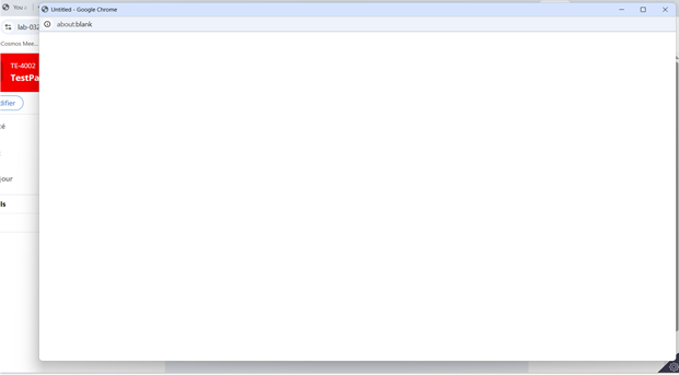

After updating to Chrome v135.0.7049.42, an empty pop-up window (without any file) for downloads is displayed. However, the file gets downloaded and can be viewed from the Downloads tab in the browser.
Refer to the following image:

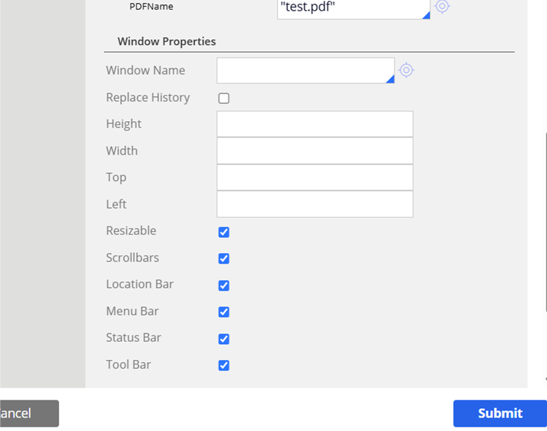

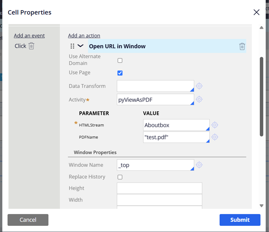

- or, in the open URL in window configuration widget, change the window name to “_top” to avoid the pop-up window from appearing. Refer to the following image for details:
- or, modify the window properties, to save the downloads in a new tab. Refer to the following image for details:
