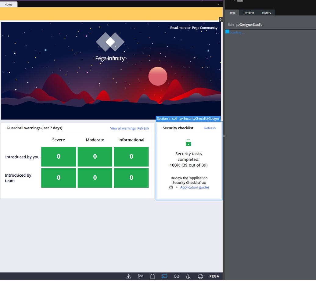

After the release of Chrome version 139.X.X (built on Chromium), users experience failures when launching the LiveUI inspector in Pega applications when using a content security policy (CSP) in the application.
Symptoms and Impact
After opening Live UI, the tree panel does not display any values and constantly displays status "Loading..." .
When launching Live UI with the tree panel expanded, the Console displays a log error:
“Refused to create a worker from 'blob:https://example.com/baff24461dfc' because it violates the following Content Security Policy directive: "child-src 'self'". Note that 'worker-src' was not explicitly set, so 'child-src' is used as a fallback.”
Developers are unable to use Live UI for troubleshooting, which is critical for diagnosing and resolving platform issues.

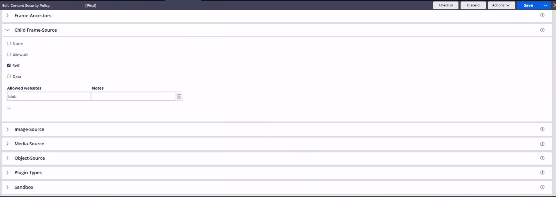

For applications using custom CSP
Use a workaround to add “blob: “ URL’s to the list of Allowed websites in the CSP. Add these to the child-src directive in the CSP rule mapped to the application along with Self option.
Log into Dev Studio
Go to -> -> .
Locate and select the configured CSP policy name used by your application.
There are two types of configurations the user can make at this point:
Configuration 1:
This is our recommended configuration as it is the most secure:
In the Child Frame-Source section, add "blob:" to the list of allowed sources.
The updated directive should include both Self and 'blob:' to maintain security while enabling Live UI.
Configuration 2:
This is for scenarios where your business requires that you use the option Allow-All instead of Self for the child-src directive:
- Select the option Data in the Child Frame-Source section. Enabling the Data checkbox implicitly enables the "blob:" directive.
