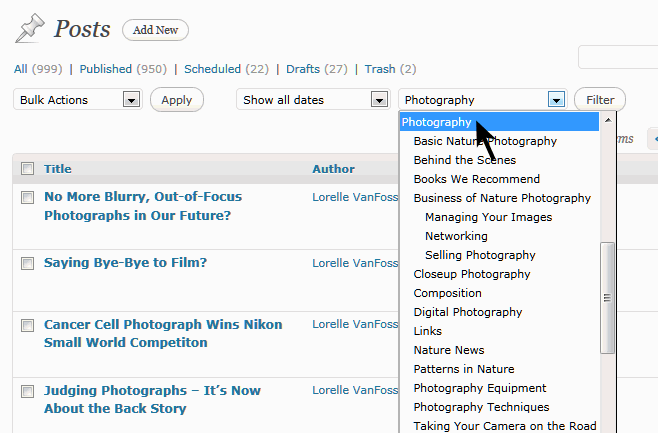

I wanted to ask if there are any plans to implement option to select multiple rows in a grid repeat layout.
My feeling is that we had this option in list view but I'd really like to stick with the latest controls. Would that be something we are working on? Is there any temporary workaround to archive this without messing up the configuration much?
The use case is pretty obvious - we want to edit / delete / action multiple items in a grid without having to go one by one.
Example from WordPress:
Thanks a lot for your help!
-Jiri

Ah ok, so you are just talking about the highlighting rather than actual selection? The highlighting is currently only for row hovering as far as I can see.
I have tested using pySelected and can select multiple rows, I can see the pySelected values on the clipboard. I can also configure a button to run a data transform to check all the rows... but I guess this isn't actually what you are asking about.
Yes, you can configure this in the skin rule. It works fine for us - unfortunately, only for one item at a time (it's ignoring selected state of checkbox).
Exactly. It's about the fact if we are planning to introduce this selection somehow OOTB. If it was planned, I guess the highlighting would be built in (or at least Pega could add a CSS class... something like gridCellMultipleSelect).
