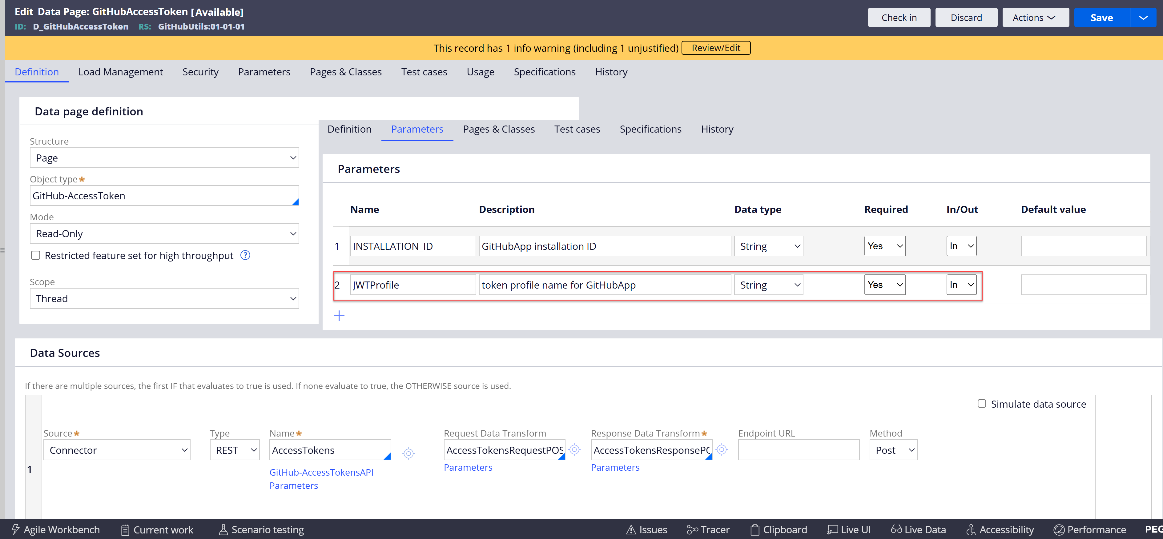

6. Obtain Installation Access Token using GitHub App's Installation_ID and JWT token
provide INSTALLATION_ID and JWTProfile definition for data page: D_GitHubAccessToken.
if the data page executed successfully,
.token: contains access token which can be used as authentication bearer for api calls
.expires_at: contains timestamp when token will expire.
D_GitHubAccessToken[INSTALLATION_ID:param.INSTALLATION_ID, JWTProfile:param.JWTProfile].token

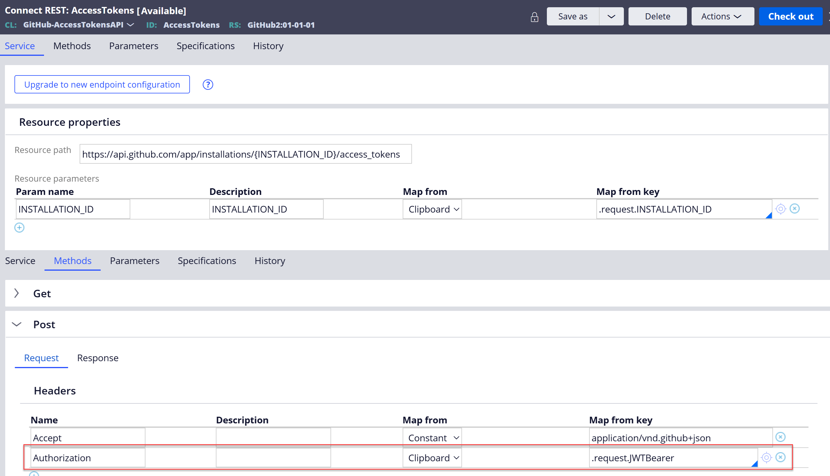

7. Create REST connector for GitHub REST API endpoint (e.x. Create an installation access token for an app)
- Please follow steps described here: Creating a REST integration by using the Create REST integration wizard
- Add parameter: "JWTProfile" to automatically created Data Page for the endpoint

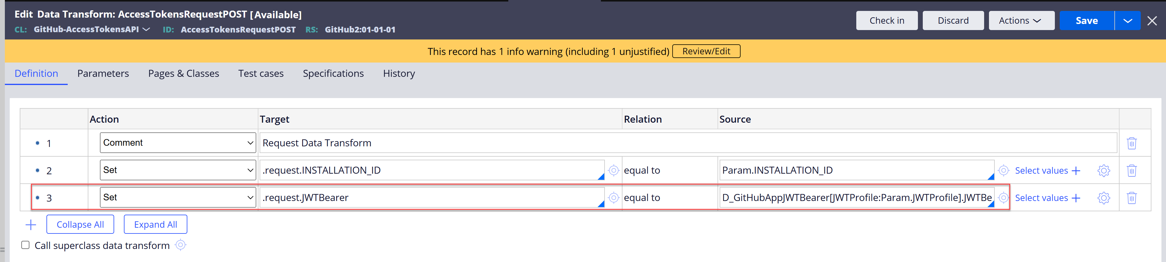

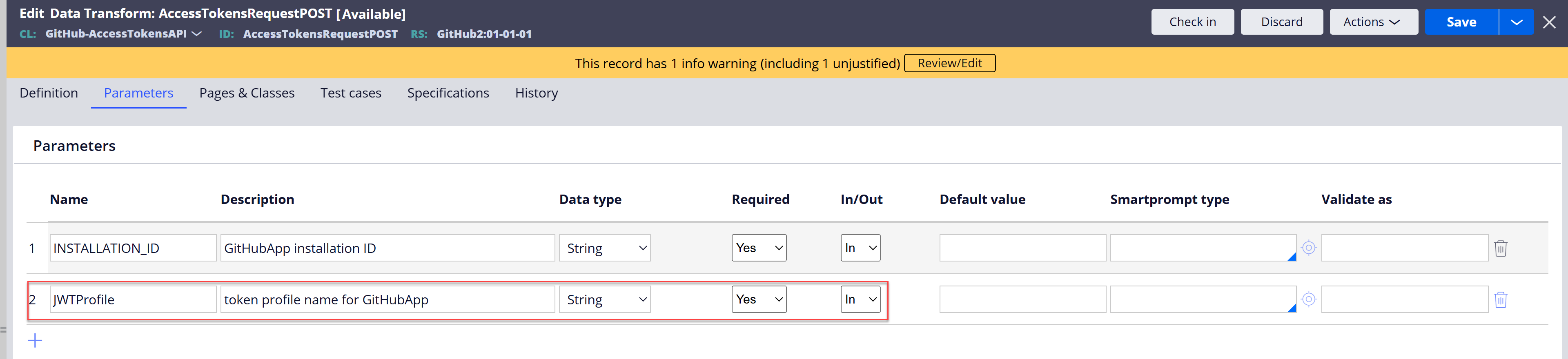

- Add parameter: "JWTProfile" to automatically created Request Data Transform for the endpoint

- Add HttpHeader: "Authorization" to the connector rule and map its value from Clipboard.
- Update Request Data Transform to set ".request.JWTBearer" value.
