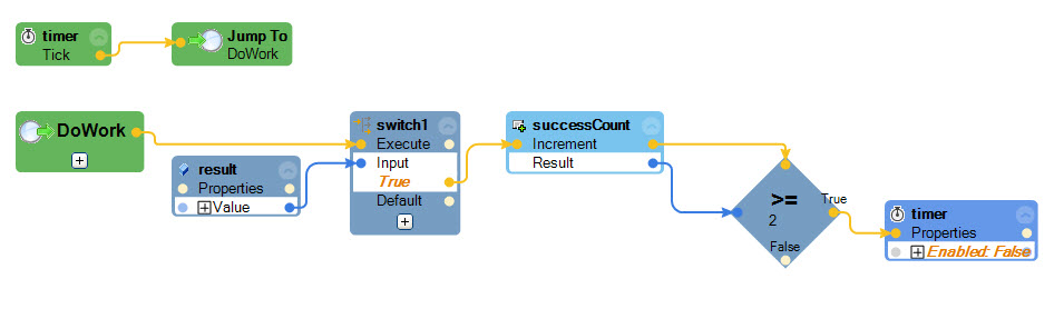

Hi Jeff,

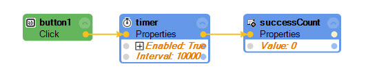

I'm looking to build an automation where the end user clicks a start button and then at set intervals of time the automation automatically runs and completes a set of actions. What would be the best way to do this? After a set number of completed successful runs the automation would then exit itself.
Dave
Hi Dave,
This is done by causing the button click to start a timer. Each time the timer fires (at your chosen preset interval) run your automated process. You can track the number of successful runs using a global variable. Each time to increment the variable you would check to see if you had completed the necessary number of successful runs. When that number is achieved, disable the timer.
Jeff
Endsleigh
Thanks Jeff, I'm still struggling to visualise this and get it to work. Are you able to possibly put an image on showing how this would work in practice say for 2 iterations.
Dave
Hi Dave,
When the button is clicked you set up the timer and initialize your success counter (this runs every 10 seconds):
Now when the Timer Tick event fires you do some work and record the results:
Notice that when success is achieved we test to see how many times we have succeeded. If the number is 2 or greater then we disable the timer.
Jeff
Endsleigh
Thanks Jeff, worked a treat now I can visualise it better :)

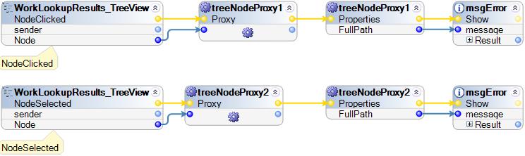

Hi Jeff,
Thanks for your earlier response. I have another question for you.
I have a treeview in one of the applications I am interrogating, and I need to select the top most node in the tree. How would I do this?
I can see a SelectNode method, which allows me to type a path in, but I have no idea what path it is looking for.
I have tried looking here but I can't find an answer.
Ryan

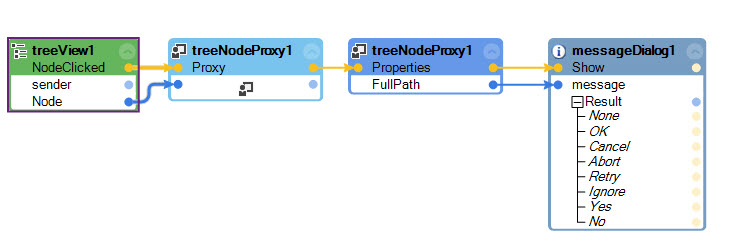

Hi Ryan,
To find out the path required, add an event handler for NodeClicked. This will return a proxy for the node you click. Extract a proxy from the event block and send the FullPath property to a message box. Then all you have to do is click the node you want the path for. On the treeview properties you can also look at the PathSeparator property. That will help you construct a path.
Here is an example of the NodeClicked automation:
Jeff
Endsleigh
Hi Jeff,
I've tried to implement your solution but nothing happens. I've put in some breakpoints and it seems that NodeClicked is not triggering. I've also tried NodeSelected but this doesn't work either. Would you have any advice on this?
Here's what I've tried:
I have checked that the treeview is matching and it does seem to be, during interrogation.
I only wish to select the top parent node in the list, as my automation will then work on this and remove it from the list, and then work on the next top item in the list.
Ryan
Hi Ryan,
Are the nodes initially on the treeview when it is created or do they populate at a later time?
Jeff

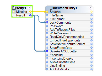

Hi Jeff,

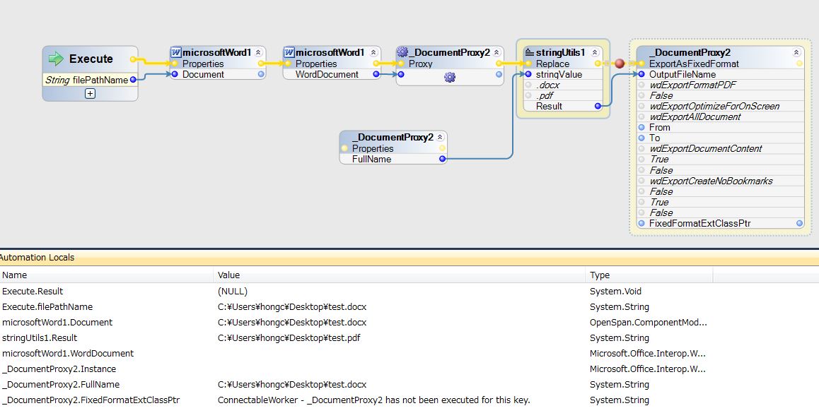

I am using Office 2013 and there is "export/PDF" feature which is very handy to covert a word document to a PDF.
Is it possible to use OpenSpan control "Microsoft word connector" to convert word document to a PDF ?
Chunzhi
Hi Chunzhi,
The Word Connector gives you direct access to the ActiveDocument object. This is accessed using the WordDocument property of the connector. You need to extract a proxy from this property. Extracting a proxy returns a complex object with all of the properties, methods and events available. This is how you work with properties that are not simple objects. The proxy will have a method available for exporting to pdf. To better understand what you can do with that object, please refer to the documentation found on MSDN for Microsoft.Office.Interop.Word (https://msdn.microsoft.com/EN-US/library/microsoft.office.interop.word.aspx).
Jeff
JP

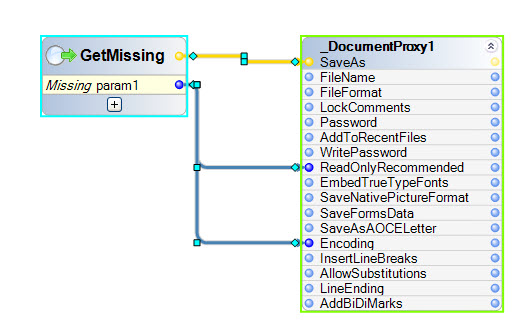

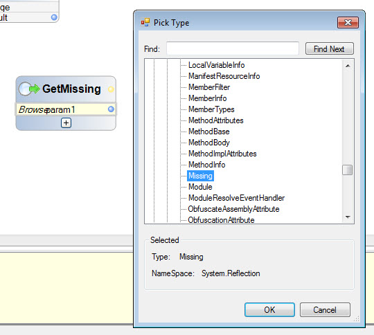

Hi Jeff,
I got "value does not fall within the expected range." error when I was trying to use "ExportAsFixedFormat" method provided by the proxy.
Somebody suggested using "System.Reflection.Missing.Value" instead of null for the last argument "FixedFormatExtClassPtr" to avoid this issue.
So how can I make a reference to System.Reflection.Missing.Value in my OpenSpan automation as below ?
Hi Jeff,
2) Exception Information
Exception Type: System.ArgumentException
Message: "value does not fall within the expected range."
ParamName: NULL
Data: IDictionary (System.Collections.ListDictionaryInternal) with 0 items
TargetSite: Void ExportAsFixedFormat(System.String, Microsoft.Office.Interop.Word.WdExportFormat, Boolean, Microsoft.Office.Interop.Word.WdExportOptimizeFor, Microsoft.Office.Interop.Word.WdExportRange, Int32, Int32, Microsoft.Office.Interop.Word.WdExportItem, Boolean, Boolean, Microsoft.Office.Interop.Word.WdExportCreateBookmarks, Boolean, Boolean, Boolean, System.Object ByRef)
HelpLink: NULL
Source: "Microsoft.Office.Interop.Word"
StackTrace Information
at Microsoft.Office.Interop.Word.DocumentClass.ExportAsFixedFormat(String OutputFileName, WdExportFormat ExportFormat, Boolean OpenAfterExport, WdExportOptimizeFor OptimizeFor, WdExportRange Range, Int32 From, Int32 To, WdExportItem Item, Boolean IncludeDocProps, Boolean KeepIRM, WdExportCreateBookmarks CreateBookmarks, Boolean DocStructureTags, Boolean BitmapMissingFonts, Boolean UseISO19005_1, Object& FixedFormatExtClassPtr)
Hi Chunzhi,
You can use a Jump Label to create types like this.
Jeff
JP
Hi Jeff,

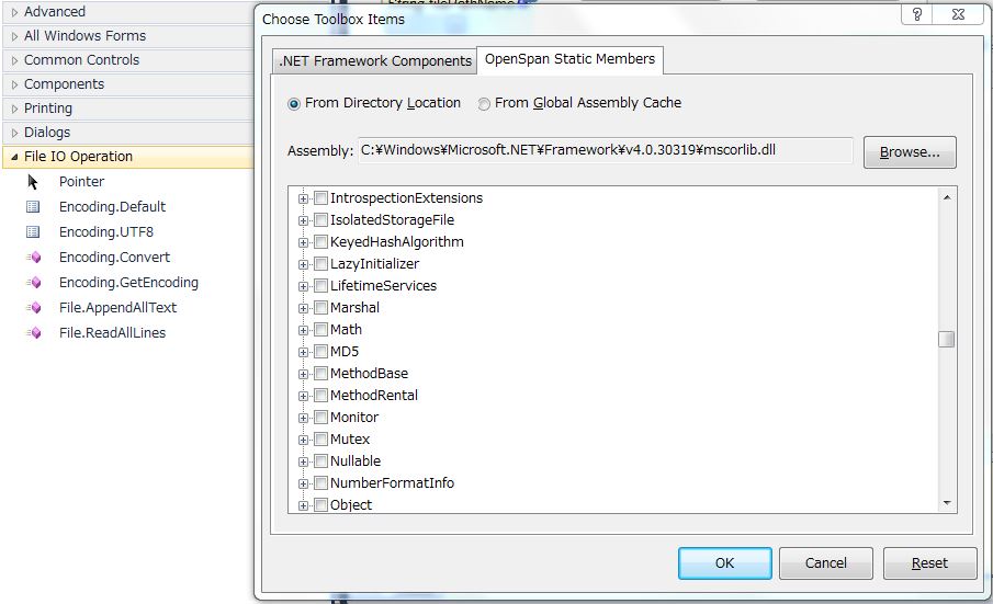

I just tried your approach, however it didn't work. I think a parameter of type "System.Reflection.Missing" does not provide default value as "System.Reflection.Missing.Value", if the parameter is not set.
"System.Reflection.Missing.Value" is a predefined constant value and what I wanted to do is setting this constant value to the last parameter, "FixedFormatExtClassPtr", of "ExportAsFixedFormat" method.
I was trying to add "System.Reflection.Missing.Value" to the ToolBox but was not able to locate "Missing" class in mscorlib.dll.
Chunzhi

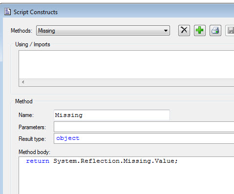

Hi Chunzhi,
You can always use a script to create an object of the type you are needing.
Jeff
JP
Hi Jeff,
The script worked perfectly and I am able to convert word document to pdf now.
Many thanks!
Chunzhi

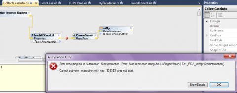

Hi Jeff!

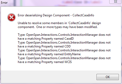

I'm trying to add some custom context values into my interaction.xml in order for them to show up on my AgileDesktop. Right now I'm able to have the values show up on the AgileDesktop and as valid properties in my Interaction Manager object; however, when I try to debug, I get an error saying the property can't be recognized. I already tried Build>Clean and restarting my solution. This error also happens when I remove existing context values from the interaction.xml. If I used those context properties at any point in the past (and have since deleted them from my solution), OpenSpan will try to look for them and give me error warnings about missing objects. I've made changes to the interaction.xml before and the changes applied just fine. Not sure if this is a caching issue or I'm just missing something.
See error message. I get this after I've added the properties to the Context section in the xml and incorporated them into my InteractionManager property block.
Hi Jeff!
Thank you!
Hi Ejbi,
When you make changes to the Interaction.xml, you need to do a set process to ensure that those changes are recognized by the solution.
Save the changes to the Interaction.xml
Each container in your solution where an InteractionManager component exists must be made dirty – the change to the Interaction.xml does not do this automatically.A simple way to do this is to add a variable to the container and then delete it .
Save each container once it has been made dirty. This will cause the InteractionManager component to pick up the changes to the Interaction.xml.
Clean your solution.
Build your solution – the changes should be reflected.
This process is time consuming for sure and has been addressed. In a release in the near future you will not need to go through this process. Stand by for the new process.
Jeff

Accenture

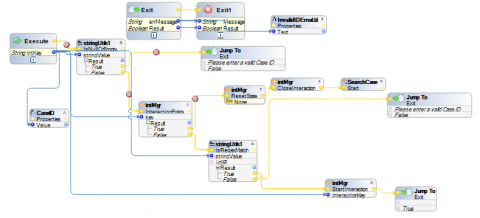

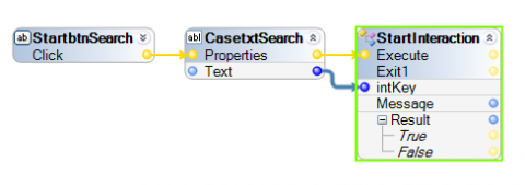

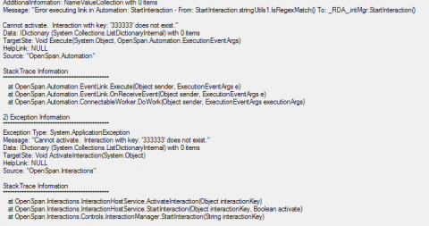

Hi Jeff,
Thanks for your earlier response. I was doing all the steps you mentioned already and for whatever reason, it would work sometimes but not all. I guess until we get the new release, I'll leave it alone since making changes will break whatever automation was using those Interaction properties.
As far as starting an interaction, I'm creating an App Bar that allows me to search for a number ID and depending on whether the number is valid, it'll either grab the data from that ID or end that interaction. Right now, I keep getting this error when trying to close the interaction after entering the wrong ID. I'm not sure why it is still looking for the wrong key of "333333" after I've already gone through the CloseInteraction block. Note this error pops up after all the blocks have been executed in the screenshot.
Hi Ejbi,
When you get an exception message click the Show Details button to get the full text. If you careful read the text of the message here, the exception is happening in the StartInteraction automation. We would need to look at that automation to see what the issue is.
Jeff
Accenture
Hi Jeff,
I'm not sure why it's going back to the StartInteraction as that is invoked by a button click, but I could be missing something. I've attached two automations related to this if that helps. The automation in the screenshot I posted earlier is invoked by an InteractionStarted event block after the StartInteraction automation. I would think that the CloseInteraction block would prevent the flow through StartInteraction automation again.
Hi Ejbi,
This is a little difficult to read, but to truly get to the bottom of this you should look at the logs and the solution together. See the previous post on the lines you should extract from the log to understand the automation flow and the values that are being assigned. Some additional log lines you will want to observe:
- Category - InteractionHost
- Lines containing "Interaction started" - this will give you the key value of the interaction
- Lines containing "Interaction activated" - this will give you the key value of the interaction activated
- Lines containing "Could not remove interaction" - this message appears when attempting to close an interaction and will list the key of the interaction closed

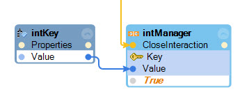

There are issues that I can see here. For one, the CloseInteraction would not work here as the key that you are using upstream to select an interaction is set to None.
Jeff
Accenture
Hi Jeff,
There are 3 automations currently. The automation order goes:
1)SearchCase -> 2) StartInteraction -> 3)CollectCaseInfo.
In my original post, I'm getting through CollectCaseInfo where the automation learns that the ID doesn't invoke the correct info page and therefore, the ID is not a valid ID. That should trigger the "Unsuccessful Data Collect" message and CloseInteraction so I can do a new search. The error occurs right after the CloseInteraction and the message is saying the execution error occurs between StartInteraction.StringUtil and the intMgr.StartInteraction() which are both in the "StartInteraction" automation. I don't understand why it's going back to that part when it's already passed it. I added breakpoints between those and the break only occurs the first time it goes through, so I'm not sure where the automation is when the error happens. Please see attached for the detailed error. I tried feeding the key value into the CloseInteraction block, but that didn't work.
Hi Ejbi,
Could you take screenshots of your automations and post the full size images here? If there are only three we should be able to figure this out.
Jeff
