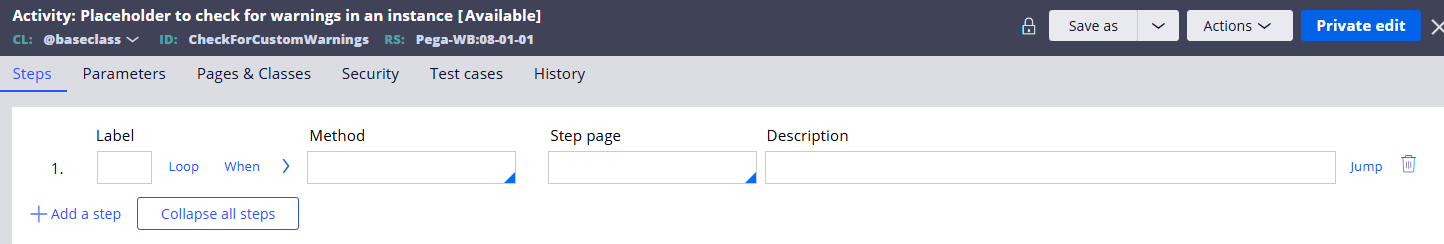

Step 1: Open the OOTB @baseclass.CheckForCustomWarnings activity rule.
This is the extension point.

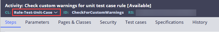

Step 2: 'Save As' the activity to the 'Rule-Test-Unit-Case' class.
This is the rule type where we need to create the new client-specific warnings.
Note: The target class will be different based on your rule type. For example, if you want to create a new custom warning for Data Transform rule type, then save the activity to the 'Rule-Obj-Model' class.

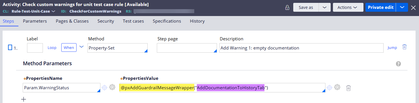

Warning 1 (Missing documentation): Configure a logic to throw SEV3 (Informational) warning if the description and usage of unit test case rule are both empty.
Call an OOTB function, @pxAddGuardrailMessageWrapper (in yellow), and pass the message rule (in purple).
In the WHEN pre-condition of Step 1, enter the following code to execute the step (if True) or skip it (if False).
@trim(.pyDescription) == "" && @trim(.pyUsage) == ""
Now, whenever a unit test case rule is saved, this activity will run. If both description and usage fields are empty, user will see the SEV3 (Informational) guardrail warning.

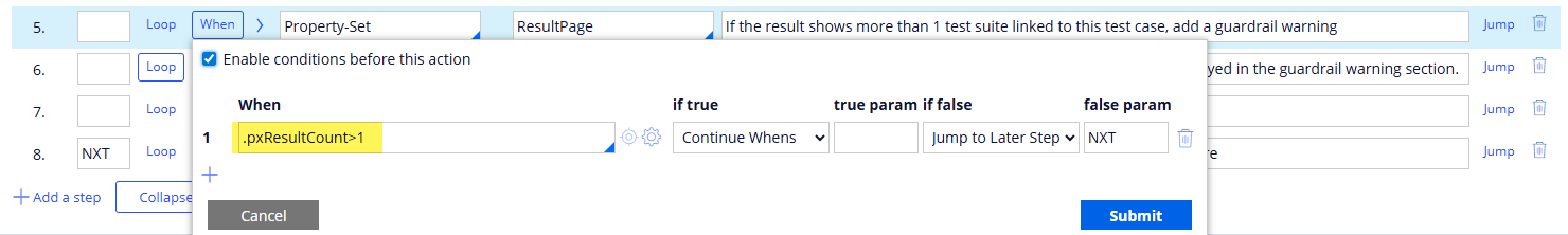

In Step 5, if the result count is greater than 1, then we're proceeding and throwing a new SEV1 warning. Else, skip to the end of activity.

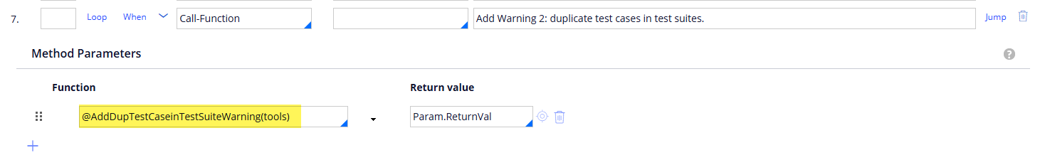

In Step 7, we are calling a Function to add the new SEV1 guardrail warning. We had to write this new function because the OOTB @pxAddGuardrailMessageWrapper Function rule wasn't taking a parameter.

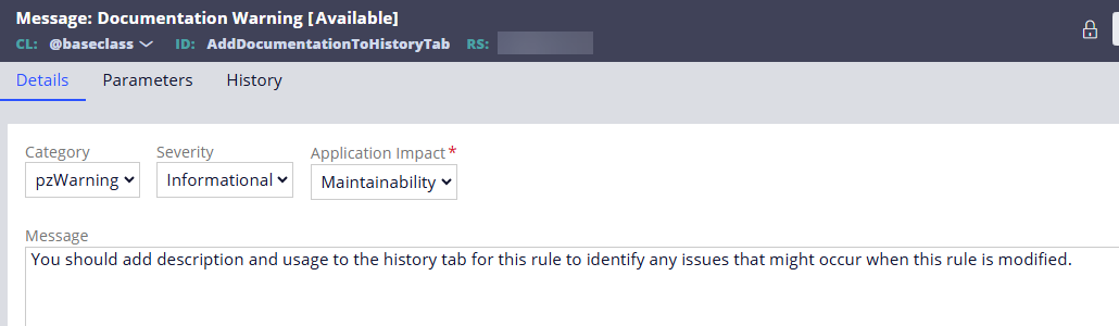

Here is the message rule.

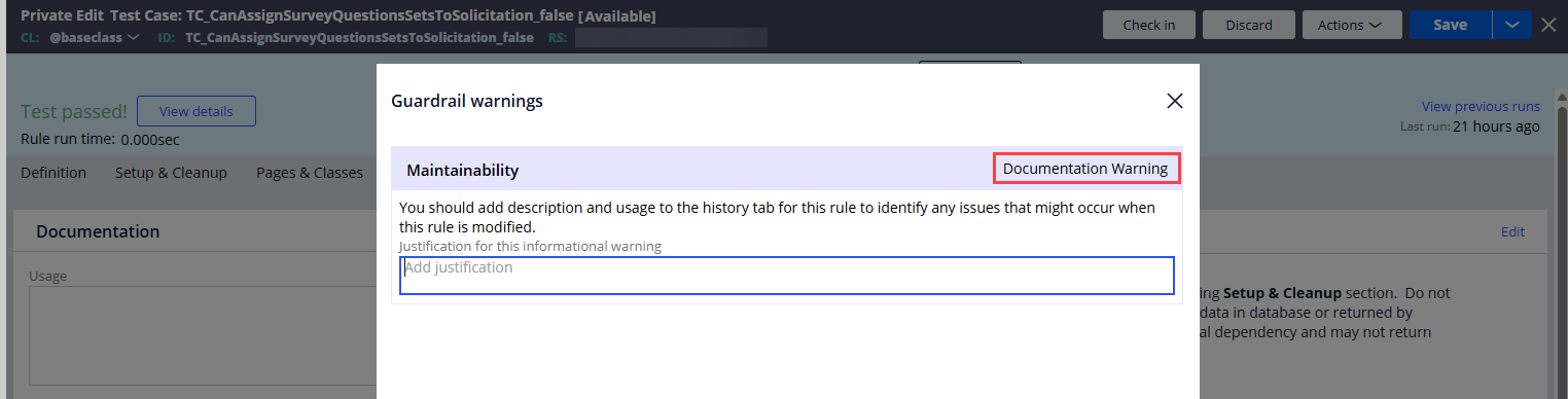

Test 1: Save a unit test case rule that is missing the Description & Usage documentation.
It throws the new custom SEV3 (Informational) guardrail warning.
