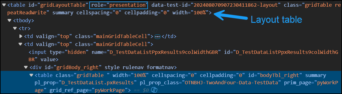

Given that non-optimized tables are a legacy component, they are structured using tables (HTML <table>) for layout. Typically, a single non-optimized table will introduce a 2-3 table tags in the DOM, to support resizable columns, pagination, and various other styles depending on the contents and available operations of the table. These additional tables do not represent actual data relationships and would otherwise interfere with assistive technology in providing meaningful feedback to the user. This markup structure also extends to tables in the Reporting module, which are structured similarly to standard non-optimized tables.
To address this, Pega adds the role="presentation" attribute to the layout tables generated as part of the markup of non-optimized tables. This attribute strips the <table> tag of its inherent semantics so that assistive technology does not interpret the element as another table. This ensures that layout tables are essentially ignored, and only the actual table housing the tabular data is recognized.
