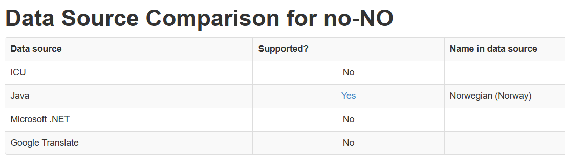

This is due to a mismatch between the Java Development Kit (JDK) version and the ICU library being used, specifically in handling Norwegian locales.
The issue arises because the JDK's default locale handling differs from ICU, and the no_NO locale was not consistently handled in earlier versions of the JDK.
The International Components for Unicode (ICU) library, which is often used by applications for localization, has specific rules for handling locales, especially for languages like Norwegian which have multiple dialects (Bokmål and Nynorsk).
Pega Platform determines the initial locale by first examining the browser's language settings. When Chrome is set to Norwegian, it sends locale codes that are not recognized, causing the calendar control's date formatting functions to fail.
Java 11 update causes regression as some undefined locales like no_NO are no longer supported by default, and an explicit locale has to be specified.
