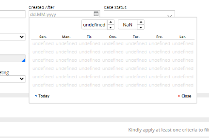

When using Arabic locale, date control properties display as "undefined" instead of displaying date values.

When Arabic locale is used, a date control is displayed as "undefined" instead of showing date values.
Users cannot select the date values.

4. Run the case and click the Calendar Icon.
5. Dates in the calendar display as "undefined".
6. You will not be able to select any value.

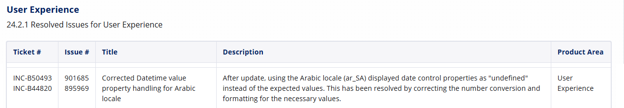

Root Cause
OOTB Date control is not working with Arabic text of dates for the Gregorian calendar.
Solution
This issue has been identified as a bug and has been fixed in the following available Patch Releases.
- Pega Infinity ’23.1.5
- Pega Infinity '24.1.3
- Pega Infinity '24.2.1
- Pega Infinity '25
