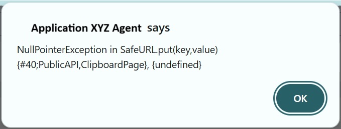

- Uses encounter exceptions on the pompt:
- ‘"NullPointerException in SafeURL.put(key,value)’
- Activity 'pzSendMessageWrapper' failed to execute; Java Exception: java.lang.IllegalArgumentException

What can cause an error like: "Problem invoking function: pega_rules_utilities.pzGetContext--(#40;PublicAPI,ClipboardPage#41;), A null or empty handle has been specified in the database "open by handle" method
