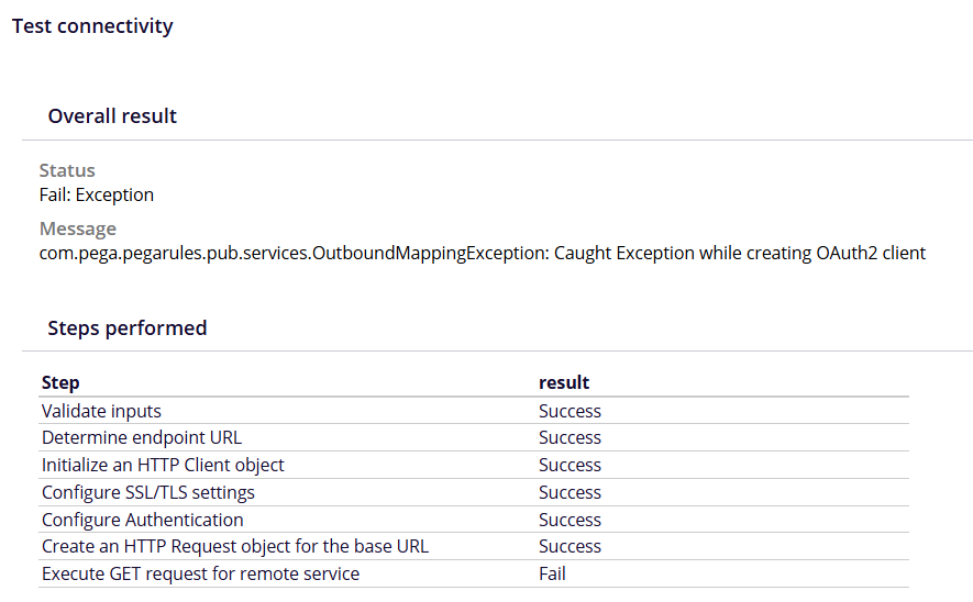

- While using OAuth2, there is a decryption failure, for example:
com.pega.pegarules.pub.services.OutboundMappingException: Caught Exception while creating OAuth2 clientCaused by: com.pega.pegarules.pub.PRRuntimeException: cryptography operation failed, mode:2Caused by: javax.crypto.BadPaddingException: Error closing stream

3. Run the data page with the required parameters and observe the error.
4. Open the connector for this data page.
5. Run test connectivity and observe the error.
