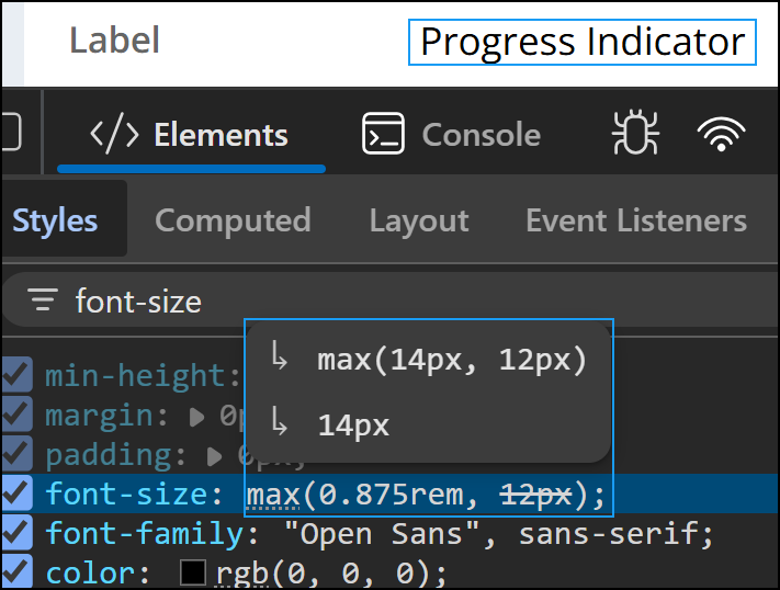

Combining these two techniques for font size allows text to not only scale responsively depending on the device size and settings, but also ensure that font size never goes below a specified minimum threshold for better readability and contrast with background colors. So in the example below, font-size is determined by the higher value between either 0.875rem, or 12px. Since the computed pixel size of the rem value is the larger of the two values, the end result is text with a font size of 14px.
