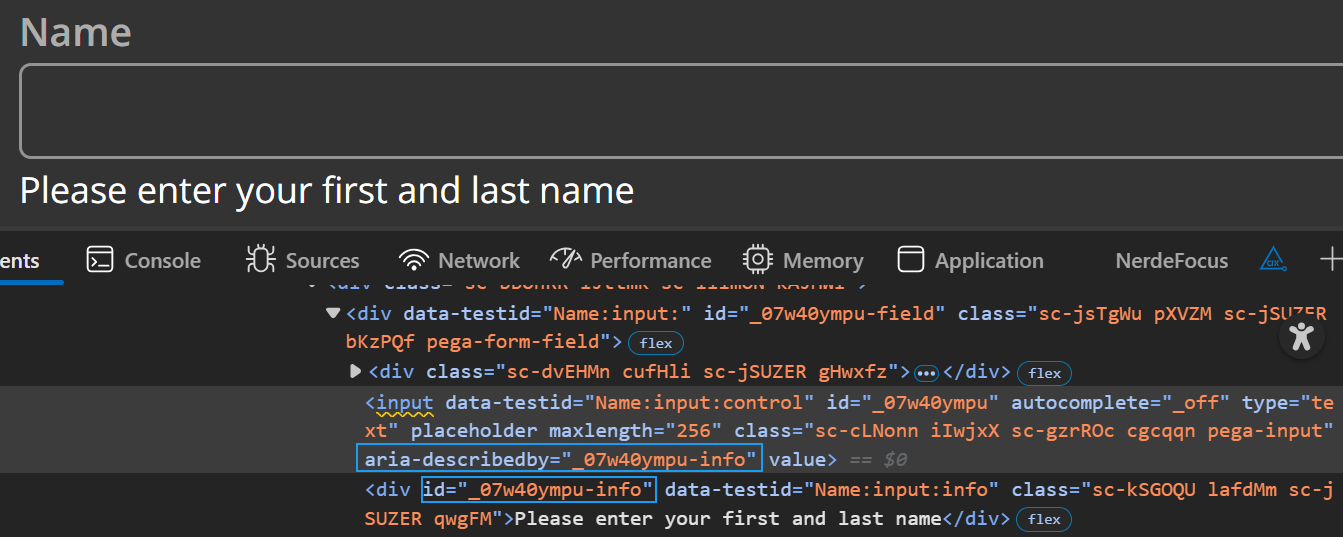

Form fields added to a view in authoring allow the configuration of inline helper text which will appear directly below the field. Platform will generate the aria-describedby attribute on the field in the generated runtime markup, providing not only a visible association but also a programmatic association to the helper text for assistive technologies.

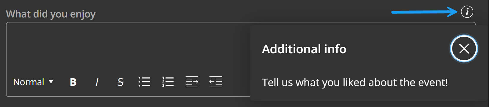

Should this limitation be a concern for your users, consider configuring Additional Info on the property itself as an alternative in authoring. This allows the addition of helper text through an associated help icon directly before the field.
The label of this icon references the label of the field it is configured on, ensuring that context is provided to users interacting with it.
