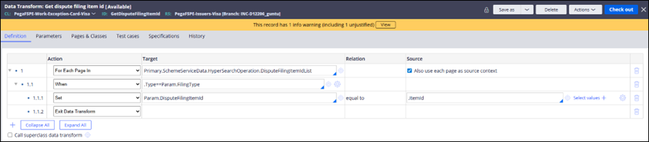

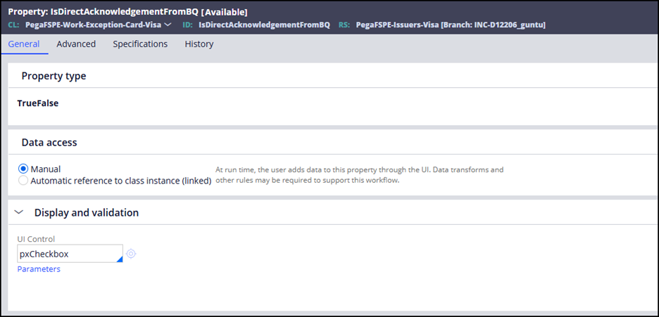

1)Create property, IsDirectAcknowledgementFromBQ (PegaFSPE-Work-Exception-Card-Visa)

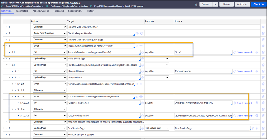

2)Create data transform, GetDisputeFilingItemId (PegaFSPE-Work-Exception-Card-Visa)

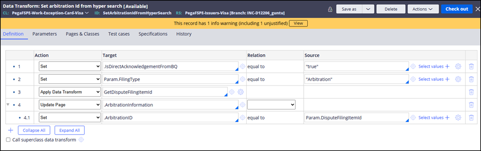

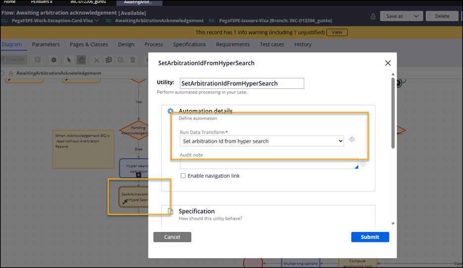

3)Create data transform, SetArbitrationIdFromHyperSearch (PegaFSPE-Work-Exception-Card-Visa)

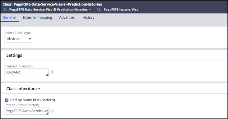

4)Create class, PegaFSPE-Data-Service-Visa-SI-PredictionHistories
Note - Not related to above issue (Internal dependency bug in Hyper Search Mapping)
Rules to be updated

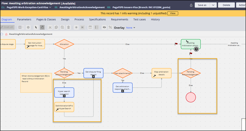

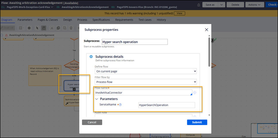

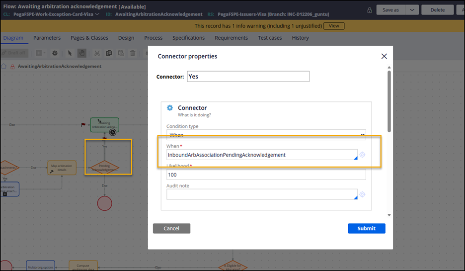

1)Update flow, AwaitingArbitrationAcknowledgement (PegaFSPE-Work-Exception-Card-Visa)
2)Update data transform, GetDisputeFilingDetailsOperationReq (PegaFSPE-Work-Exception-Card-Visa)

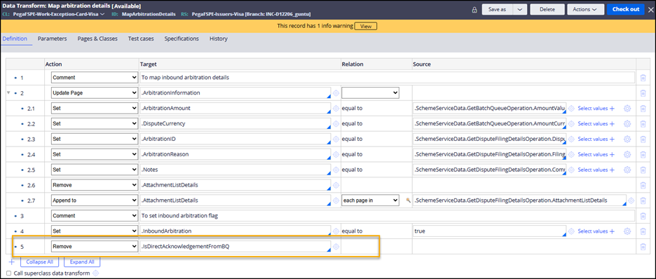

3)Update data transform, MapArbitrationDetails (PegaFSPE-Work-Exception-Card-Visa)
