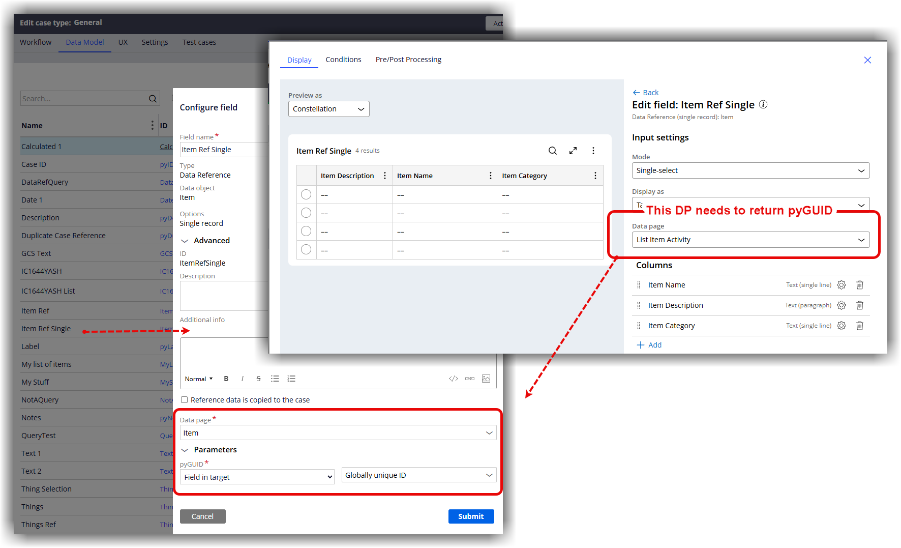

Data references rely on two data pages working together:
List Data Page - Returns the available selections displayed in the UI. This data page must expose the unique identifier value for each record.
Single Record Data Page - Configured on the data reference definition. This data page must be able to return exactly one record when provided with the unique identifier value from the selected row.
Data references rely on two data pages working together and require a unique identifier that can be used to locate and retrieve an individual record. This identifier does not need to be the Pega class key (for example, pzInsKey or pyGUID). It simply needs to be a value, or set of values, that uniquely identifies a record and can be passed from the list data page to the single-record data page.
Figure 1. Relationship between the List Data Page and Single Record Data Page used by a data reference.

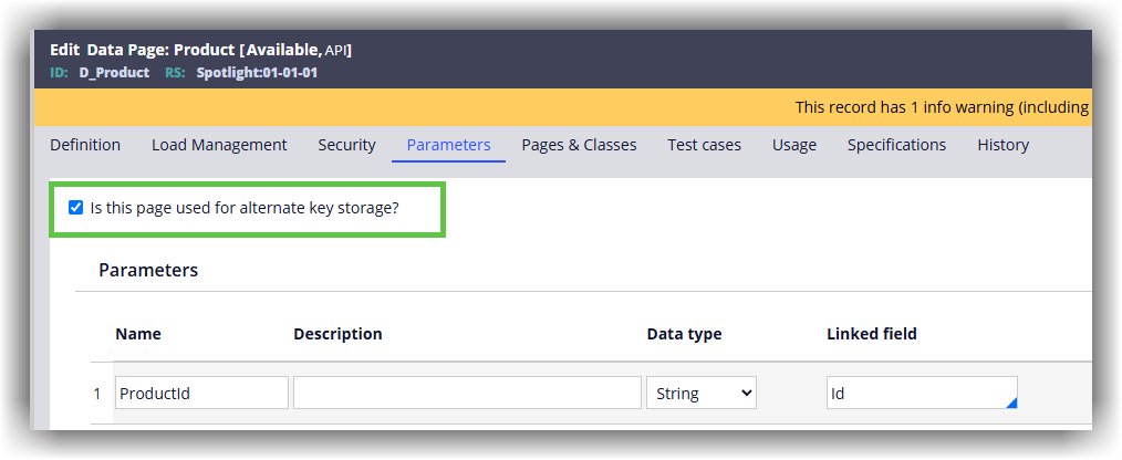

In instances where the source data does not use pyGUID, the single-record data page can be configured to use alternate keys by enabling "Is this page used for alternate key storage?" on the Parameters tab and mapping the field or fields that uniquely identify a record.
Although the platform supports composite keys in some scenarios, a single stable unique identifier is the recommended configuration and provides the most predictable behavior across Constellation controls.
Figure 2. Configuring alternate key storage on the Single Record Data Page.
In the above example, the data object is sourced from an external system that identifies records using ProductId rather than pyGUID. Alternate key storage is enabled on the Single Record Data Page, allowing the external ProductId value to be mapped to the data object's ID field. This enables the data reference to resolve and retrieve the correct record when a selection is made.
