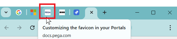

When launching the user Portal, users on Constellation releases after Pega Infinity release 24.1 find that the favicon works only on Dev and App Studio, not on the user Portal.
Symptoms can vary depending on the browser used:
In Google Chrome users can see the default Pega Icon.
